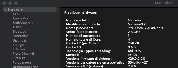

Is Firewire working correctly? Late 2012 Mac Mini, Ventura installation went perfectly but it does not recognize my Firewire audio device (Phonic Helix Board 12).
Macmini7,1 windowserver crashed around after running 20+ hours.
Was running OCLP 0.5.0 and installed Ventura a day before, crashed yesterday early morning.
Upgraded to OCLP 0.5.1, patched again, tested on USB boot then SSD EFI, and crashed today early morning.
Both crashes are from windowserver no response, and the Mac mini is freeze like a stone.
This Mac mini (16GB RAM, 512GB SSD, on Ethernet no Wifi, mainly as TM backup and file server with external RAID 1) has been serving me well for the past 8 years with no crash, so I don’t think it is hardware broken yet.
I stopped all the background tasks today (including iStats which I suspect), and will report how it goes.
Reboot, uninstall / reinstall iStat, re-inspect all the background tasks (and disable those old unused ones), run Amphetamine to ensure it does not sleep unexpectedly, and now it runs more than 29 hours without crash. 🤞🏻
Will report how it goes a few days later if it still keeps running.

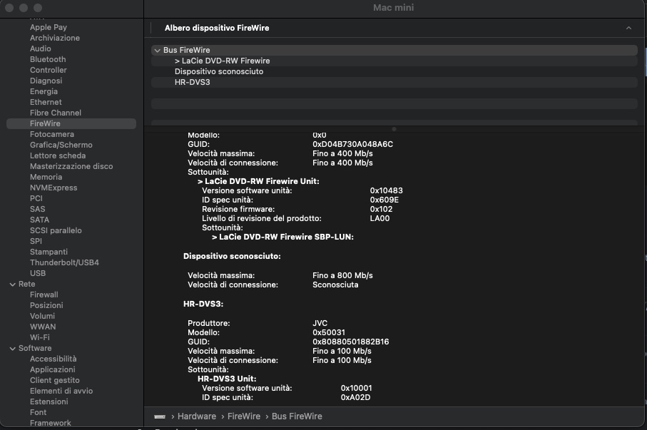

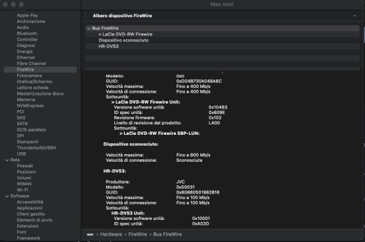

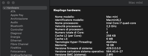

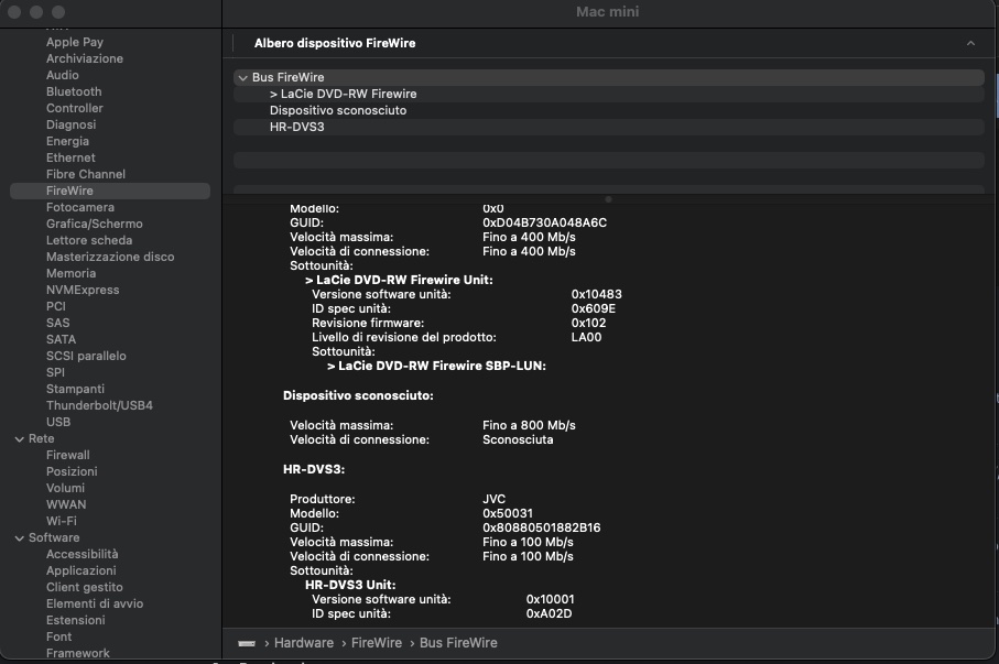

Yes, My firewire devices are connected to Mac mini by a Moshi Lynx device 4 usb2 ports and 2 firewire 800.
