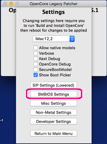

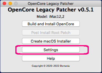

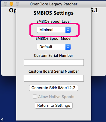

1 - Setting
2 - SMBIOS
3 - MINIMAL
4 - build
Reactions: pippox0 and veed24
