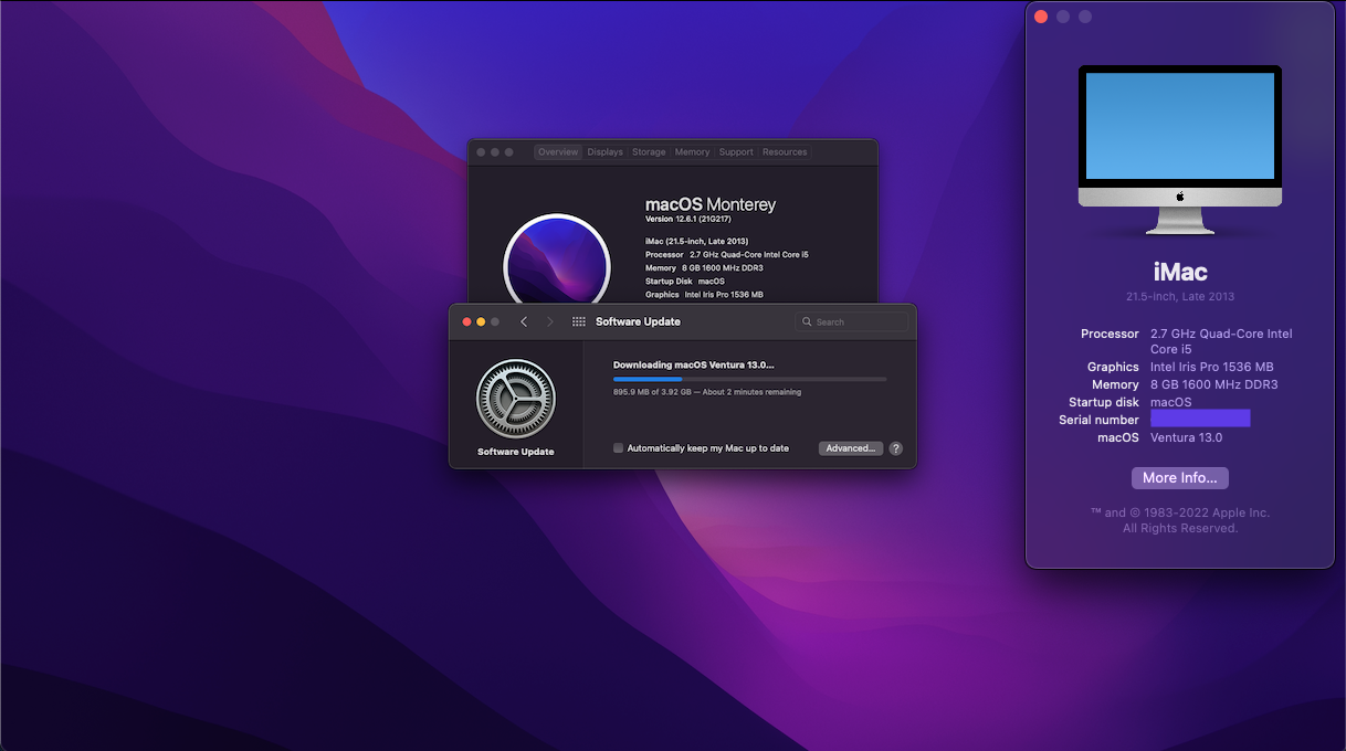

Hat off to OCLP developers. OTA updated my iMac 21.5 14,1 late 2013 Monterey 12.6.1 to Ventura with OCLP 0.5.1 without any issues, checked all functions are working as normal.
Again, thank you for your support...

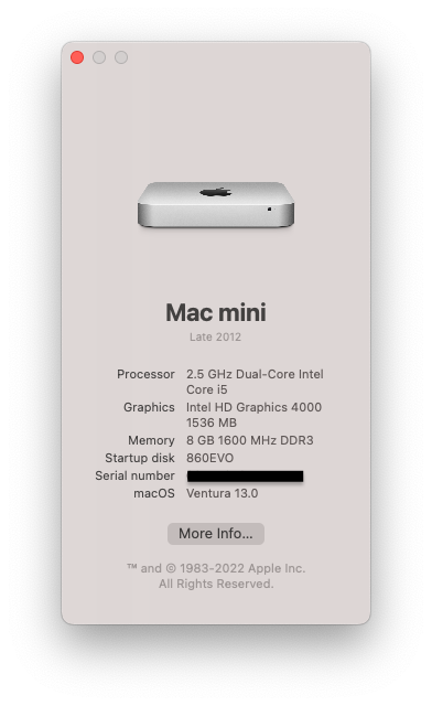

Ventura runs great on 2013 MacBookAir6,2. So I went ahead and installed it on 2012 Macmini6,1.
Arrgh, not so good on the mini (installed over OCLP Big Sur via USB stick).
1. It went nuts on ext. 1TB disk. Won't stay mounted, corrupted the APFS dir.
Basically, messing with ext. APFS disk(USB3.0). Still haven't figured out way around it. So time machine (ext. APFS disk) is OFF for now.
2. Hard crash after some hours. Others have reported same issue and it might be related to having 2nd disk (I have added 1TB SSD, apart from the factory 500GB HDD).
Could be related to sleep/wake, so have installed Amphetamine and set it ON indefinitely (I run mini as a server anyway). So far, not crashing anymore.
Have no idea if above issues are related to Ventura or OCLP. Will push on, as these are not dealbreakers.
Will see if new versions of Ventura or OCLP fix them.
Edit: might try a clean install(from scratch) at some point in future.

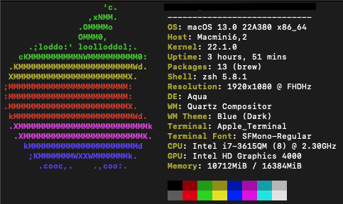

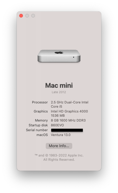

So far, so good on Mac mini 2012 for almost 4 hours.

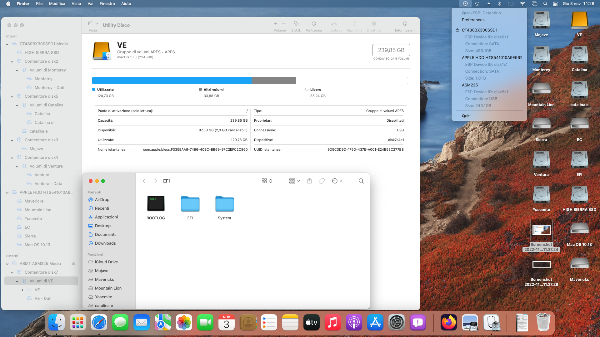

For Idenis and Veed i enclose a screenshoot from my external USB.

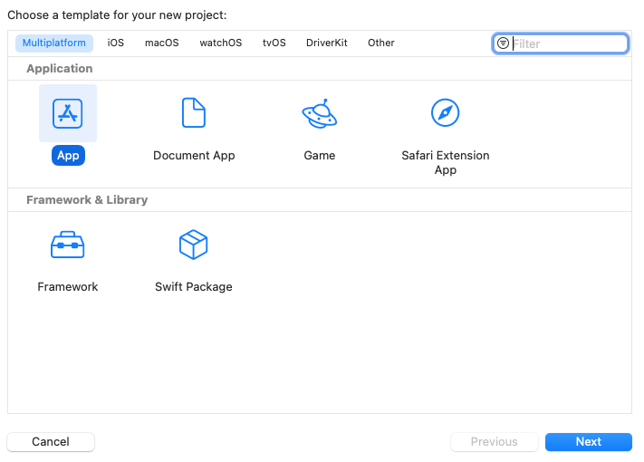

I downloaded the Xcode 14.1 release. This comes in an XIP file format and I double-clicked the XIP to extract the Xcode app. This took AGES to verify the XIP file and even longer to extract the file - abnormally long. As soon as the file was extracted the Xcode app appeared in the finder. Pretty much instantly my machine locked up hard. No pointer, no menu, no dock, and no alt-tab. 🤷🏻‍♀️ . I had to long press the power button to force a hard reboot.
This may have nothing to do with OCLP but I thought I should mention it. Other than that, everything has been flawless.

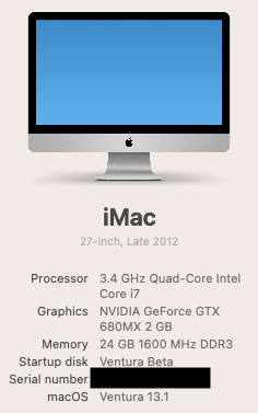

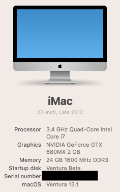

I have a twin to your iMac 13,2 (late 2012 27", 1TB Fusion HDD) running OS Ventura 13.1 beta1
and using OCLP 0.5.2n
I just downloaded Xcode 14,1 and, once downloaded, the whole process of verification, and full installation took about 9 minutes. I do not have any issues with launching the program nor entering data. It is possible that the file was somehow corrupted during download(?)
