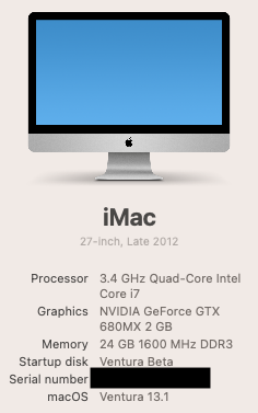

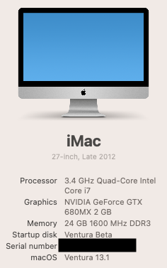

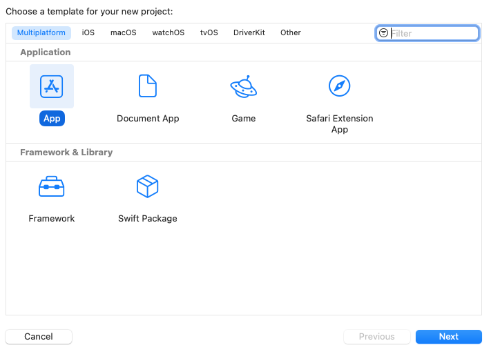

I have a twin to your iMac 13,2 (late 2012 27", 1TB Fusion HDD) running OS Ventura 13.1 beta1
and using OCLP 0.5.2n

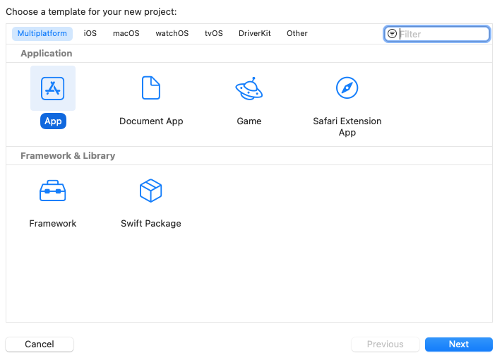

I just downloaded Xcode 14,1 and, once downloaded, the whole process of verification, and full installation took about 9 minutes. I do not have any issues with launching the program nor entering data. It is possible that the file was somehow corrupted during download(?)
View attachment 2107659View attachment 2107661
Thanks for this! I've had no issues building iOS or macOS apps via Xcode, so it's obviously just that particular install. The hard crash worried me a little, but everything has been stable ever since.

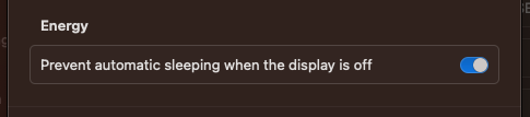

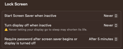

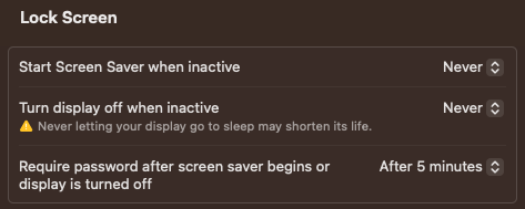

After reading arsTechnical review of macOS Ventura then I realized that I can kick out the beachball from the Systems Settings
Search "lock"
Search "sleep"
Reactions: Larsvonhier

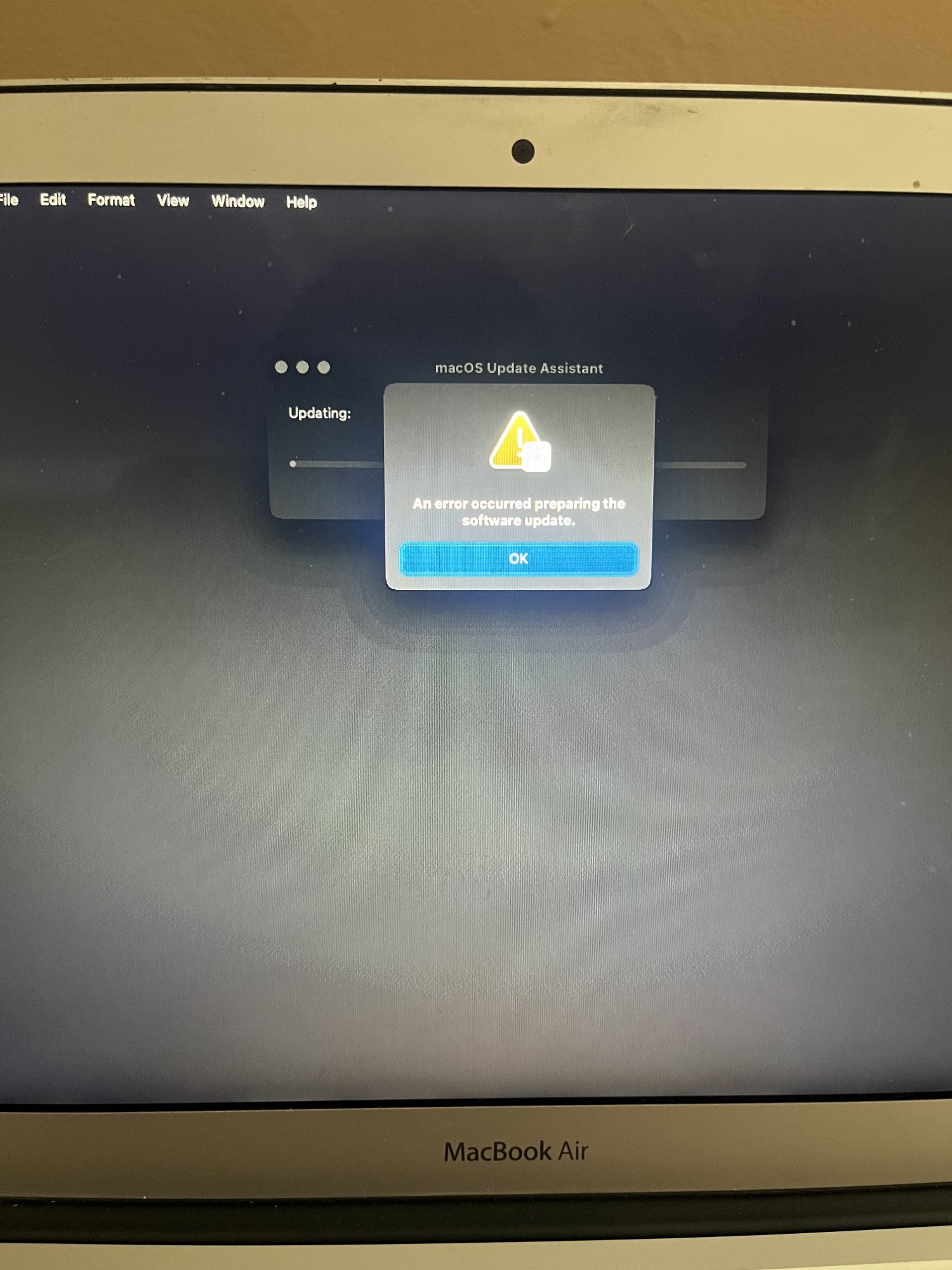

Since my Mac mini system volume is screwed and as advised by
@perez987 that I can clean install Ventura from scratch. There is no need to install Catalina. I took the plunge to install as follows:

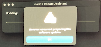

I encountered below error and bypass it by rebooting and resetting PRAM
Installation complete.
You got that error because you booted into the wrong EFI and/or partition. When you repotted you were lucky to reboot into the right EFI/Partition. Suggest is to hold down Option/Alt every time the system boots and then selecting the correct EFI (ON USB almost/kind of looking stick) AND then selecting MacOS Install or the Ventura-logoed-drive.
Search "lock"
Search "sleep"
Thanks for this, but unfortunately it doesn't help for me. I've had sleep completely disabled ever since Monterey, because for some reason, the SDCard reader on my Mini stops working after waking the machine from sleep.
Since I never found a true solution to that issue, my workaround has been to disable sleep entirely to keep the sdcard reader alive.

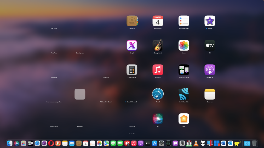

Part of icons in Launchpad got disappeared. Something with video card driver, I guess. Never seen anything like this on Monterey.

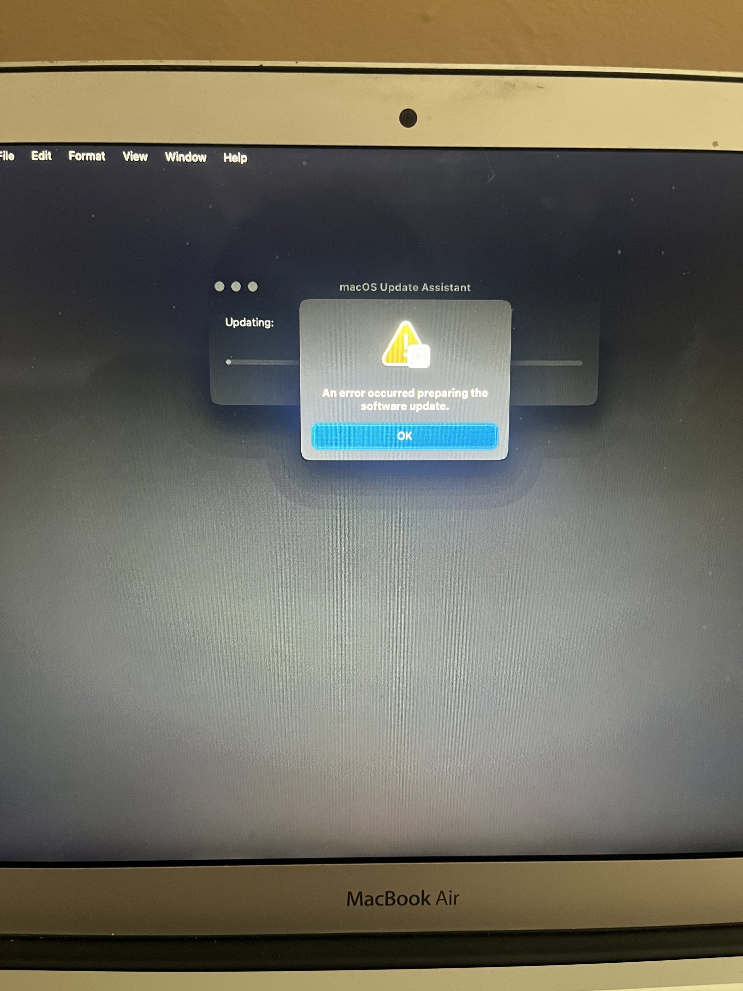

I’m on a MacBook Air (Mid-2012) with OCLP’s latest. I’ve tried everything I can think of to get around this. Nothing seems to work. Standard OCLP SMBIOS settings, custom, PRAM reset, reinstalled Catalina and updated firmware…
Nothing gets me around this stupid message.
Reload again. Go through the installation again. From the third or fourth time it should pass. Better yet, turn on WIFI in the installation error. Reload again.
Try again, from scratch if you must. Make sure you are offline to ensure a smooth, fresh install.
Read the post immediately above yours. I explain how to get around this problem. In short, restart, hold option/alt each time the computer restarts during the upgrade, and then pick the USB-Stick-looking thing with EFI on it, and then either "MacOS Install" or the drive with Ventura logo.
I have the same Imac except i5 and standard HHD and all the icons appear. 5.1/Ventura 13.1
