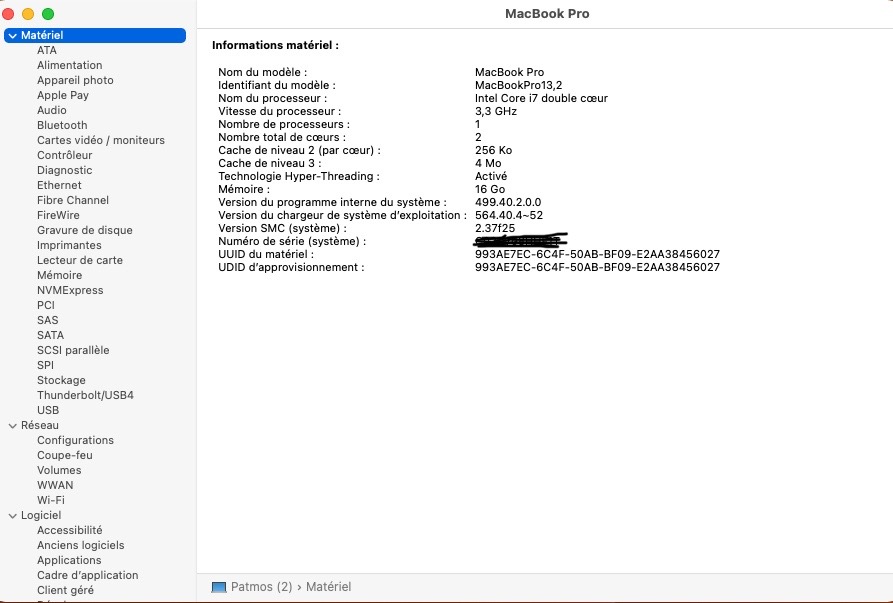

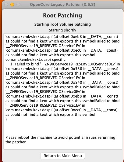

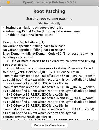

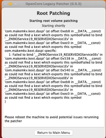

Can somebody help me please? I tried to install the new beta 4 update OTA on my MBP 13.2 (Intel Skylake) and i'm stuck in the booting process. Only the safe boot is working, and I cannot install the post patch. I receive a strange error concernant a com.makemkv.kext.daspi, and a patch failure code 31. Any idea?

Can somebody help me please? I tried to install the new beta 4 update OTA on my MBP 13.2 (Intel Skylake) and i'm stuck in the booting process. Only the save boot is working, and I cannot install the post patch. I receive a strange error concernant a com.makemkv.kext.daspi, and a patch failure code 31. Any idea?
Why using oclp 5.3 ? and not 5.2?
