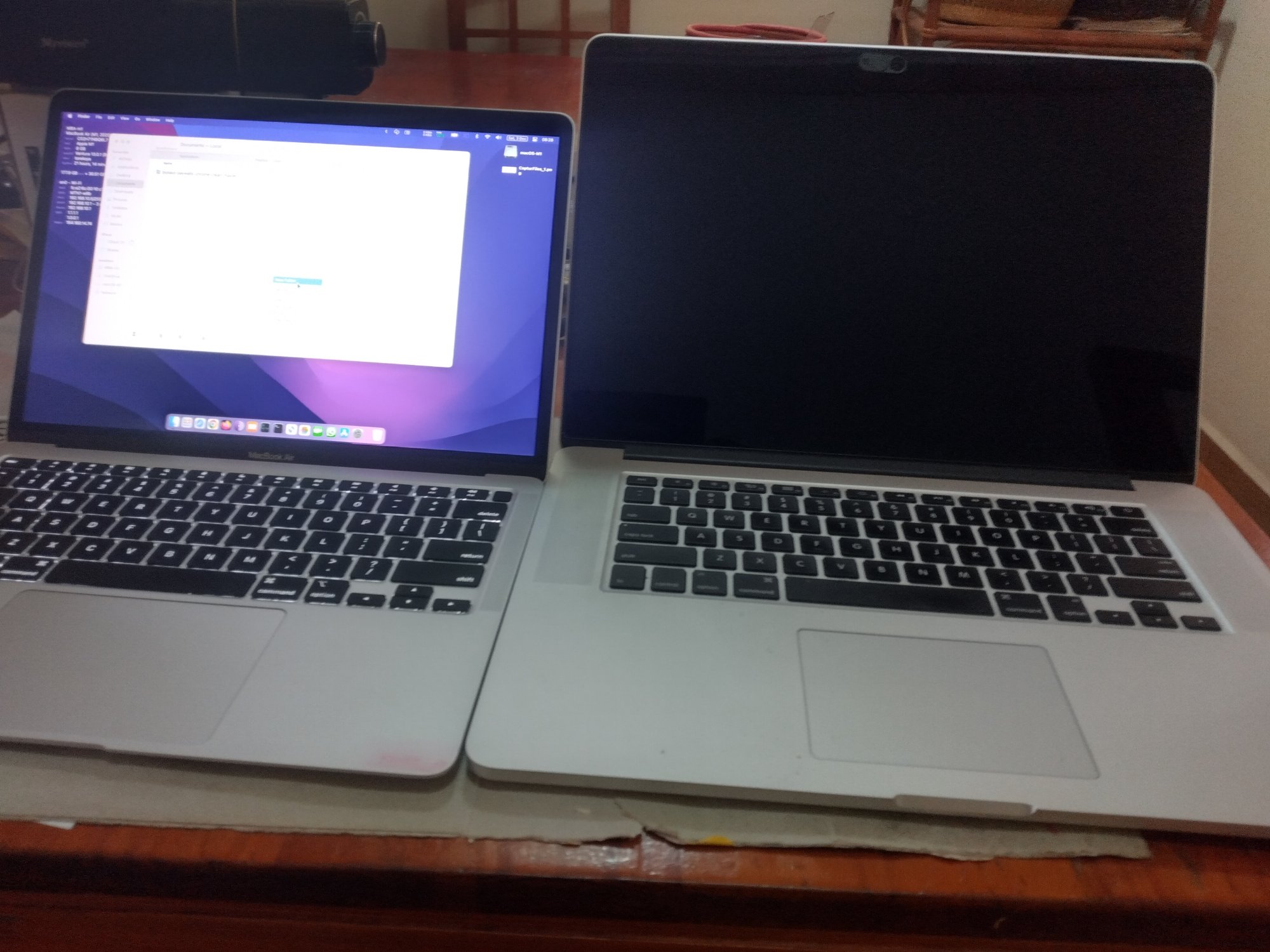

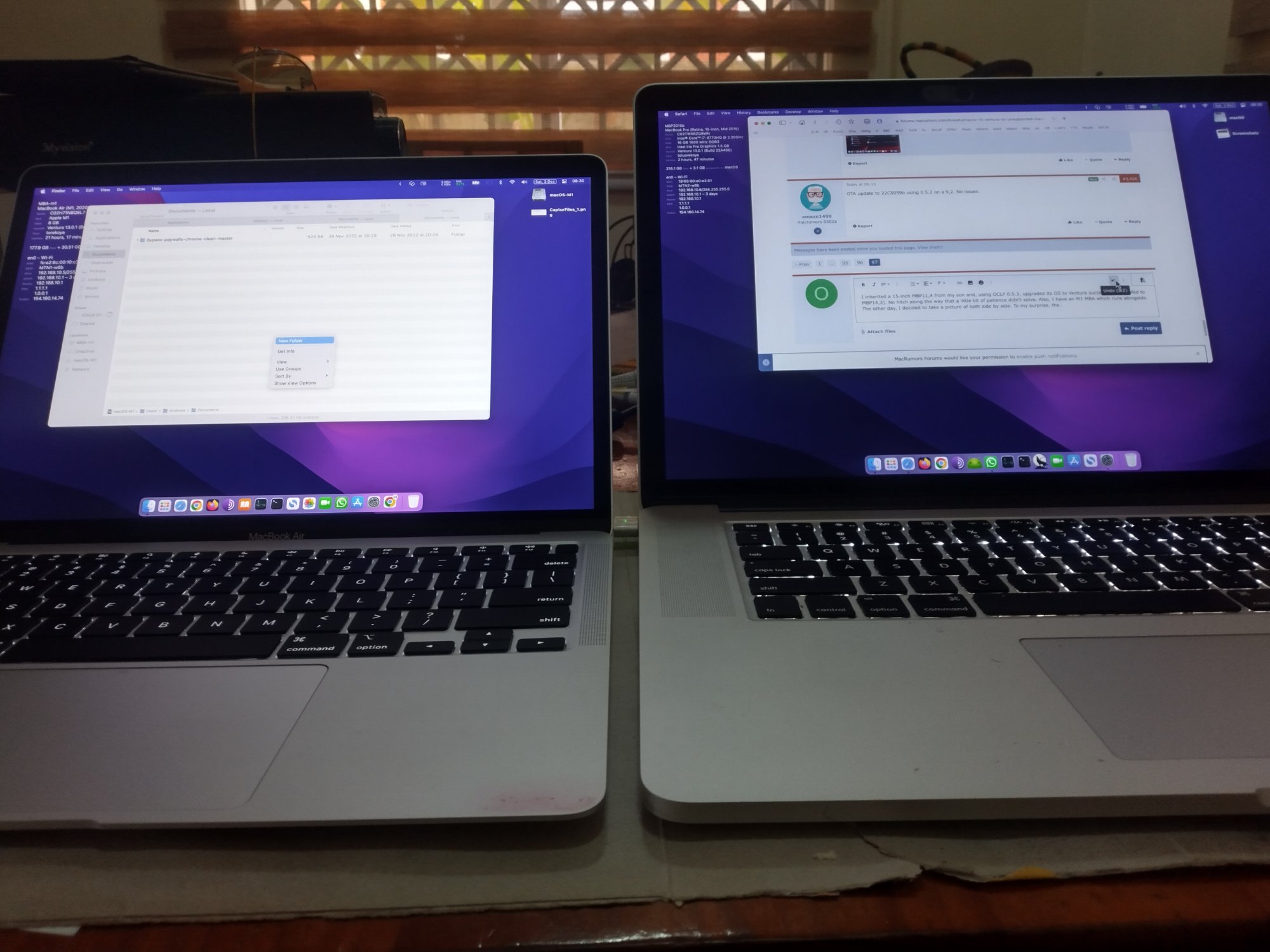

I got me a 15-inch MBP11,4 and, using OCLP 0.5.3, upgraded its OS to Ventura successfully (spoofed to MBP14,3). No hitch along the way that a little bit of patience didn't solve. Also, I have an M1 MBA which runs alongside. The other day, I decided to take a picture of both side by side. To my surprise, the screen of the MBP (on the right) went off. Separation by 9mm (0.354-inch) reversed the black screen. I can't figure out why (I should, but at 77...). Can anyone tell me what is causing the phenomenon? I am putting it out here, because I wanted to report success upgrading the OS of the black-listed MBP11,4 to Ventura (how is blacklisting achieved, BTW?). Kudos to the OCLP developers.
Reactions: fernando.c.neves
Pr
probably the magnets in the other laptop making it think the lid is closed. I’ve done this before in a lecture hall 🙈

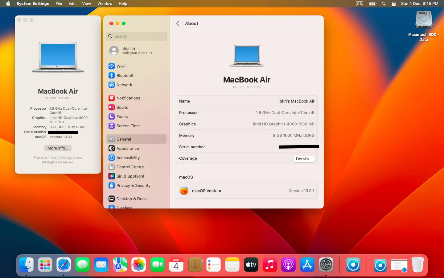

Yes, I confirm only problem calendar widget also on MacBook Pro 2012 9,2 and on another widget (time of use…I'm sorry for a possible inaccurate translation)… instead on iMac 2011 with updated metal card everything is ok
Yes, Screen Time widget doesn't show time next to apps icons, just blank space

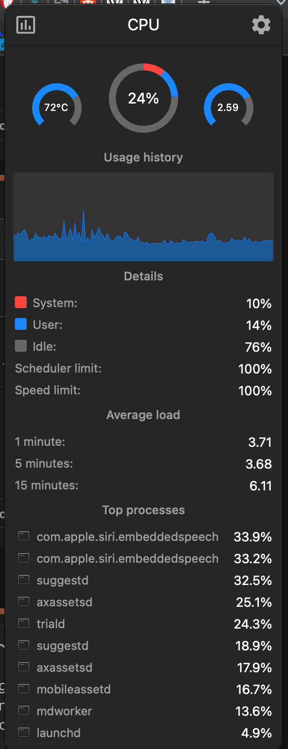

Just upgraded late 2013 MBP Retina 15" to Ventura 13.0.1 via OCLP, no issues during upgrade, and some annoying bugs of Monterey are gone. Great job, developers, very impressive!
However, for some reason I can see com.apple.siri.embeddedspeech and suggestd running amok, eating 30%+ CPU each on both accounts even though Siri is disabled! This makes MBP constantly hot (which was not the case prior Ventura), needless to say I don't like seeing baseline CPU load about 3-5%.
Very few results on google to make sense of what's happening, anyone experienced it?

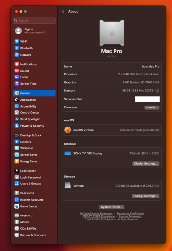

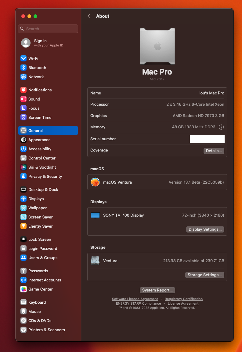

Thanks to khronokernel and Team this cMP 5,1 is running awesome!
All I need now is legacy wifi and I'll make the switch!!!
Note: I would switch now but I don't have either-net throughout my place and I don't want cat-5 wires running to 5 computers..
Reactions: chris1111

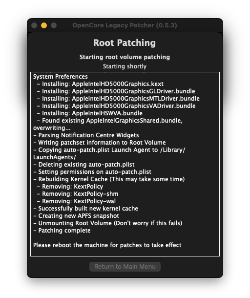

My eternal gratitude to the devs!!! The installation experience was not smooth, but I managed to install Ventura on a macbook air 5.2 (mid 2012)!
The process:
I downloaded the OCLP v0.5.2.
I chose to download the macOS from the OCPL menu (Create macOS Installer -> Download macOS Installer -> macOS 13.0.1 (22A400) - 12.2GB). After the download finished I got the error : "No Installers found in Application folder". I am not confident with macOS disk internals, so I did not manage to find where the downloaded file went, to see what is wrong...
So I manually downloaded the macOS from this link (mrmacintosh.com/macos-ventura-13-full-installer-database-download-directly-from-apple). When the download finished, I moved the ventura installation app file from "InstallAssistant.pkg" into Application folder.
I erased the usb flash drive with disk utility, using format APFS and Scheme GUID partition map. Then I tried to flash the ventura installer into the usb flash drive using OCLP. After about 5 minutes I got the error "The bless of the installer disk failed.". So after a bit of googling I decided to flash the usb via terminal.
The flashing via terminal was successful and I used the OCPL's top menu option "Install OpenCore to disk". I chose the destination to be the efi of the usd flash drive but I got permission error 1. I googled a bit and I found how to give permission to OCPL to access drives (apple icon menu -> System settings -> Privacy and Setting (iirmc)). After giving permission the installation to efi was successful.
I booted from usb, deleted the sdd with the old ventura OS and I made a clean ventura install. At some point I got the error : "an error occurred preparing the software update". Clueless I chose to select a start disk, there was none to select. I rebooted and I found a white page showing the charging icon (no os found I guess...).
I started again the clean install (deleting again the ssd) and eventually I got the same error. I rebooted but while pressing the option button, I chose again the usb efi to boot. I had lost any hope but eventually after many automatic reboots the new Ventura showed up!!!
Soon I realised that I cannot boot without the usb stick. So I downloaded the OCPL again (clean install I had to) and I used the "Install OpenCore to disk" choosing ssd efi this time. It asked for reboot, I did it, then I removed the usb drive and I reboot again to confirm... and yes it booted without usb. I open OCPL again I check the post install root and I saw I had to apply a patch. I did it and rebooted. Now everything seems to working great!
Thanks again!!!!

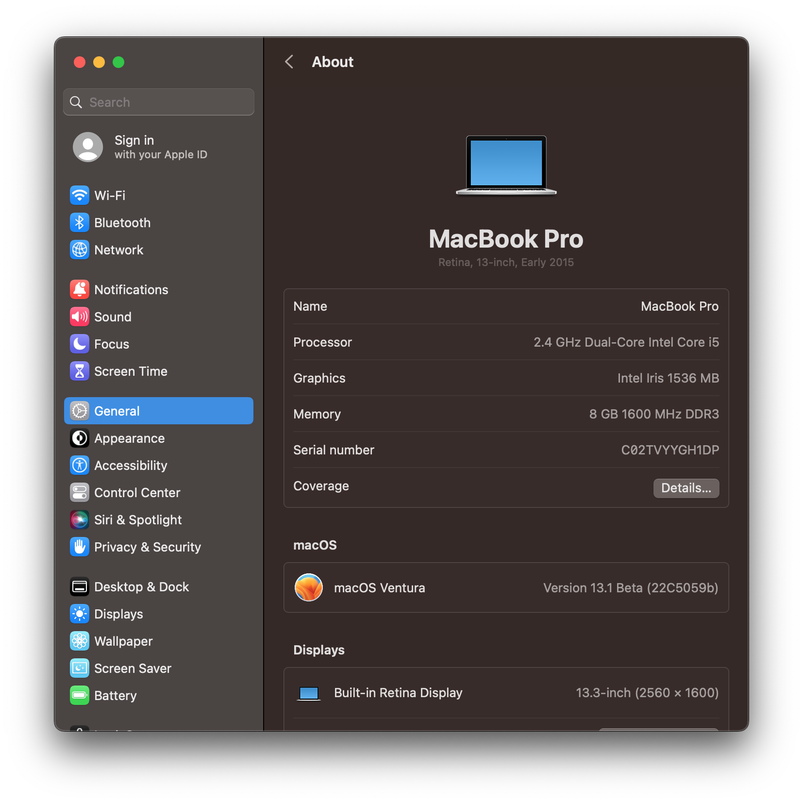

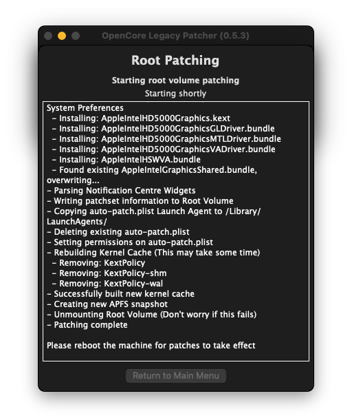

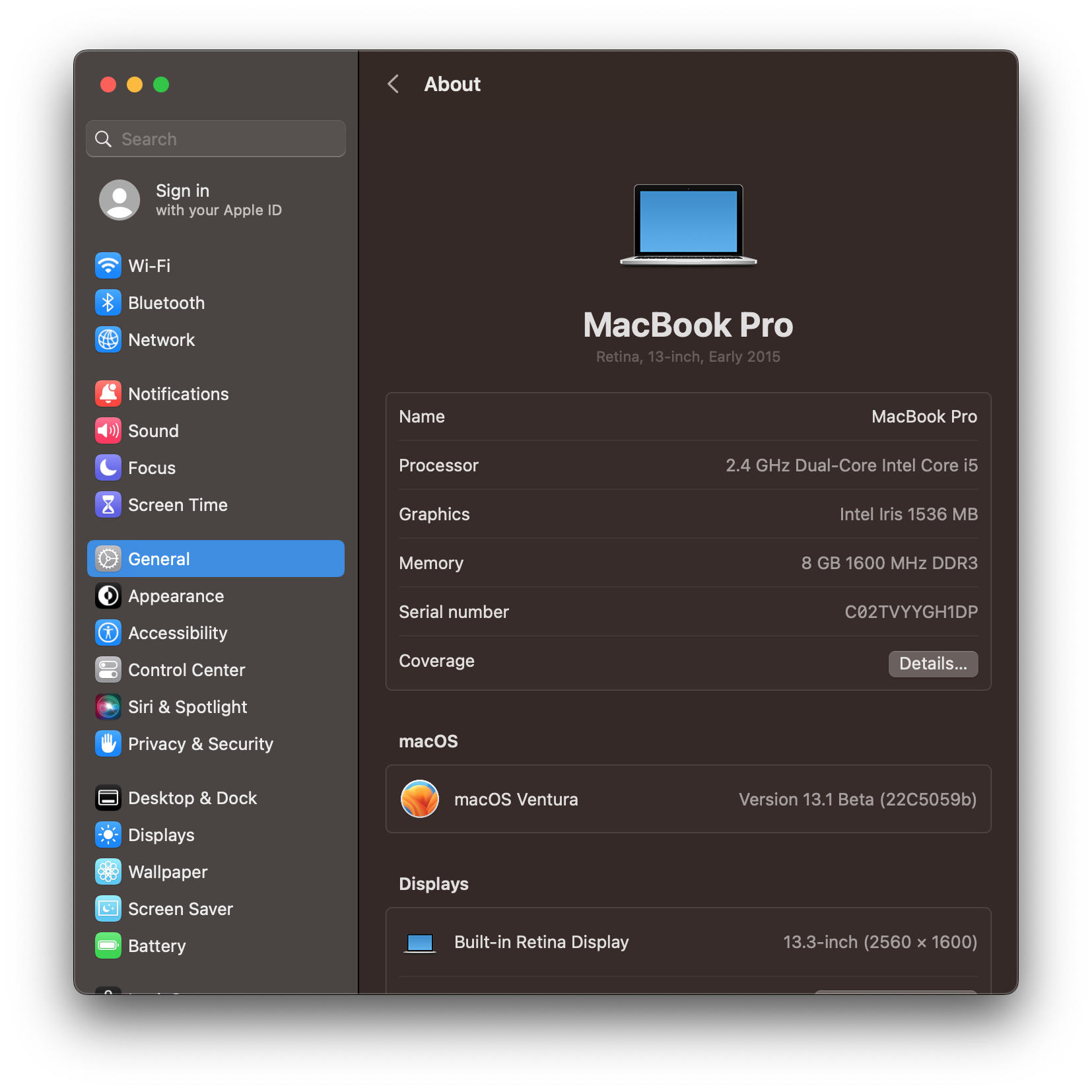

Fresh install OCLP 0.5.3 build from source.
Re-Patch of OCLP 0.5.3 and new EFI.
Notable change in speed of Ventura 13.1 Beta 4 (22C5059b) with OCLP 0.5.3 build from source.
Now my Real Mac (MacBookPro12,1) MacBook Pro Retina 13'' Early 2015 is notable faster then before. With Safari and Chrome Canary, Youtube with 1440 Resolution and 2160 (30fps) is smooth Full and windowed mode. Is faster then Monterey I guess too.
For those who doesn't know how to build from source => OpenCore-Patcher 0.5.3 build from source.app.zip
After change your EFI and Re-Patch with OCLP 0.5.3, please share if your Real Mac became faster than before with Ventura 13.1 Beta 4 (22C5059b).
