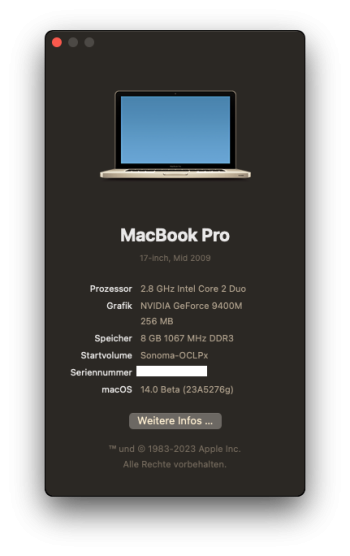

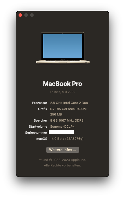

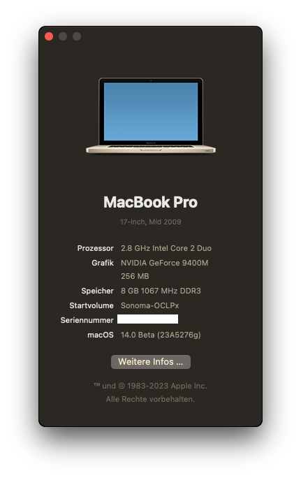

Installed Sonoma Beta2 on MacBook Pro 5,2 Mid 2009 17", EVO 860 SSD. It resides on its own volume (not partition).
Downloaded Sonoma Beta2 OTC (I have Apple developer account and I am enrolled in Apple Developer Beta program)
Installation went without major problems; took several installer-triggered reboots to finally arrive at the desktop.
MacBook Pro 5,2 requires external keyboard and mouse to be attached to the computer via a USB hub (USB hub is then plugged into USB port on the computer) in order to allow cursor movement and password entry. I installed latest OCLP 0.6.8n patches (I know it does not fully support Sonoma), and rebooted. There is no GPU acceleration, no WIFI, and no Bluetooth, but Ethernet port works fine, and CPU is "usable" for simpler tasks. Keyboard and track-pad are also fully functional. This report is posted from this Mac via Firefox; Safari has page rendition problems.
Hope this "data point" may be of help.
View attachment 2221758View attachment 2221759

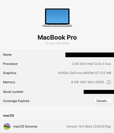

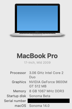

Successfully installed Sonoma 14.0b2 on a very similar MBP5,2.
This time made a clean install using standard methodology. Using OCLP 0.6.7 release for EFI and root patches.
- erased the macOS partition on an external SSD
- installed 14.0b2 to it from a USB installer (InstallAssistant.pkg downloaded via MrMacintosh)
- with Migration Assistant imported all data from a Ventura 13.4.1 drive
- applied post-install root patches.
Result is equivalent to what RogueB obtained:
Writing from Firefox as Safari has rendering problems with the patch set (which is not made for Sonoma).
No WLAN but cabled Ethernet working fine.
No graphics acceleration, but usable system.
Need USB hub connected keyboard and mouse while running the installer and in Sonoma before applying root patches.
Very good result in this early Sonoma beta stage. Thanks to all developers and early testers!

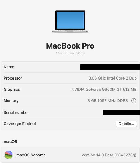

[I did the clean install because my usual method (using CCC to update user data on the target SSD, then install over it) has failed his time with OTA installation as well as with USB installer - installation made volumes named "macOS - Data - Data - Data"... with an extra Data after each failed attempt. Could be CCC (which isn't Sonoma-ready yet) or the unorthodox method reaches its limits now.]
