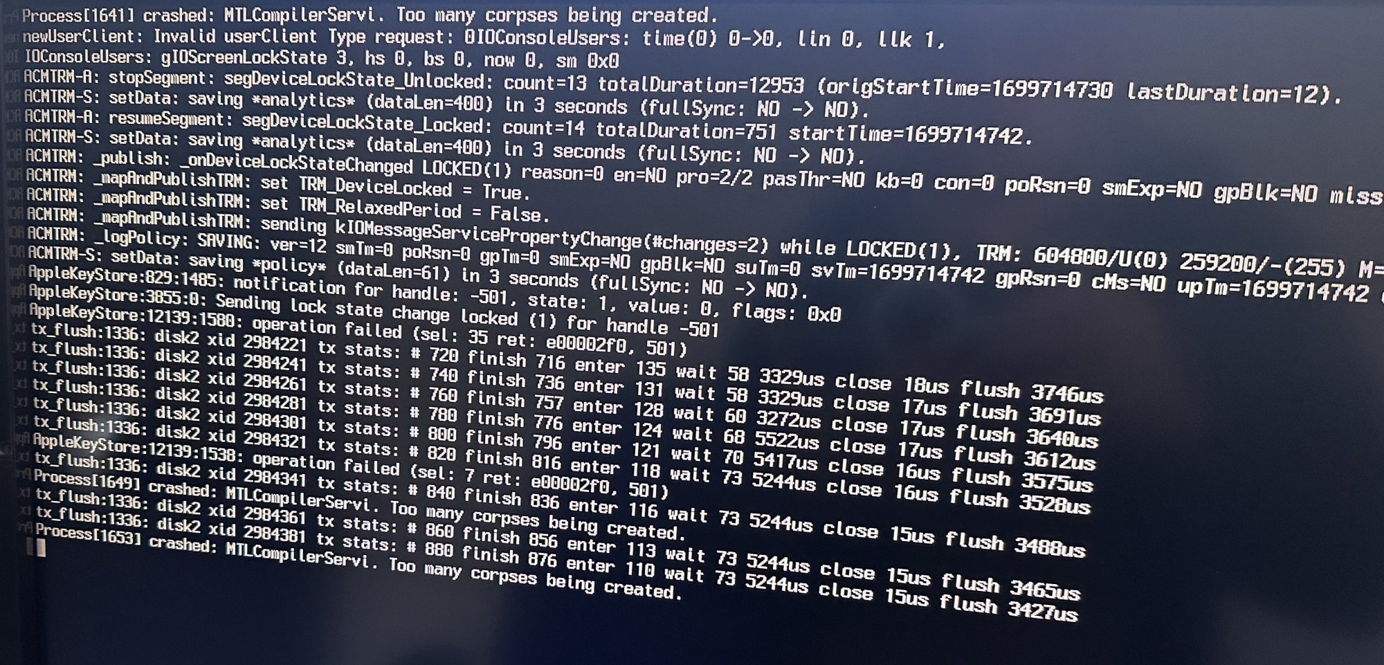

I updated to 14.2b2 and ran into the login loop. My OCLP version is 1.2.1. I tried to fix it, but had to resort to a full backup from migration assistant. Now I'm running 1.2.1 on 14.1 (23B74). I thought I was the only one with this login loop issue, but just a word of caution, I guess it's real.
Why migration assistant? Full usb installer 14,2 b1 over the broken volume and everything is back.
I used a usb installer to re-install 14.1. But of course when trying to re-image via a time machine backup, that doesn't work from recovery and you must install and boot into macOS to get to your time machine backup, using migration assistant.
For those that have the login loop, You will be logged off when you quit the Windowserver process in Activity
Monitor.
Thus, you get a login loop when WindowServer crashes upon login.
Here's the output of the loop on my 2012 Mac Mini:
