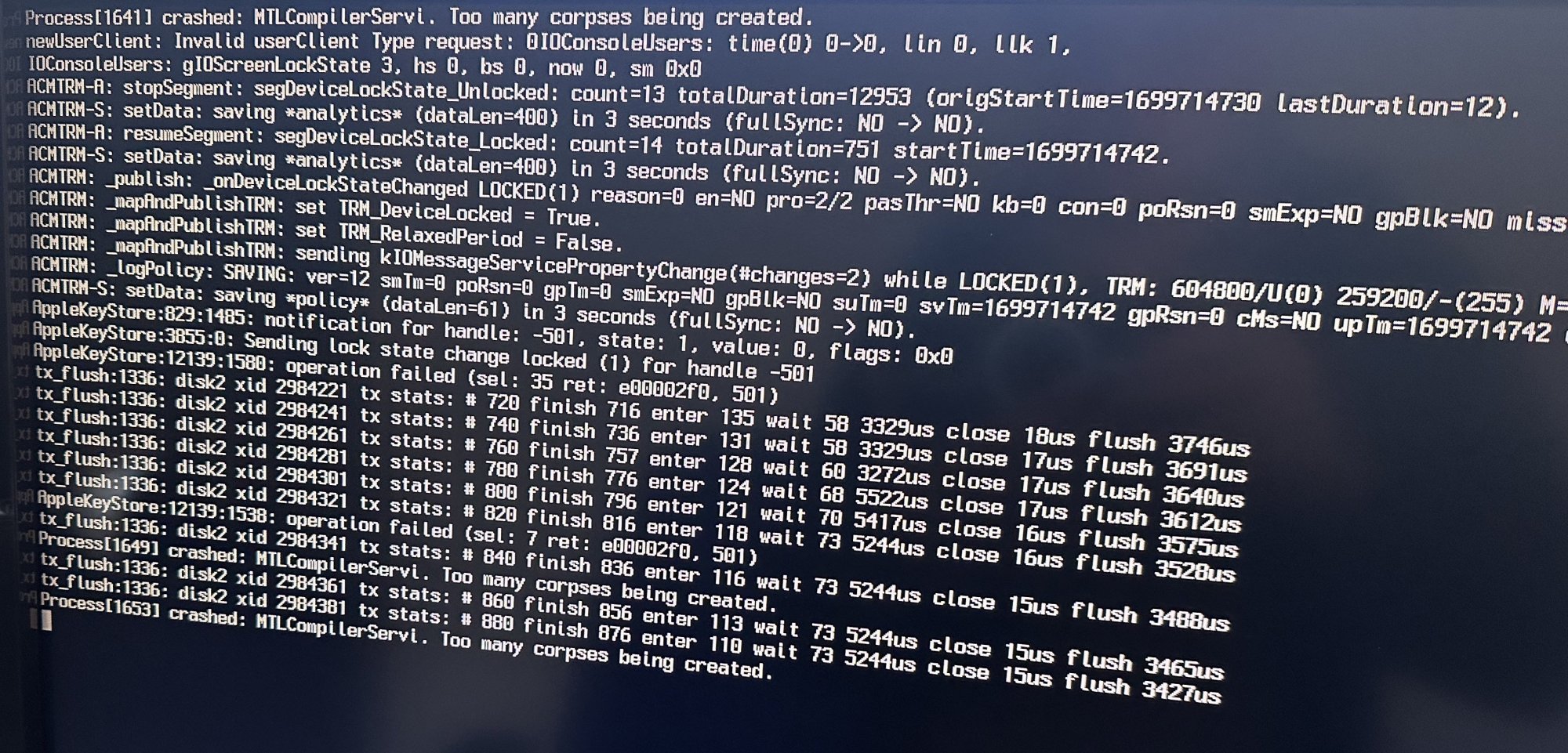

Noticed macOS 14.2b(23C5041e) boot-loops (WindowServer and MTLCompilerService crashes) on Metal Macs and not so on non-Metal Macs with OCLP v.1.2.1. Suspect LaunchServices may be the source of this issue? Hopefully this observation doesn't get me booted from Discord, yet again. ;)
Another data point; no such boot-loop issues on either my native supported MBA or the very old (2014) iMac 15,1. Both metal capable.
Reactions: K two
Concur on the supported Mac, Mini8,1 is OK here but on Haswell Mac Mini7,1 it crashes every time. Observed on this thread non-Metals seem immune. 🤷‍♂️
Reactions: cab_007
I took nightly OCLP this am and while unpatched 14.1b2 booted up ok, upon patching with OCLP (post root install), I got the boot loop with what is reported above. Now trying to revert back.

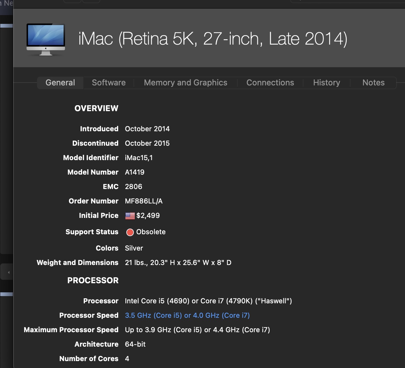

Can you clarify regarding your comment on the "non-Metals seem immune"? Also regarding the "Haswell" involvement?
If I am not mistaken, my iMac 15,1 has a Haswell chip, and it didn't have the boot-loop issue.

Noticed that more non-Metal Macs were not having issues with the lastest updates both MacOS and OCLP, yet more than a few with Metal Macs trying the second Beta of 14.2 (23C5041e) were seeing the same issues whether OTA or USB installed. Actually, to me it appears there is a problem with Metal patches (I can only test Haswell) and Launch Services since the MTLCompilerService (too many corpses) and the WindowServer are directly involved. Also, a clean install with an OCLP-made USB, ethernet-connected over a FiberOptic network yielded the same issue. Is AMD Radeon R9 a Haswell?? 🤔 Hmm?
Apparently yes. See the screenshot attached, from MacTracker, my iMac is the i5 model.
