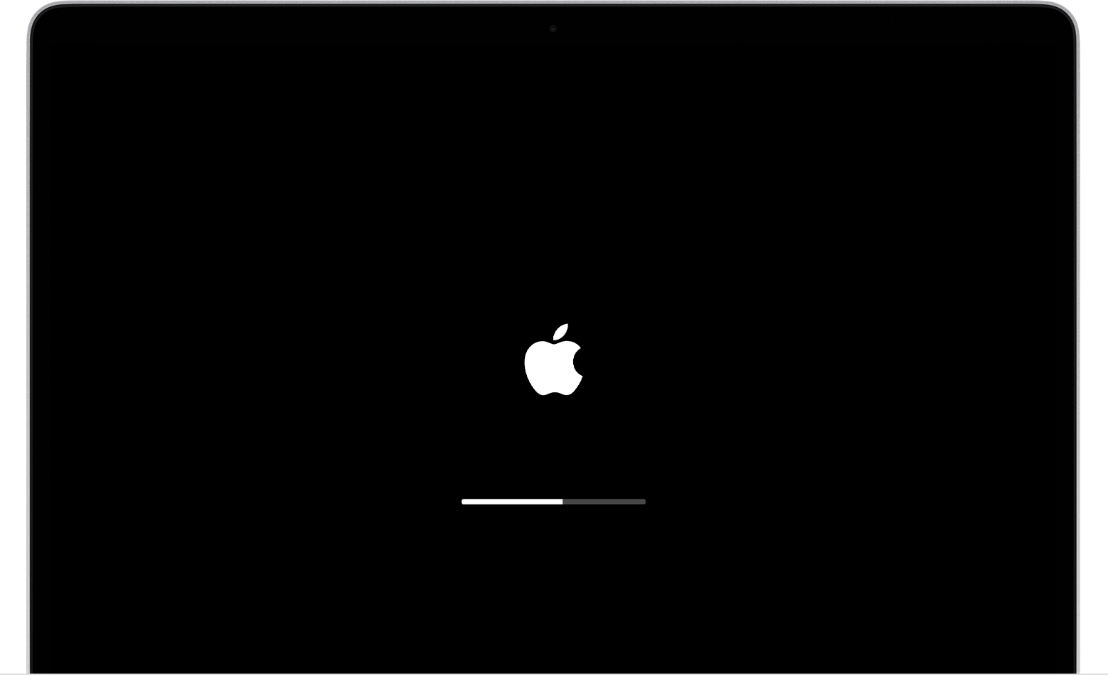

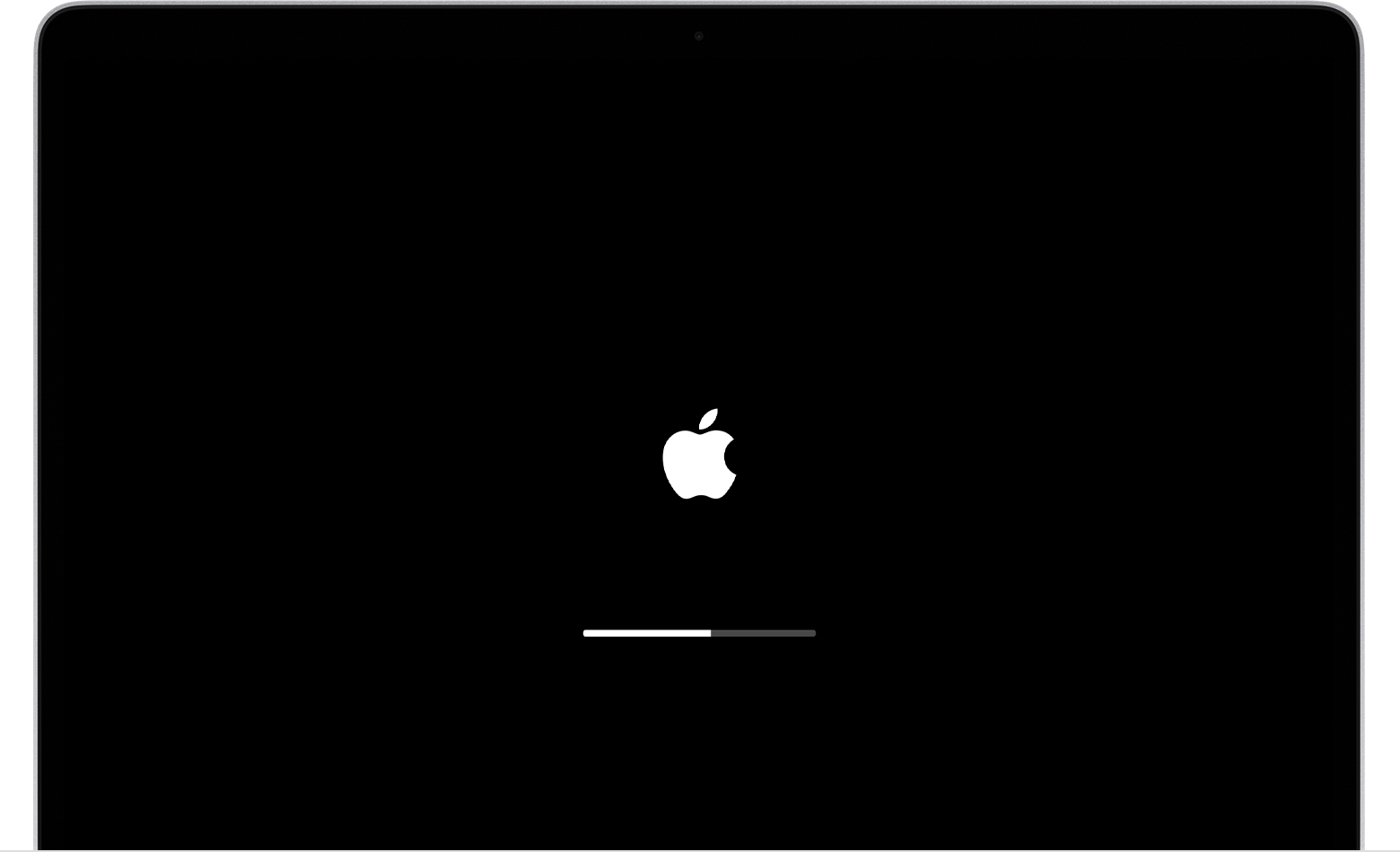

Hi,
I try to install Sonoma 14.1.1 on my Mac mini 7.1 with a bootstick and OCLP 1.2.0.
This is the result, the screen freezes:
Any ideas ? :/

I have a couple of ideas for you but some of it depends on what step you're in for the install.
If you're just installing for the first pass, try resetting your NVRAM. If it's an intel machine, it will be
Turn it all the way off, hold down Option-Command-P-R until you hear startup sound a second time and then release.
Please note that this requires a wired keyboard (not a bluetooth keyboard) to accomplish this. It needs to be plugged into the Mac Mini via usb.
Reactions: K two and mat316
Is this possible with a windows keyboard?
I'd do safe mode install after you've tried once the NVRAM has been reset. There's a defined blessed boot in the NVRAM so once you reset and boot up from the USB install stick it will reset the EFI bless boot.
If that doesn't work then try this:
boot up as usual except into safe mode or recovery mode, click on the top to open utilities and terminal
Look on the list from ‘diskutil list’ to find the disk listing with the ventura and find the number corresponding to the EFI listing (typically like 1 or 2) and note which disk it is under (e.g. disk1 or disk2, etc.)
1) type the following in the terminal window replacing ‘X’ and ’N’ with the above disk and EFI numbers (e.g disk1s1). Hit return after typing the following command and there would be a response ‘Volume EFI on disk1s1 mounted’
diskutil mount diskXsN
2) now type the ‘bless’ command to make this the default option for startup. This will not produce any output.
bless --mount /Volumes/EFI --setBoot --file /Volumes/EFI/System/Library/CoreServices/boot.efi
Now restart from scratch and the NVRAM has the 'blessed' EFI boot listing so it should find your boot up stick.

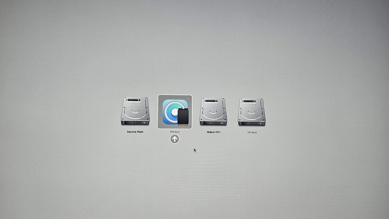

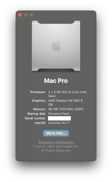

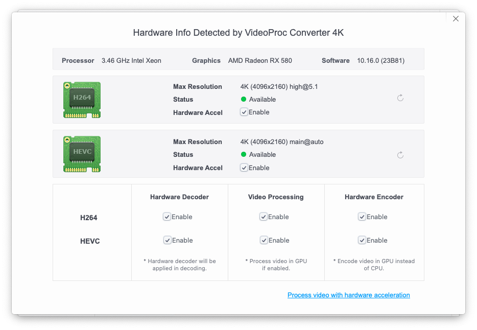

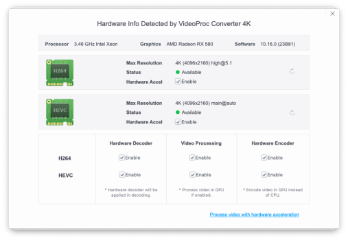

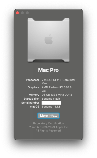

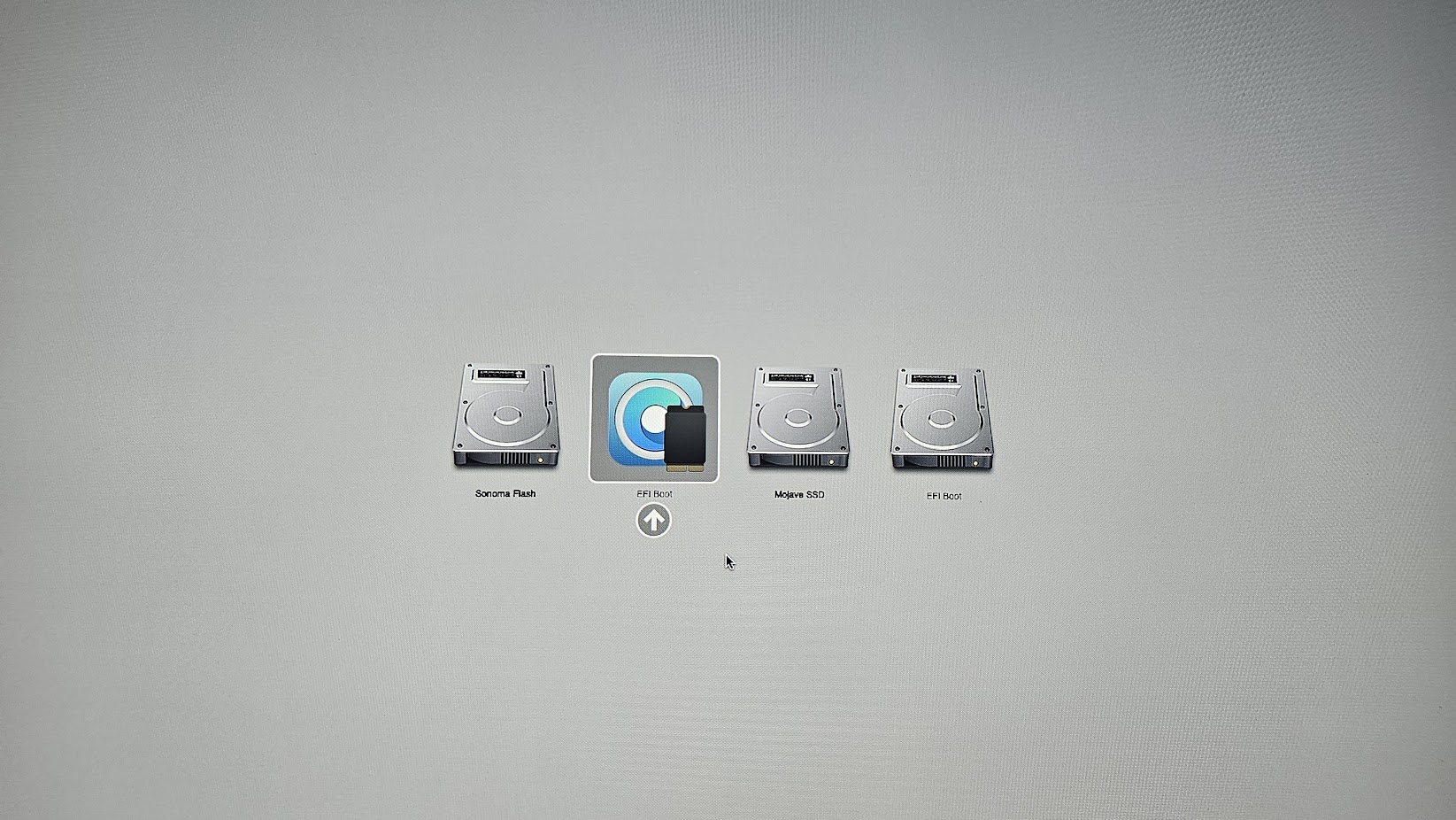

My config so far: 4,1 -> 5,1, using OCLP 1.2.1, macOS Sonoma 14.1.1 installed on NVMe Samsung 970
EVO 500GB, rest of the config is on the screenshot.
GPU is Sapphire Radeon RX 580 8GB Pulse (2xHDMI, 2xDP, DVI).
Mac firmware is flashed with EnableGOP 1.4 and it enabled full gray boot screen as you can see.
Also, VideoProc 1.6.1 reports fully supported H.264 and HEVC acceleration.
Its stable and fast. I only wish I can have faster NVMe speed.

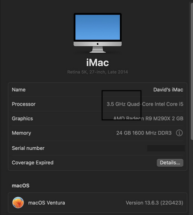

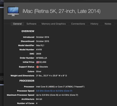

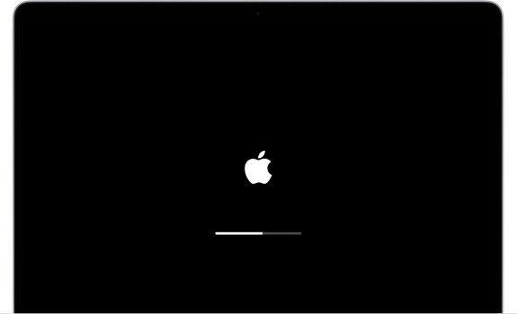

2014 5k iMac ... I think that's iMac 15,1 in OCLP terminology: Sonoma 14.1.1 booted fine after install, then OCLP offered to reinstall root patches. Next reboot hangs 1/2 way through the boot. I've tried clearing NVRAM. I'm building a new OCLP installer now to see if I can fix it that way. Otherwise, is there a way to remove the root patches so I can at least get into the OS to do a backup? Failing that I guess I'll try target disk mode and back it up from my laptop...
Is this the same iMac from your Ventura post #7,535?? 🙄
View attachment 2312142 Hmmm?? Nice iMac, tho.
Yep, Sonoma on the internal Apple SSD blade (left over from the original Fusion drive, and Ventura 13.6.3 on an external Crucial 512GB MX500 SDD. Using OCLP 1.2.1 release version on the internal SSD. iMac 15,1 i5 from late 2014, Haswell CPU 3.5GHz, AMD R9 M290X 2GB GPU.
Haswell is intel, not AMD. Just discussed the issue with an OCLP developer who wrote that AMD GPUs are free of the intel Ivy Bridge and Haswell issues. Your iMac confirms that fact. 😉
