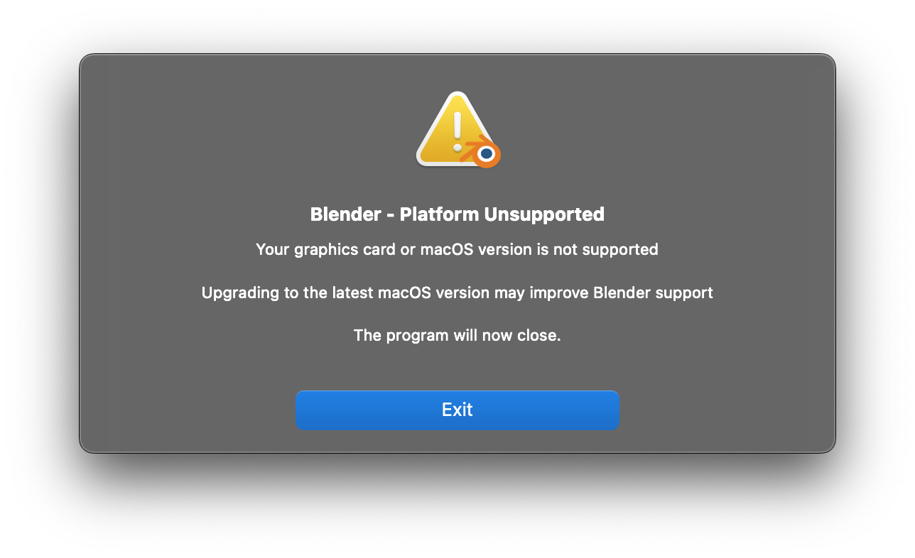

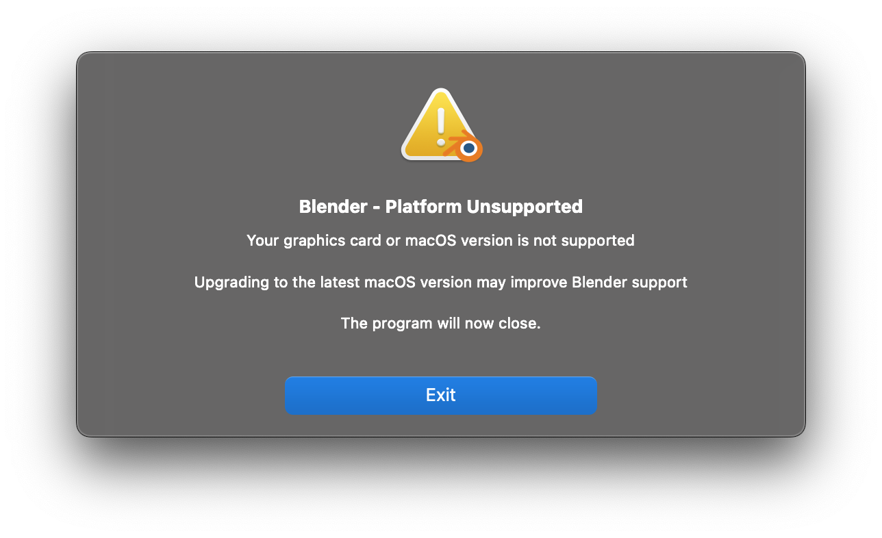

And here we go again, this time with the new Blender 4:

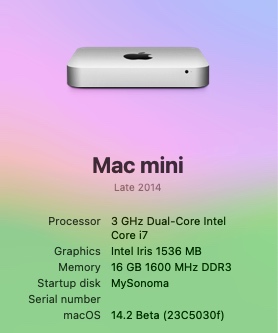

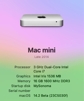

Reinstalled macOS 14.2b1 atop broken (boot looping) b2 and all is back to somewhat normal. Finding the b1 Install Assistant (19.2.01) required some digging since OCLP offers only the second beta in the app. Discord had b1, btw. 👏
14.2b1.jpgBeta 1 runs almost as well as 14.1.1 except for the Stocks Widget which needed to be re-installed. App is ok.
Hmmm… from the Blender 4 release notes (so, it could perhaps depend both on Metal 2.2 being required and on dropped support, for Nvidia Kepler and Intel Haswell: not an OCLP issue?):
Graphics Cards
  • The minimum required OpenGL version has been increased to 4.3 for Linux and Windows. (3478093183)
  • On macOS only Metal is supported now, and the OpenGL backend has been removed. A GPU with Metal 2.2 support is required. Intel Macs without an AMD GPU require a Skylake processor or higher. (cdb8a8929c)

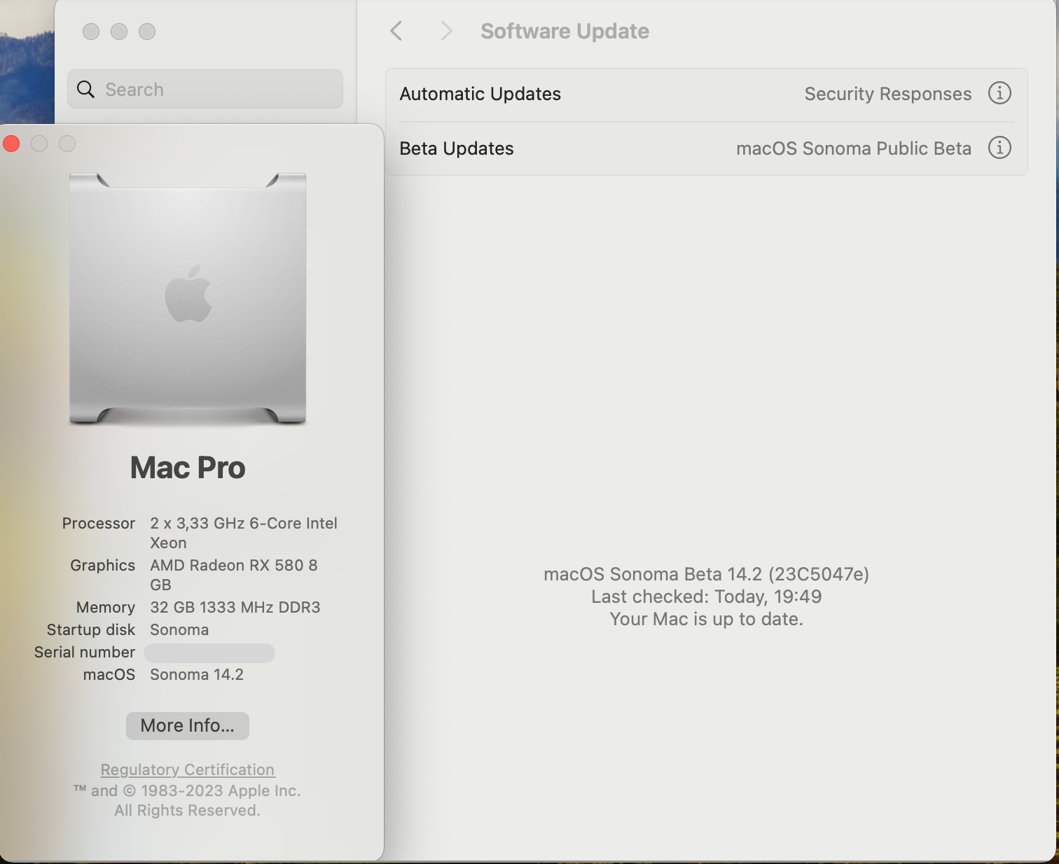

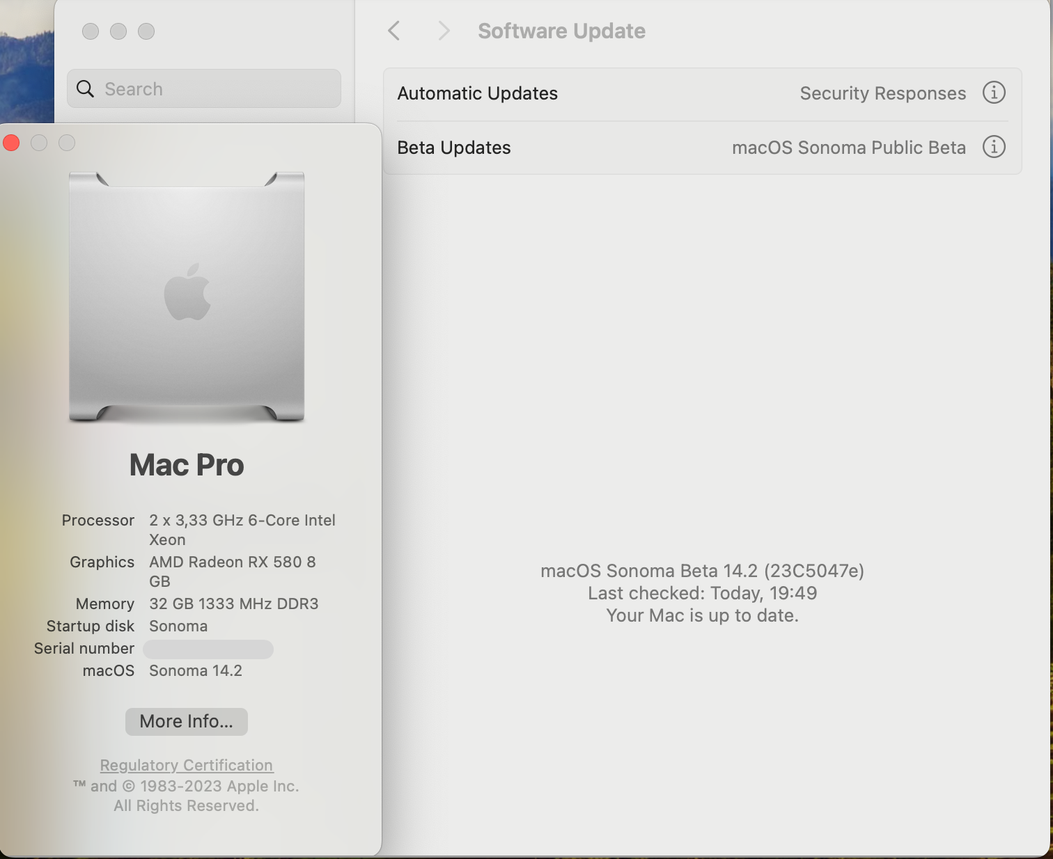

Third Public Beta of macOS Sonoma 14.2 is working very fine in my MacPro 4,1>5,1 after a smooth OTA update. No BT of course but very nice performance after OCLP 1.2.1 new patching.
