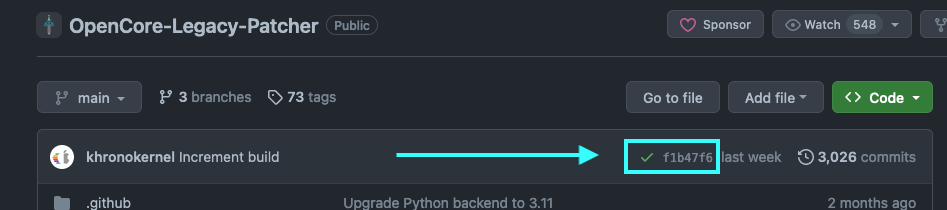

Well, it would be smart to look into the summary of the lastest commit to see what changed before just running the nightly patcher. You can find a link to the summery on top of the file list:
And as of today, nothing more than a Version bump to 1.3.0 has been commited:
