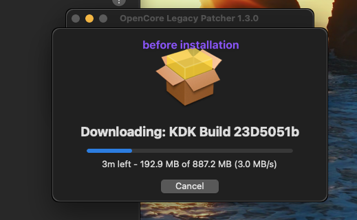

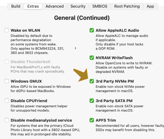

macOS 14.3 (23D56) with KDK_14.3_23D5051b.pkg OTA update works like a charm with OCLP 1.4.0n on MP5,1 | RX580 | 990 Pro NVMe 😍 (and MacMini's, iMacs and MBP's 11,X 12,X also OTA from 14.2.1 to 14.3 all without problems)
Update: KDK_14.3_23D56.pkg is released also!

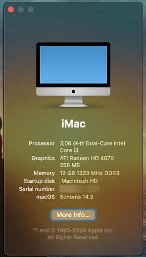

Imac 11,2; OCLP 1.3.0
