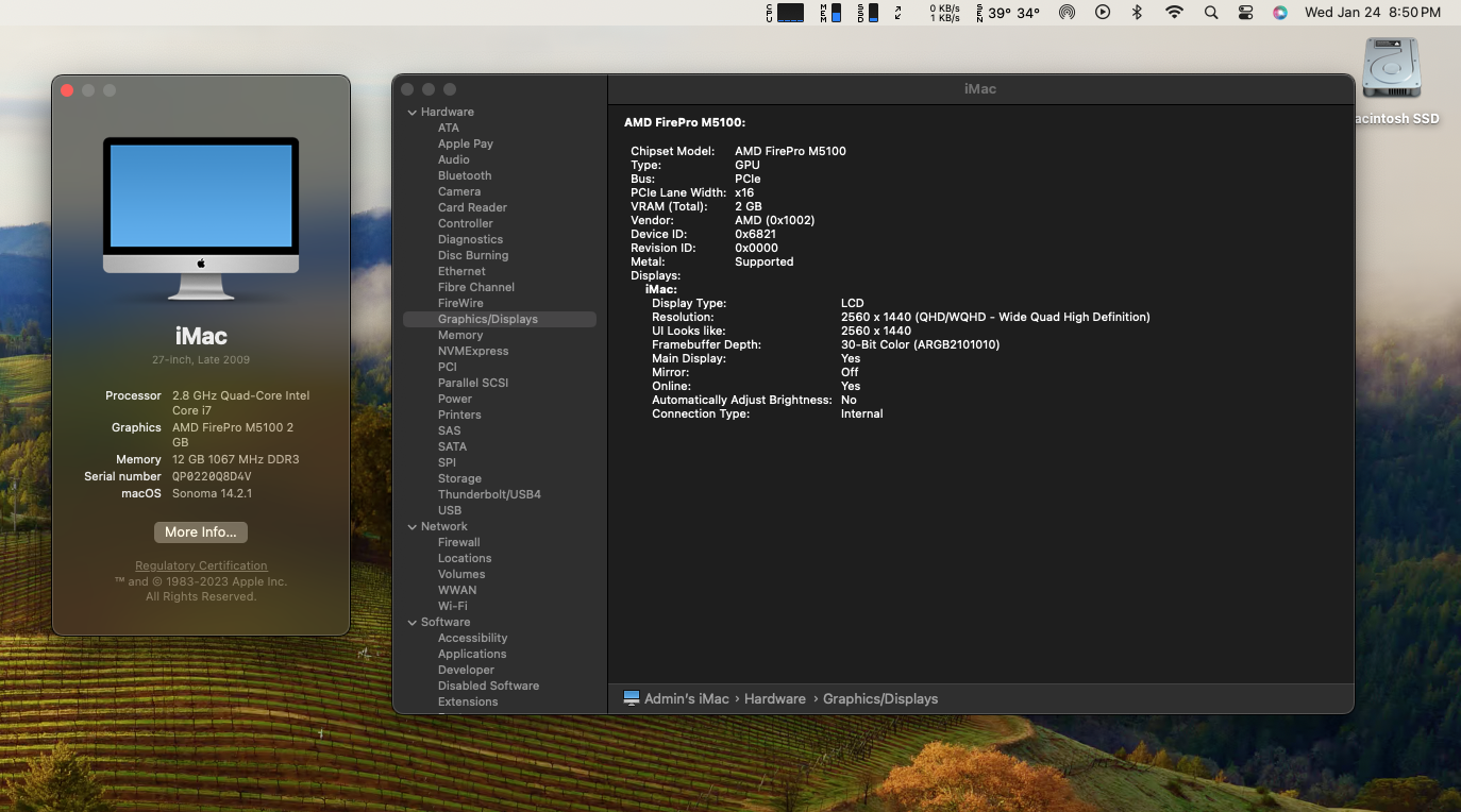

iMac 11,1 +metal (AMD M5100) macOS 14.2.1 OCLP 1.3.0 works perfect and fast.
All non metal anomalies gone
  • all transparency issues (flickering window panes, menu bar colors etc, and looks a lot better like macOS should)
  • maps and anything relating to maps (calendar address looks up maps and will crash wo metal)
  • photos work (although they were working on 11,1 but not 11,3. I suspect 11,3 +metal would just work)
GPU heat sink temp 34C as I type this post. 60C when running GPU benchmarks. Generally top of this usually hot iMac seems to run much cooler than before metal GPU. Perhaps CPU was made to work harder wo metal before? Don't really know.
Full detail in my OCLP Sonoma database in signature link including play by play M5100 upgrade process.

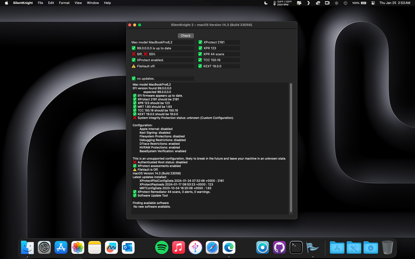

MacBookPro6,2 | Sonoma 14.3 | OCLP 1.4.0 seems to run smooth 👍
Haven't done a deep dive on everything, but waking from sleep seems snappier.

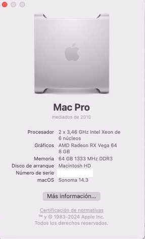

Macm Pro 5,1 updated without problem. OTA update, just had to reapply root parches.
