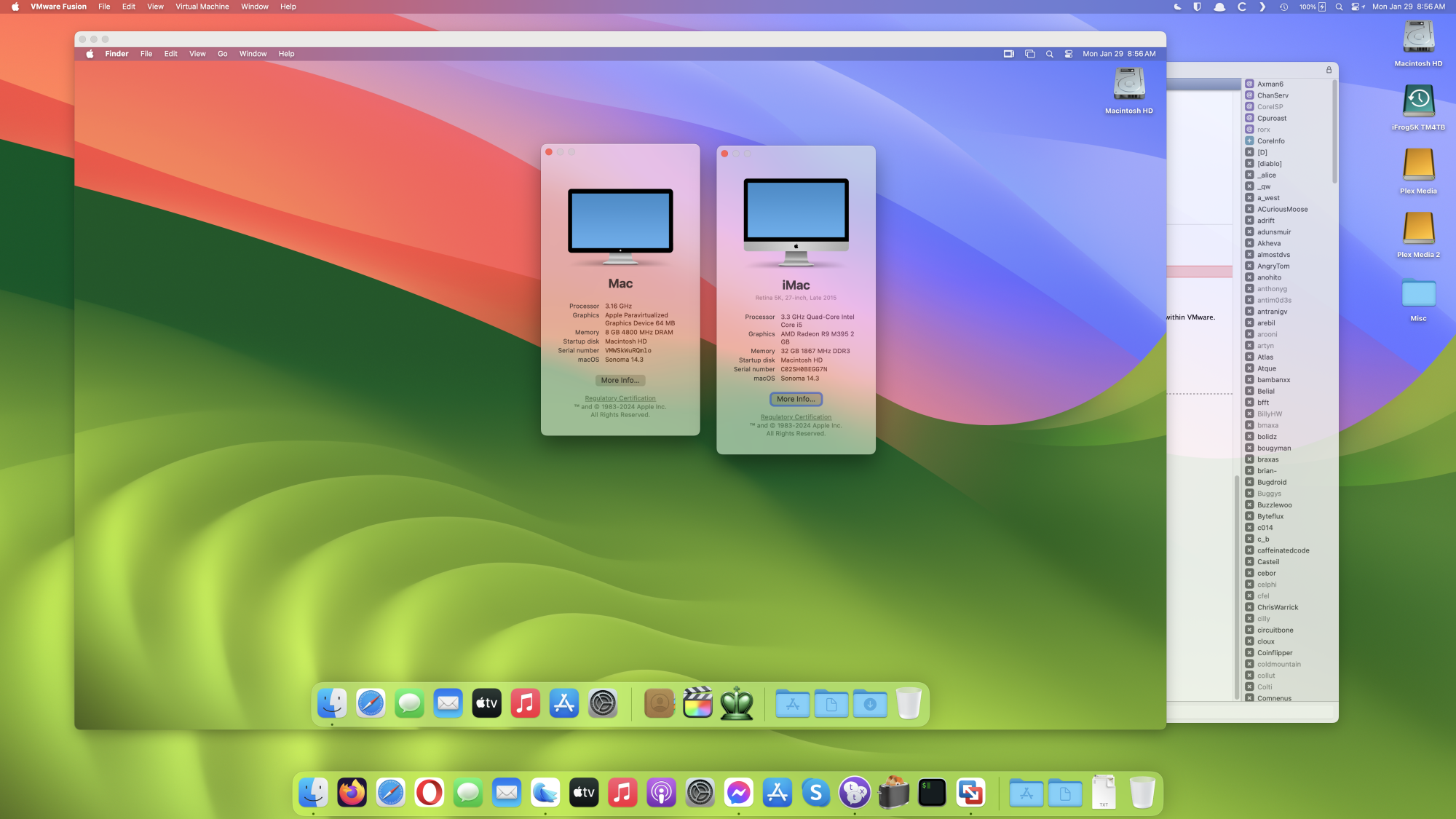

OK, I wanted to post some very differing results I've encountered since upgrading to Sonoma on my iMac 17,1 with Open core 1.3.0 and Sonoma 14.3. Some of the issues reported include 3D acceleration not working in VMs both on Fusion, and Parallels. While I can confirm this for guests such as Linux, where I have to switch to Software Rendering mode for Cinnamon, and or disable 3D in the Settings for the VM for Windows, or Linux (not running Cinnamon ) The Apple GPU seems to work fine for macOS guests. Both my Ventura and Sonoma VMs boot with 3D working.
Here is a screenshot of Sonoma running as a Guest and as host (patched by open core) on an iMac 17,1. So it must mean only certain types of 3D acceleration don't work, while others do. This was done with VMware Fusion Professional 13.5.0 on Sonoma 14.3, on OCLP 1.3.0 and an iMac 17,1 (top tier config) before going custom.

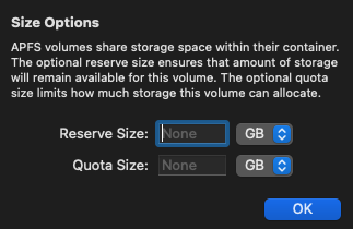

I've been testing Sonoma on a spare MBA for the past couple of months, starting with 14.2. The latest OTA upgrade to 14.3 went smoothly, and I'm no longer seeing an issue waking from sleep. I'm about ready to add a Sonoma volume to the second, main MacBook Air. That MBA runs Big Sur. The internal SSD, which is a Hynix Gold P31, has no partitions, with about 600GB of available space. I'm planning to use some of the available space to create a second volume, onto which I'll clean-install Sonoma 14.3. I imagine that 20GB would suffice if I leave data and apps on the original Big Sur volume, but I'll likely make it larger to accommodate a migration of settings after the installation completes
Now a question: will an APFS volume automatically resize as needed, or do I need to go to Disk Utility to change the volume size manually when I'm running low on space? It would be convenient to copy apps and data to the Sonoma volume, though it's not strictly necessary, as I've seen on the test MBA. It has both Big Sur and Sonoma and migrated settings and preferences, but apps and data are on the Big Sur side.
Reactions: luckyduke23

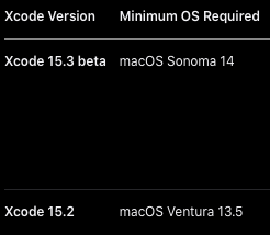

Xcode is my main tool and with the coming 15.3 release, I will be forced to upgrade to Sonoma. It will be the end of the Ventura story !
I quote myself ...
I was curious about that, will Xcode 15.3 require Sonoma? I thought I saw something from Mr. Macintosh saying it would still work on Ventura, at least the beta, or was that 15.2? I honestly don't remember off the top of my head.
You are correct ... Sonoma is required for Xcode 15.3. See here.
