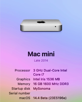

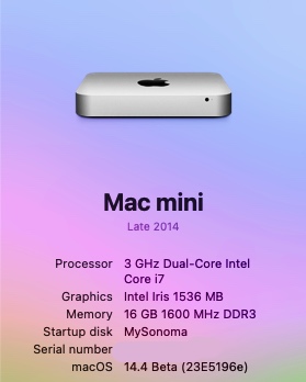

mac0S 14.4b3 installed atop Beta 2 OTA, OCLP v.1.4.0n runs as expected. :cool:
