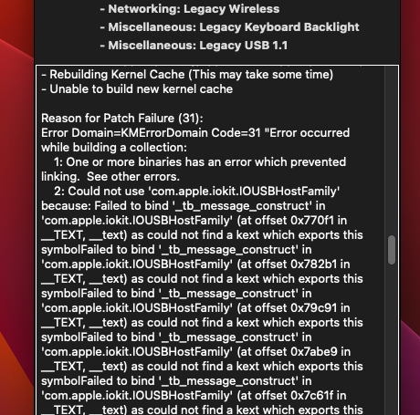

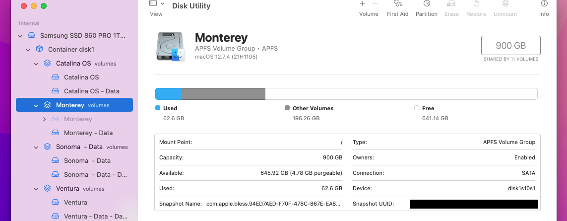

MacBook Pro 5,2 17* C2D 3.02 MGz (Penryn), 1TB SSD :
Applied OCLP 1.4.0n while booted in Ventura, then booted into Sonoma Volume.
Sonoma 14.beta2, installed via USB thumb drive, boots to login screen, but is inaccessible since neither internal keyboard/trackpad nor wired keyboard/mouse are functional (the latter routed through external USB hub) . Can’t login to check functionality. Resetting SMC or NVRAM made no difference.
Booted back to Ventura volume and noted, that after installing OCLP 1.4.0n from 2.13.24, I could no longer login using internal keyboard. I had to use wired keyboard, routed via external USB hub, in order to login. Previously that was only necessary after installing Sonoma variants. I also reapplied patches, but process failed at “rebuilding cache” stage. I took screen shot of the section of OCLP install log, since copy/paste did not function. Patching process stopped due to problems with “missing” USB IO functions.
Reinstalled Ventura via thumb-drive to overwrite the patches, then removed contents of the EFI partition. Reinstalled OCLP to the drive and applied patches, but results were the same. Patching stopped at “rebuilding cache” stage. Resetting SMC or NVRAM made no difference.
Monterey volume remains unaffected by OCLP Version change and boots without issues.
Attached are a screen shout of OCLP output log and , for reference, a screen shot of disk utility mapping the SSD drive on the MacBook Pro.
Hope this may be of help.
