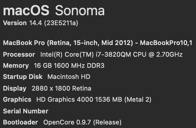

Ah well. This is on a rMBP 10,1 mid 2012 with latest stable Sonoma and OCLP. 1.3.0 YMMV
