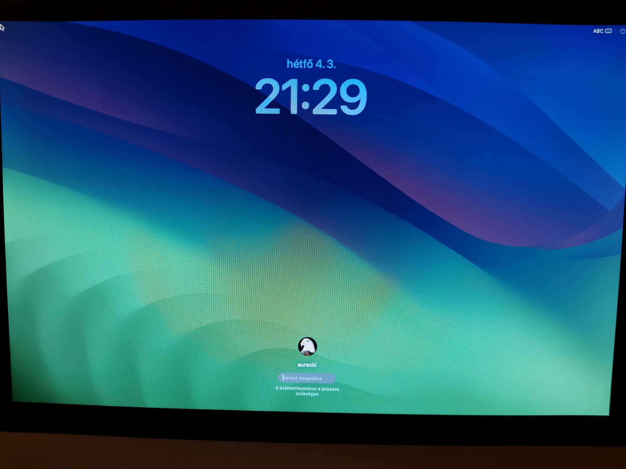

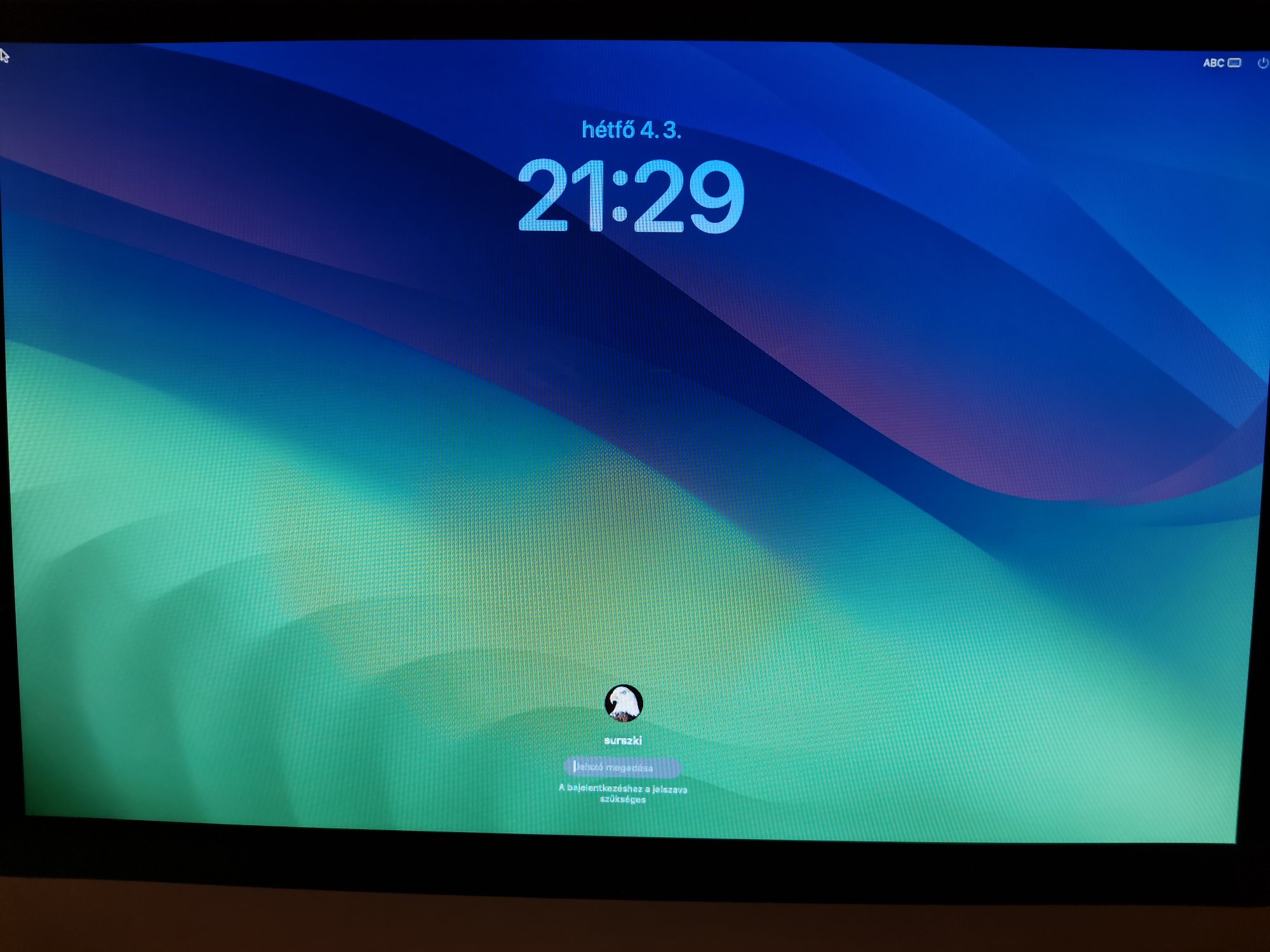

figured I would give the update to 14.3.1 a try on my late 2015 iMac running OCLP 1.3.0. I have been using 14.0 happily, although a little stutter and the only issue I had was the random screen turning on bug when it was idle but I would just click the mouse and the screen would darken again.
well updated to 14.3.1 after making sure all my patches were pre-installed. now, I get the same flashing log in screen issue I was seeing on 14.x which prompted me to return to 14.0. the log in screen prohibits the mouse and keyboard from being used to log in and the screen goes black, then lights back up every 2-3 seconds. figured this wouldve been fixed by now.
I'm currently using safe boot to access the computer which allows the log in screen to work fine. anyone have a solid fix for this issue? read some threads advising to remove a Memoji log in icon, I don't have that. just my iCloud photo as the log in icon.
EDIT: I was able to change my profile pic to monogram and it works now. is there a more permanent solution for this since it was working fine on 14.0 with the previous profile pics?

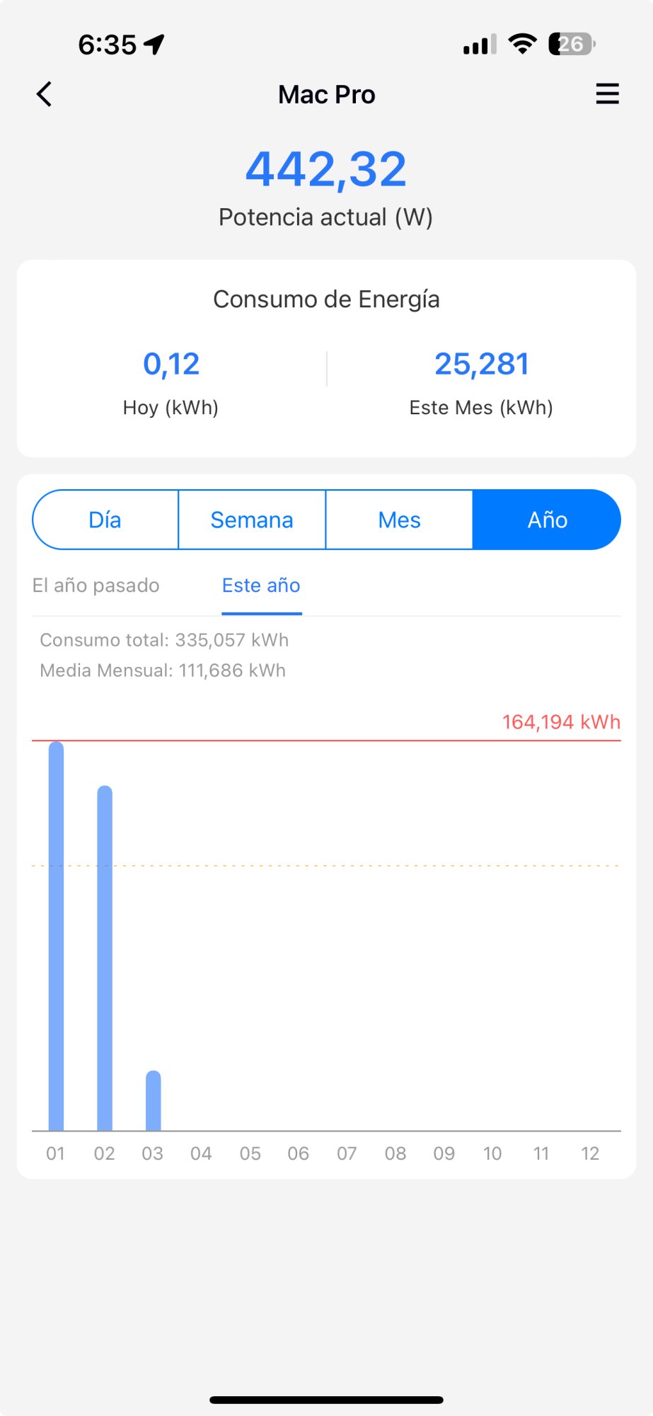

I would start by recommending against sleeping a desktop. Just let the display turn off while idle but let the computer idle / run, or shut down and turn it completely off. A desktop computer doesn't need the sleep function like a portable does.
If my OCLP Mac Pro coundn´t sleep, my bill would be much higher. Switch on and off is when a computer suffers more.
In terms of a Mac Pro, because they use more power sleep would be beneficial yes. For something like an iMac, the display is the highest power consumption on those. For me, even with my iMac running 24/7 and simply sleeping the display when idle keeps my power bill around $50 - $55 a month, and about $70 - $80x when the AC runs in the summer more. So in terms of power consumption my recommendation not to sleep an iMac was based on that. I've never owned a Mac Pro, so don't have any experience with them. My closest experience with a Mac tower system would have to be the Yosemite Blue and White G3 I had years ago.

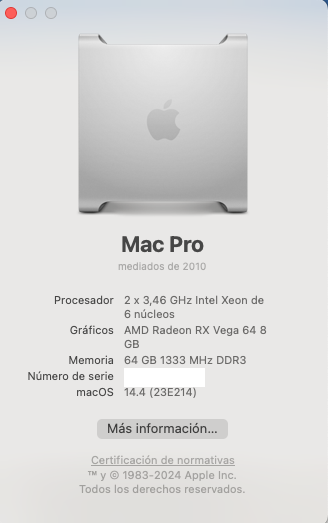

14.4 RC installed on my Mac Pro 5,1 without any problem. It seems to work like a charm.
