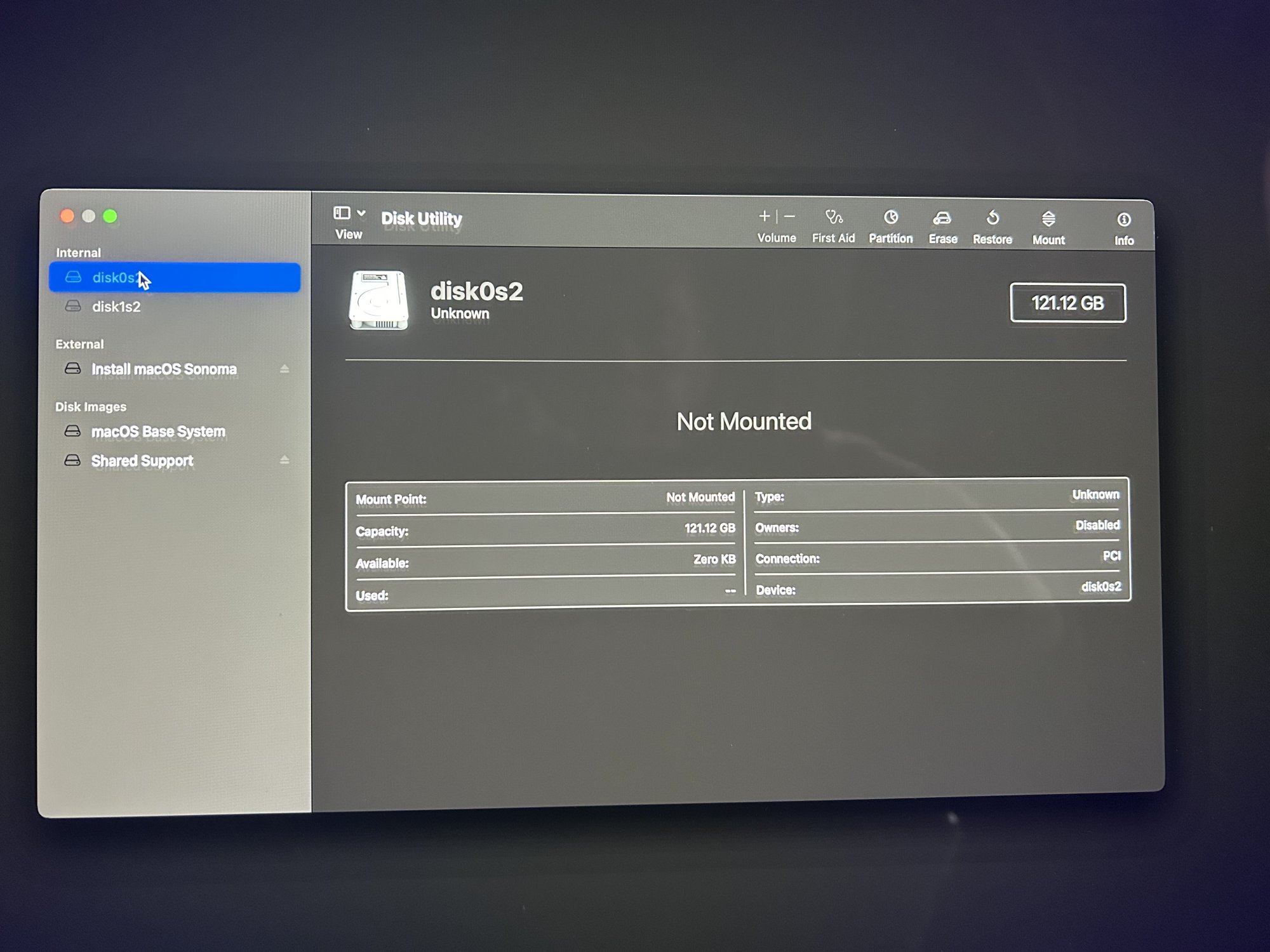

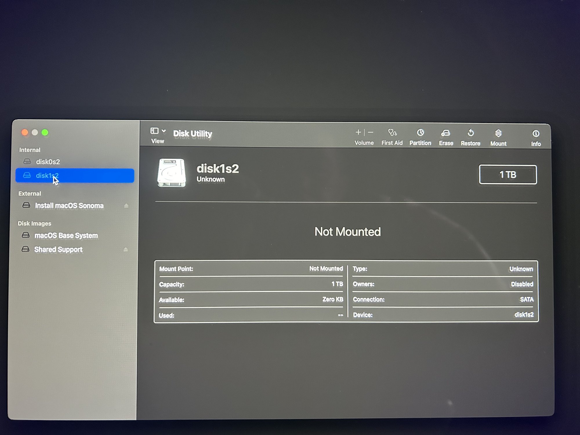

To revert back to Big Sur you must erase your disk as there is no uninstall option.
Option 1
- Backup all you data
- Download the latest Big Sur 11.7.10 from Mr. machintosh
InstallAssistant.pkg
- Create a USB installer using Apple instructions on the following link:
https://support.apple.com/en-eg/101578
- Boot from the created Install USB holding Option/ALT Key while after you hear the Chim.
- Using Disk Utility erase your Apple SSD Disk as APFS.
- Install macOS.
Option 2
- Boot into internet recovery using Option-Command-R
- Install macOS wil download and install the latest supported macOS for your machine.
Good Luck
Which one should I erase? Disk0s2 or disk1s2? What does it mean “Not Mounted”? Any difference “Erase” and “Restore”?
