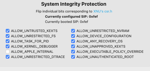

And have in mind csrutil is of no use in OCLP. When you boot, the settings in OCLP at boot prevalence. For your information, all my OCLP macs boot at 0xfef. But be cautious, this reduce security considerably.
That's what I was thinking, that csrutil no longer applied to OCLP as no one running it ever mentions using it to disable SIP anymore. Plus I figured if it still worked there would have been no reason to add the settings to OCLP as people could have just turned it off with csrutil. Thanks again guys for the info, and clarification.

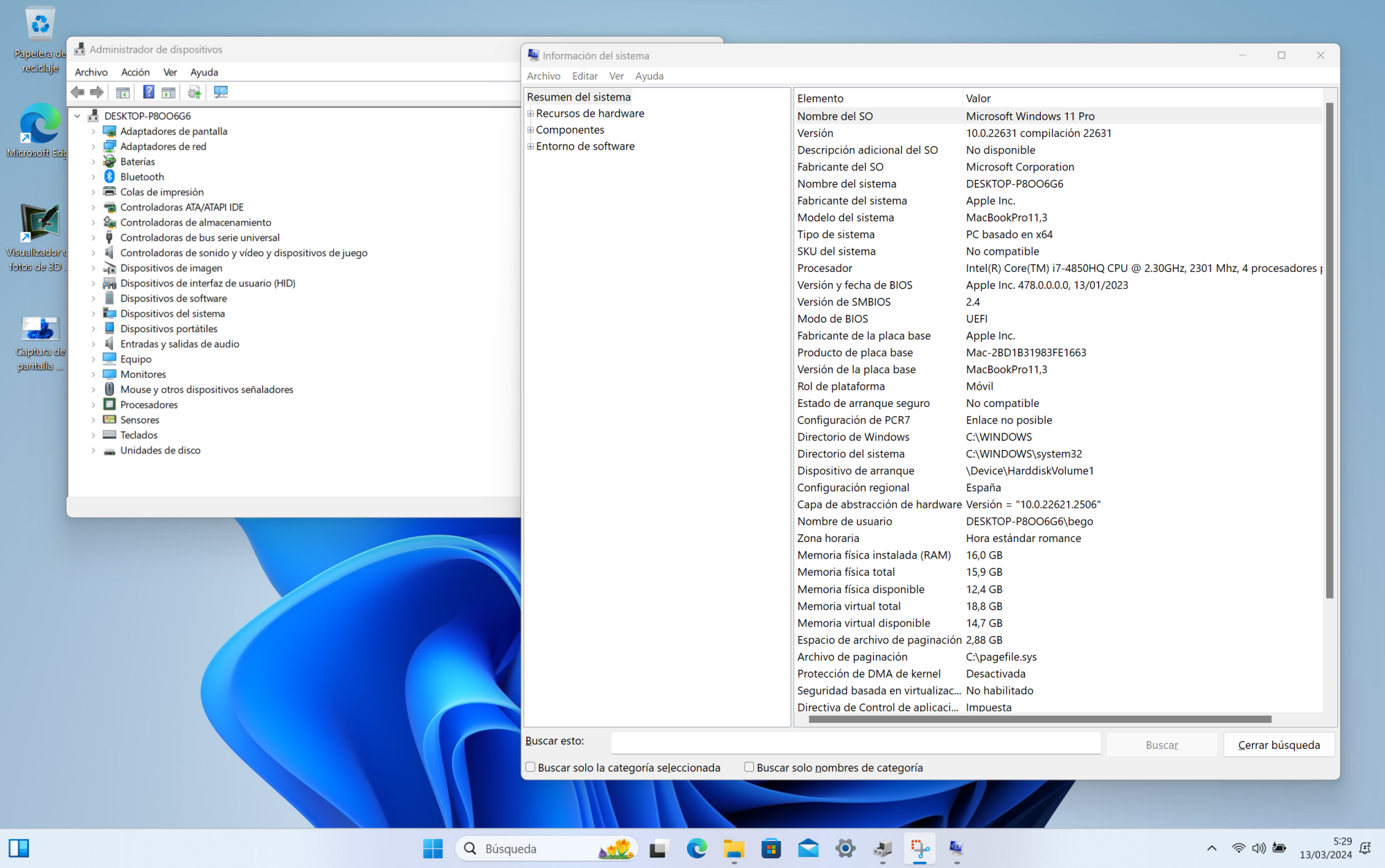

Just fot curiosity, I have updated my efi Windows 10 installation in a macbook pro 15" 2013 to Windows 11 directly from Windows 10. All drivers are loaded. Wifi, bluetooth, sound, etc. Even shortcuts for controlling keyboard brightness, display brightness and sound work.
I also achieved this in the past, but last week I tried with Windows 11 23H2 and I was only able to update but without keeping the previous version of Windows 10.
