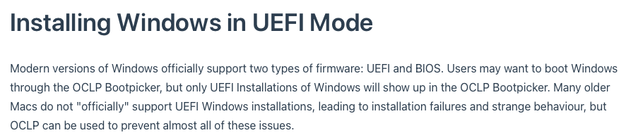

Try not to boot from EFI Boot (OCLP) when booting the bootable USB stick for Windows 11 (try to create a USB stick in MBR format and not GPT), you will be able to update your existing Windows 8.1 installation if you do it this way.
thank you! i'll try this as soon as possible!
You CAN´T boot or install a legacy windows installation from OCLP boot picker, always will give you errors. OCLP boot picker can only manage operating systems based on EFI boots. You have to press Alt when booting and NOT LOAD the OCLP boot picker, just choose the Windows Partition or USB installation directly.
thank you *******!!
that will be my next approach.
(just because i'm curious - all my prevoius attempts only failed towards the end of the installation process - and a different boot picker selection and a mbr formated usb stick - not efi - will help me to get a successful installation?))
thank you again, man ... !!
I may be misunderstanding what you mean by "legacy windows installation" but this is empirically not true here
on a rMBP 2012 and using the Dortania link works if you follow it to a tee, and if you do not follow it exactly, I have seen the kinds of errors with aborted boots that pepepro appears to be seeing.
If you mean something else ignore this post. Ah well. If another way works for someone else then great.
I am in no way a WinGuru.
the only thing i changed was the creation of the usb stick - i did it on another windows machine with the help of rufus, to overcome windows 11's hardware restrictions right from the beginning.
FWIW, I believe that may be the issue here. Using regedit as described in the Dortania link to a tee (I have seen the kinds of errors with aborted boots that you appear to be seeing when skipping or missing steps in that instruction )
has worked here, including the three simple regedit "live" edits during the install at the "This PC can't run Windows 11." dialog.
Ah well. Good luck regardless of your strategy.
In my case, the only way to install Windows 10/11 was to let the Bootcamp Assistant create the boot partition and pendrive, as it creates a hybrid MBR/GPT partition necessary for my hardware (Legacy mode)
Actually, it IS true :). "Legacy" windows means BIOS-based, which is not supported by OCLP:
However, it says it won't show, so maybe that's not the issue here. My Win11 is BIOS-based (legacy) so I always boot it holding option at startup, using the Mac's boot picker (I have the OCLP boot picker hidden anyway).
If the installation is BIOS-based it has to be booted there, and if it's UEFI-based, it can be booted from inside OCLP. At least that's how I've always seen it.
Cheers,
Well sure. Misunderstandings galore perhaps ;) The Dortania link I gave is of course a UEFI instruction for OCLP as that is what my rMBP supports and I am triple-booting Win11, Sonoma 14.2 and Ubuntu22-23 from within the OCLP bootpicker on some old Macs . Apple either supports Windows on UEFI or BIOS on a given Mac model. Maybe hybrids on some Macs, not sure. In short, the Dortania instruction works for UEFI and if you can use that it has some advantages over BIOS that may or may not matter to you, depending on what model Mac your attempting to dual boot and if it can use UEFI. I was assuming UEFI as this is a OCLP forum.
If you don't want to use OCLP then there are other ways for sure and so "Legacy" windows means BIOS-based"
