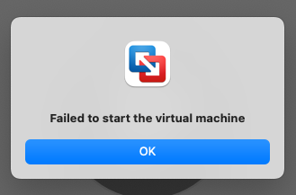

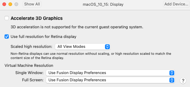

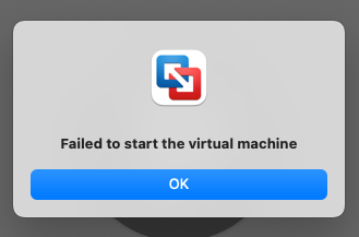

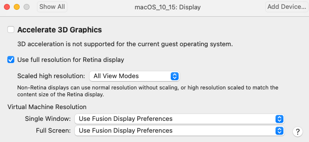

Dear colleagues, do you think there are prospects for launching paravirtualization on Intel Ivy-Haswell in the future? There is a great need to run virtual machines under Sonoma. Or is it only a downgrade to Ventura for good?
When I tested Ventura, VMware didn't work on either Ventura, or Sonoma for 3D acceleration. on an iMac 17,1. I had to go back to Monterey for it to work. As I mentioned in my posts above, it seems like if you want flawless graphics functionality, you either need to:

I'm not interested in 3d acceleration. Virtual machines do not start at all.
Paravirtualization is 3D acceleration for macOS guests, so while you may not want it for third party operating systems, you're still dealing with it. My situation may, or may not be the same as yours though. For me, VMs were a way to deal with macOS dropping 32-bit support in terms of games. So, I would either need to run a windows VM, or Linux and 3D acceleration was necessary for graphics to work correctly. With open core, that's no longer possible, and future versions of VMware start with Ventura or newer for support now. So the only work around I was able to find in this situation was to install Linux on an external drive and run steam and use Proton for the windows games I want to play. Sonoma works well on this iMac with Open core, and the pro apps seem to work. I did test a macOS VM on this iMac a while back under Sonoma / OCLP, and paravirtualization worked. However third party 3D acceleration didn't. the machine would boot and then go to a black screen. If you check out the Sequoia thread, there was talk there about paravirtualization working in Paralells, so that might be worth you looking into to see if that will work for you.
