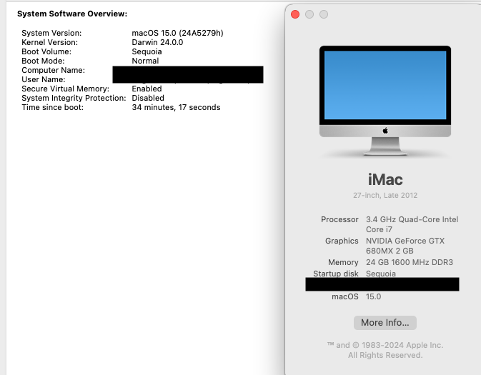

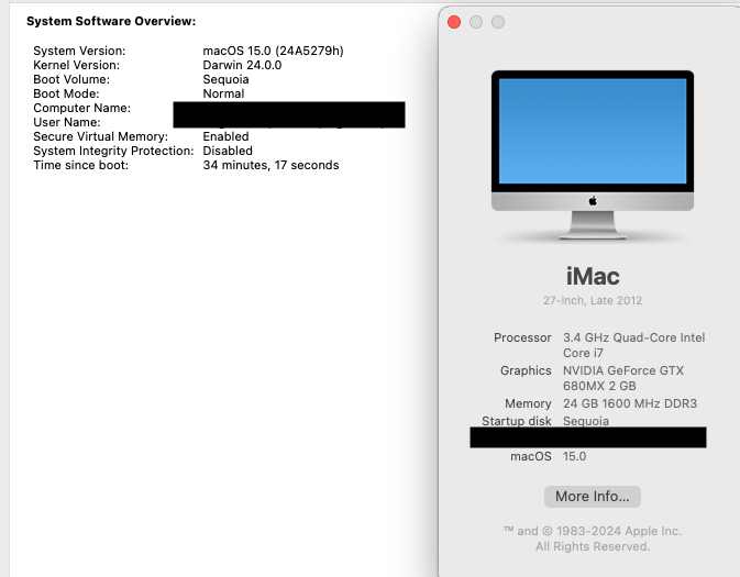

Hello to all,
Successful installation of Sequoia Beta2 on iMac 13,2 2012 27", Fusion HDD (original apple), **not patched** yet.
I already posted regarding previous attempts at Sequoia installation which, (now) not surprisingly, did not result in working installation of Sequoia (see post #176)
Disclaimer: Id faciam periculo meo.
Below is successful pathway:
Downloaded files from Sequoia-development branch on GitHub.
Updated Python to version 3.1.24
Downloaded pip dependencies from GitHub then, when prompted by message, updated PIP dependencies (the update was critical in my use-case)
The final result was OpenCore-Legacy-Patcher folder in "my" directory.
Maneuvered to the above folder via Terminal (cd [drugged above OCLP- folder onto the terminal window-(easiest)]
Attempted to run build "project command" in terminal, but each time in midst of the "run", program would terminate with -11 error ("missing file").
Parsed through OpenCore-Legacy-Patcher folder contents and opened Build-Folder found within, then opened
OpenCore-Build folder (nested inside the Build-folder). Found EFI and System folders in Build-folder, fully populated with relevant files (matching other working installations).
Since I did not have an actual installer (Python would exit in mid-build) I drugged the EFI and System files to the EFI partition on a disk with Sonoma 14.5 (mounted its EFI partition via terminal).
Did the same procedure for a thumb drive (with 14.5 installer) for back up.
Booted into modified 14.5 disk, then downloaded Sequoia (10.15 beta2) OTA, and let the installation process run automatically.
The installation phases for 15beta2 went through without issues, culminating in login screen. Logged in, and machine proceeded to Sequoia desktop.
Ethernet works, WiFi module is recognized but can't connect. There is no graphic acceleration, as I have not applied the patches. Posting via Safari while booted into Sequoia.
Incredible work by the OCLP and Legacy patcher developers et al, thank you!

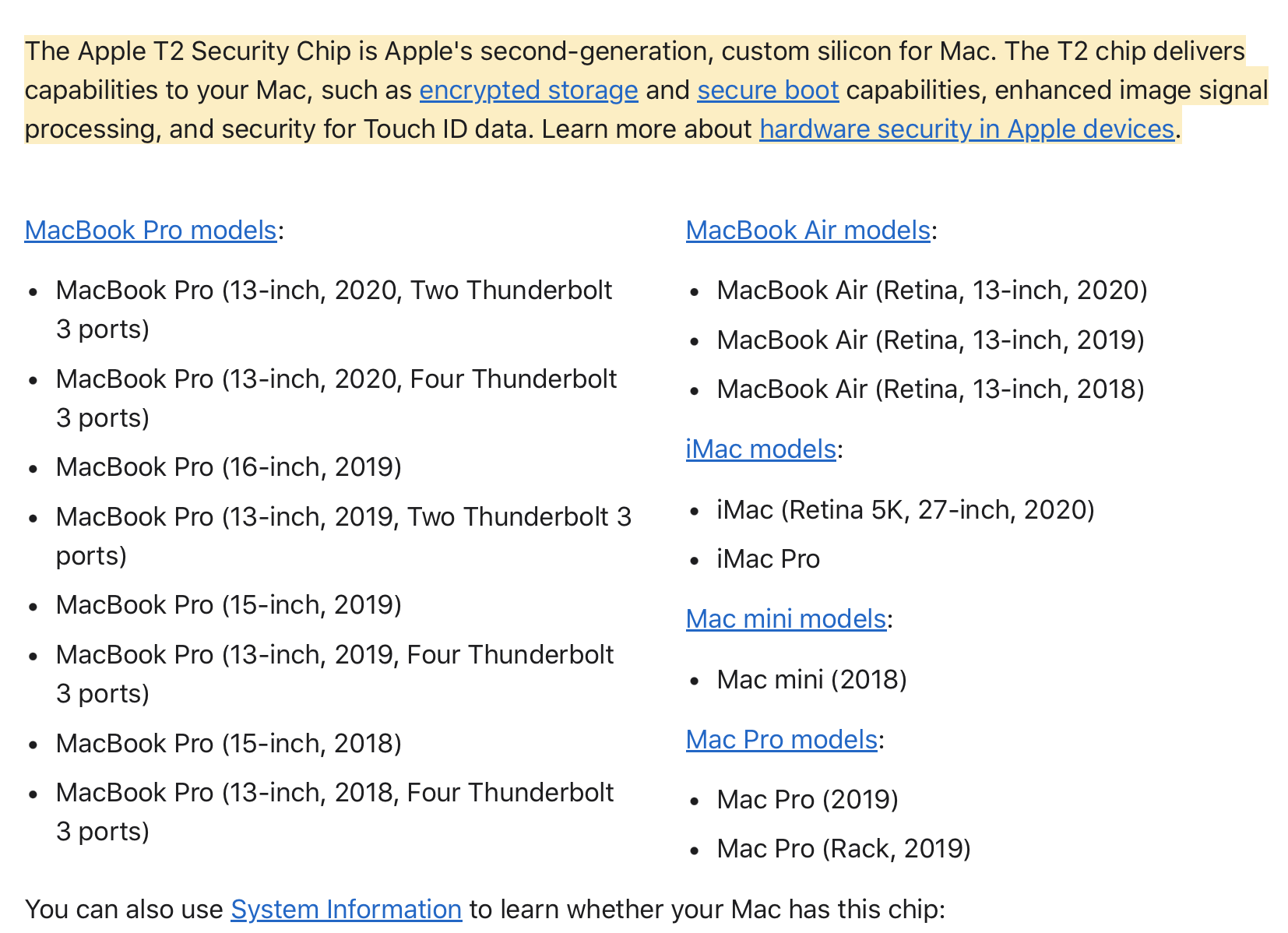

Thanks a lot, it got successful to install the 15 macOS on my 2017 MacBook Pro without normal operation issues with WiFI connection, trackpad and Camera. Thanks All the OCLP team members. We are looking forward to the final version of OCLP to support 15.
2017 not T2 chips so iPhone Mirroring not work is normal. Please note T2 Chip as below list:-

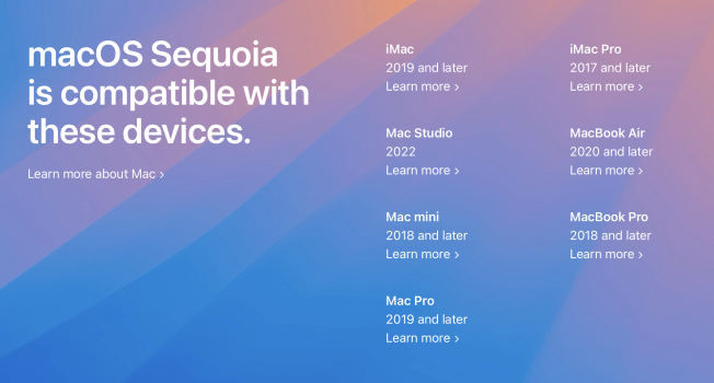

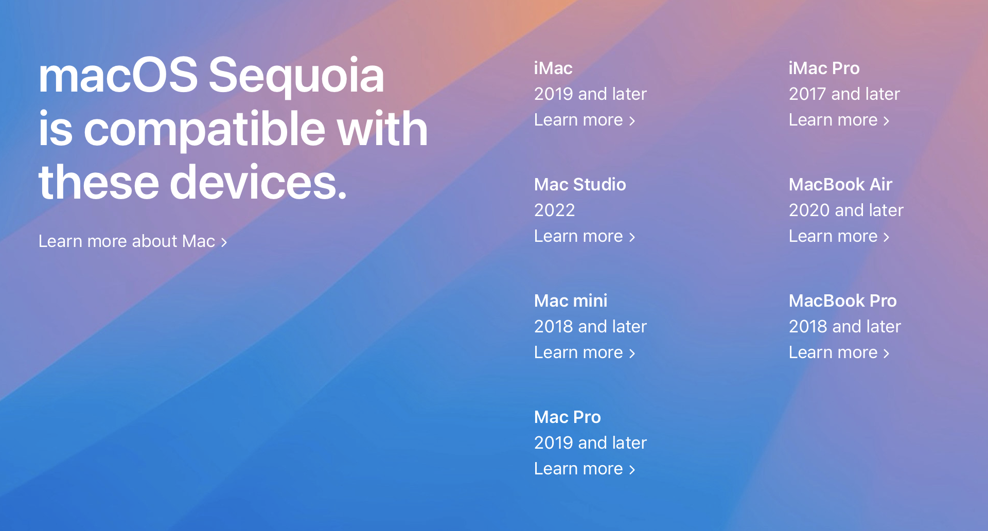

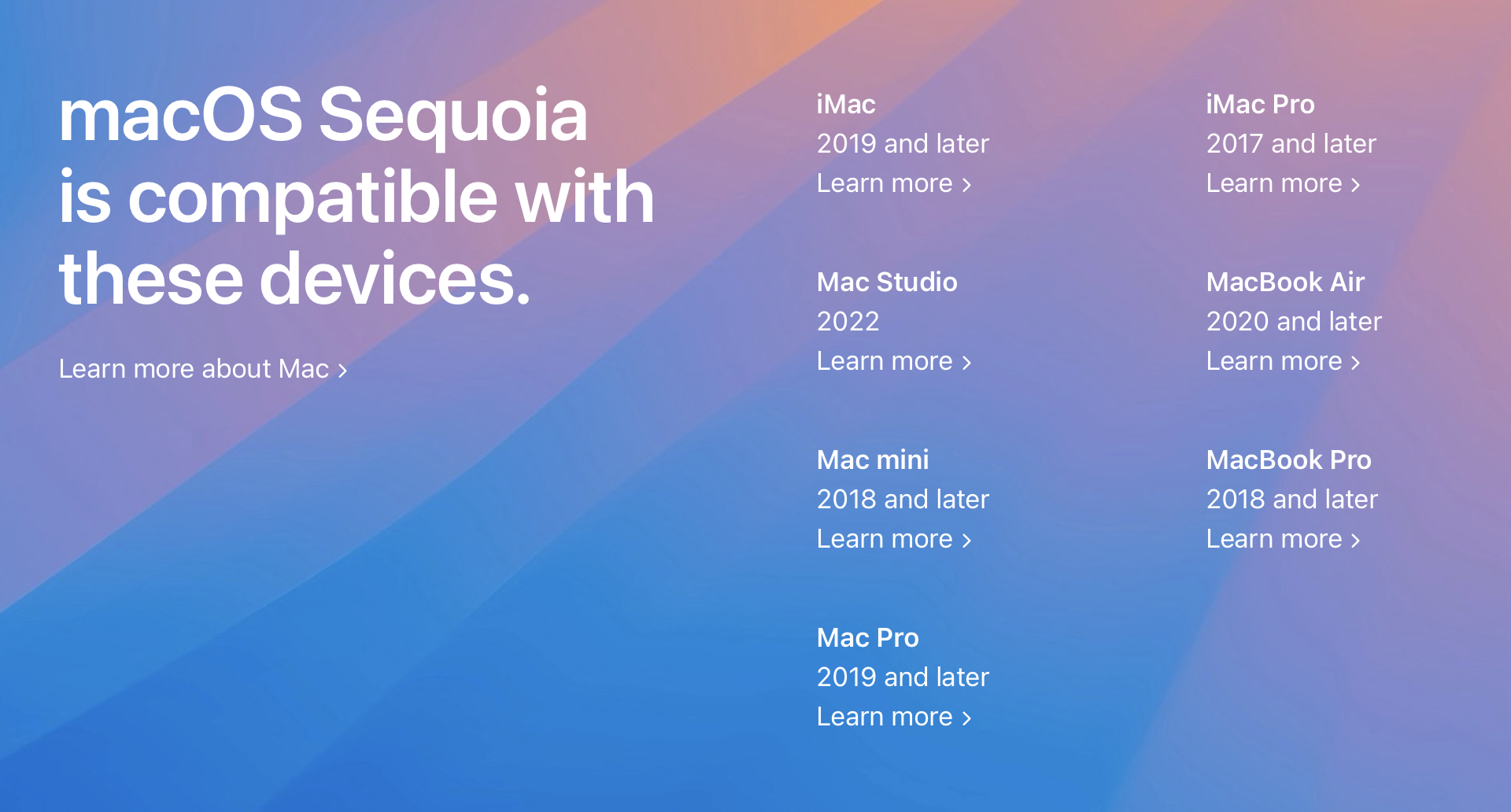

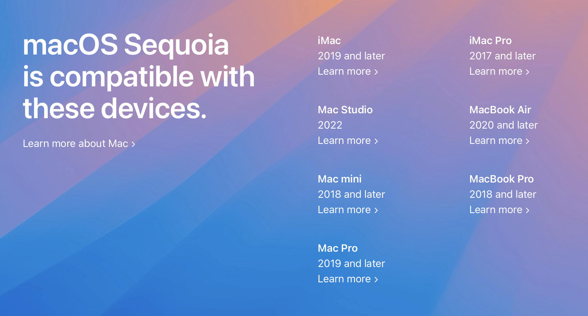

But Apple has a different list of compatible models.
iMac 19.1 2019 does not have T2.

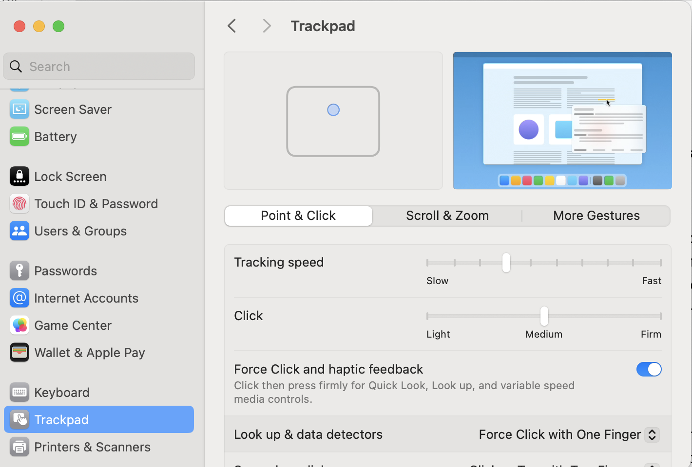

Do you have a trackpad and HD 630 working in 2017?
Neither one nor the other works for me.
Moreover: this does not work in A1990 2018, which is supported.
How did it work for you?

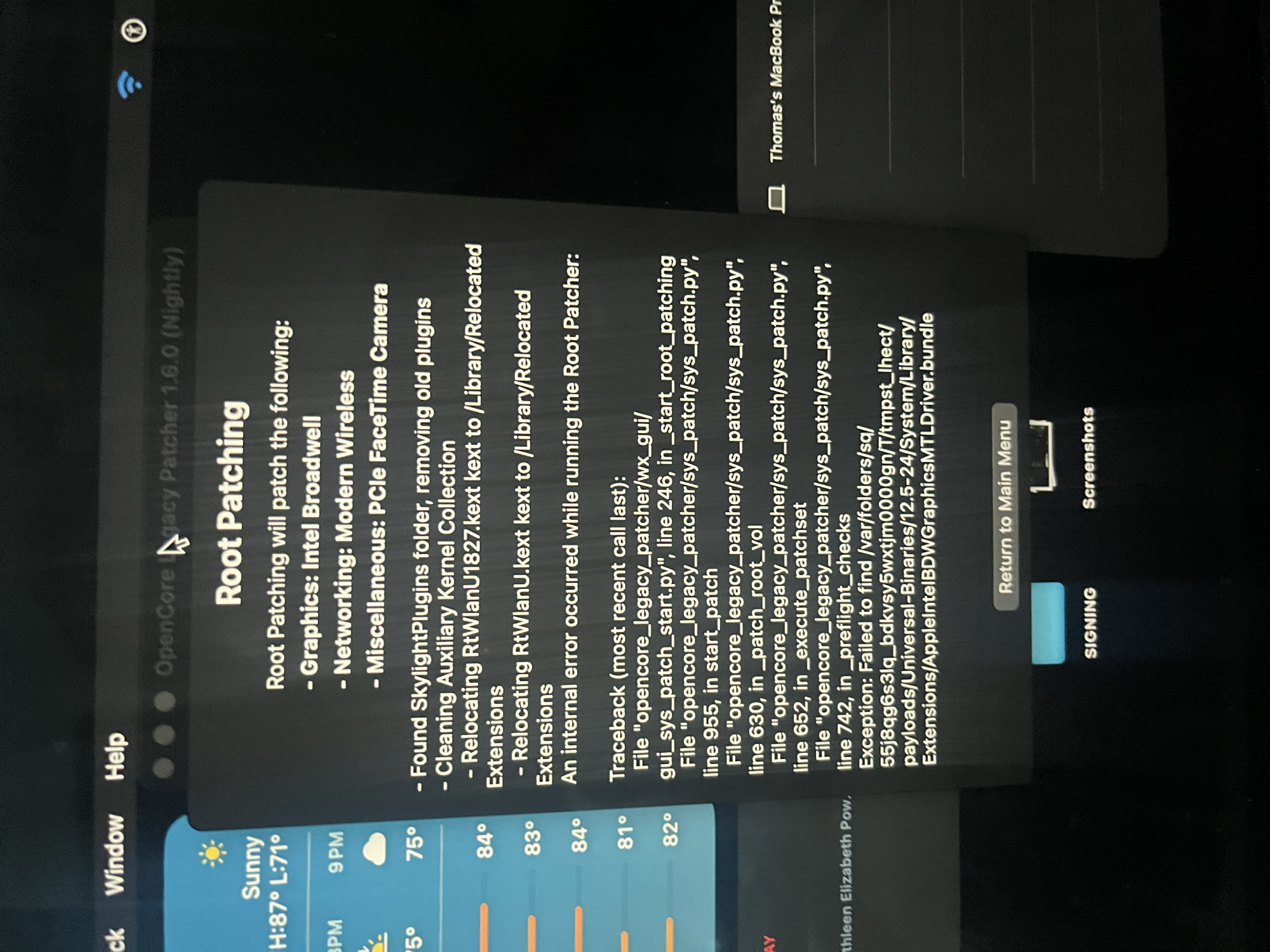

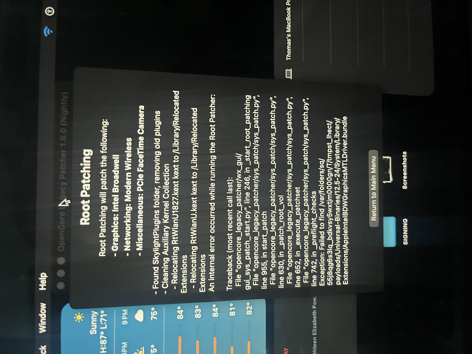

Installing macOS 15.0b2 on my 2015 13 inch MBP 12,1, and this happens when trying to apply root patches (excuse the fact it's sideways, it wasn't when I previewed it in Photos).
Yes - as the root patcher error message says, a file is missing.
OCLP for Sequoia is work in progress, no support so far, as developers have stated often. In this case, the executable python code is partly in place, but the necessary data (e.g. drivers needed on unsupported machines) not yet.
It is good to be patient and wait for the developers. Providing such drivers yourself would be hard.
See post #224 for a very limited attempt (even so, many more hurdles met than described in the post).

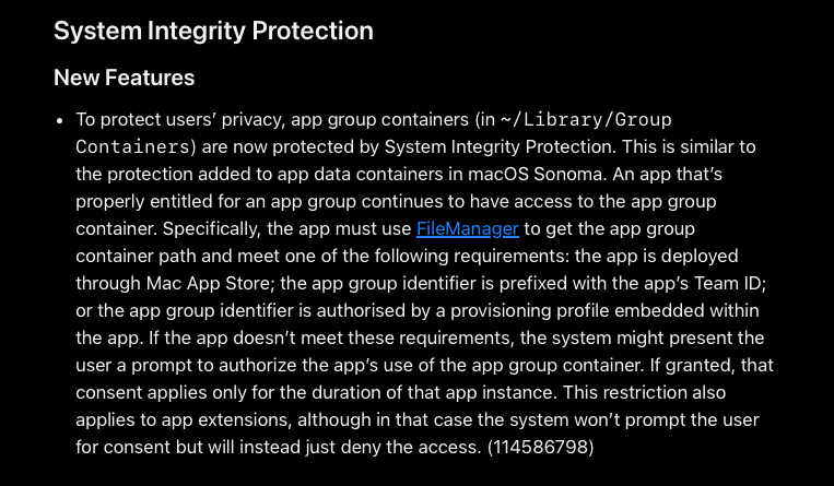

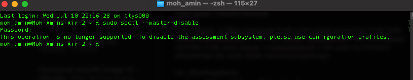

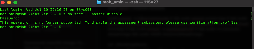

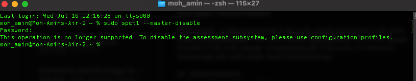

I unable to disable Gatekeeper using this command sudo spctl --master-disable on macOS Sequoia beta 3
This operation is no longer supported. To disable the assessment subsystem,
please use configuration profiles

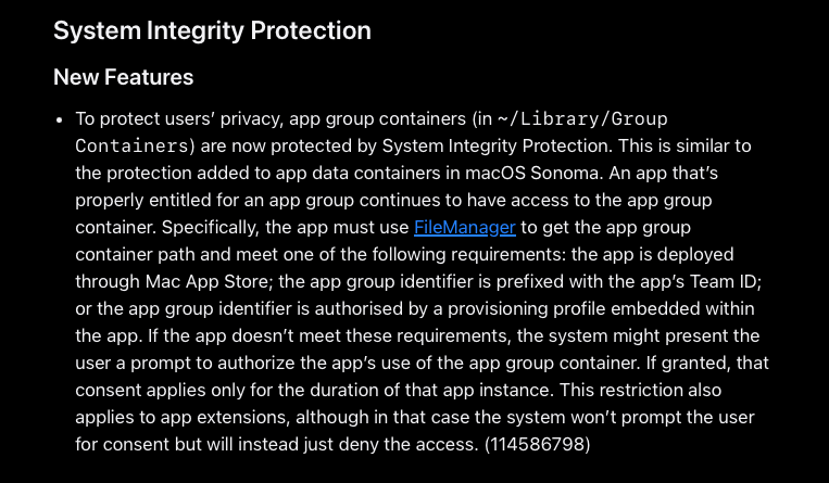

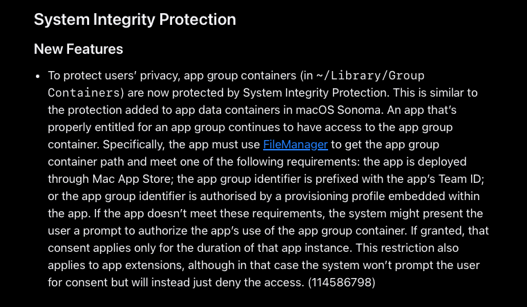

apple mentioned new feature for System Integrity Protection
how to use configuration profiles to disable Gatekeeper to anywhere

Sequoia Beta 3 works quite well also here, on MBP11,3 and external Thunderbolt 2 SSD. Sadly, without an Ethernet connection, it isn’t possible to install the OCLP Sequoia nightly build anymore, not being able to disable Gatekeeper (spctl) from the Terminal in the usual way: but not a big problem, as there are still no root patches.
Running a Retina MBP at 2880x1800 (no root patches) or similar isn’t exactly the best possible experience: but let’s be patient and wait for August-September (IIRC, last year the first Sonoma-ready patches became available in late July)… 😎🙂
It’s anyway possible to open the OCLP nightly installer on a Sequoia installation without Wi-Fi in this way (knowing that it’s good software):
xattr -d -r com.apple.quarantine /Path/to/OpenCore-Patcher.pkg
… and then it should be possible to open it.
Of course, if possible, the easiest thing is to access the Internet with USB iPhone tethering, which works out of the box (no patches needed).

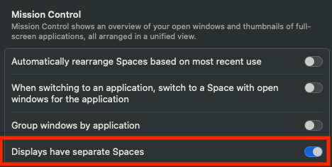

Updating an earlier post... to control whether the auto-hidden Dock appears on each display in a multi-display setup, "System Settings > Desktop & Dock > Mission Control > Displays have separate Spaces" must be Enabled:
I had this setting Disabled in Sonoma, which is why I wasn't seeing the auto-hidden Dock on each of my displays. Now with this setting Enabled, Sequoia and Sonoma Dock behavior is the same as expected.
