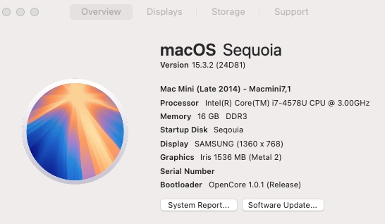

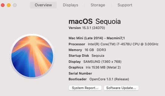

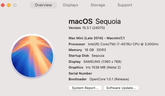

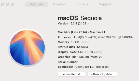

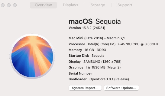

Ah I’m confused with the mid 2014 Mac mini I assumed was close to the mid 2014 MacBook Pro in terms of parts .
mini7,1.jpgCompare 🤷‍♂️

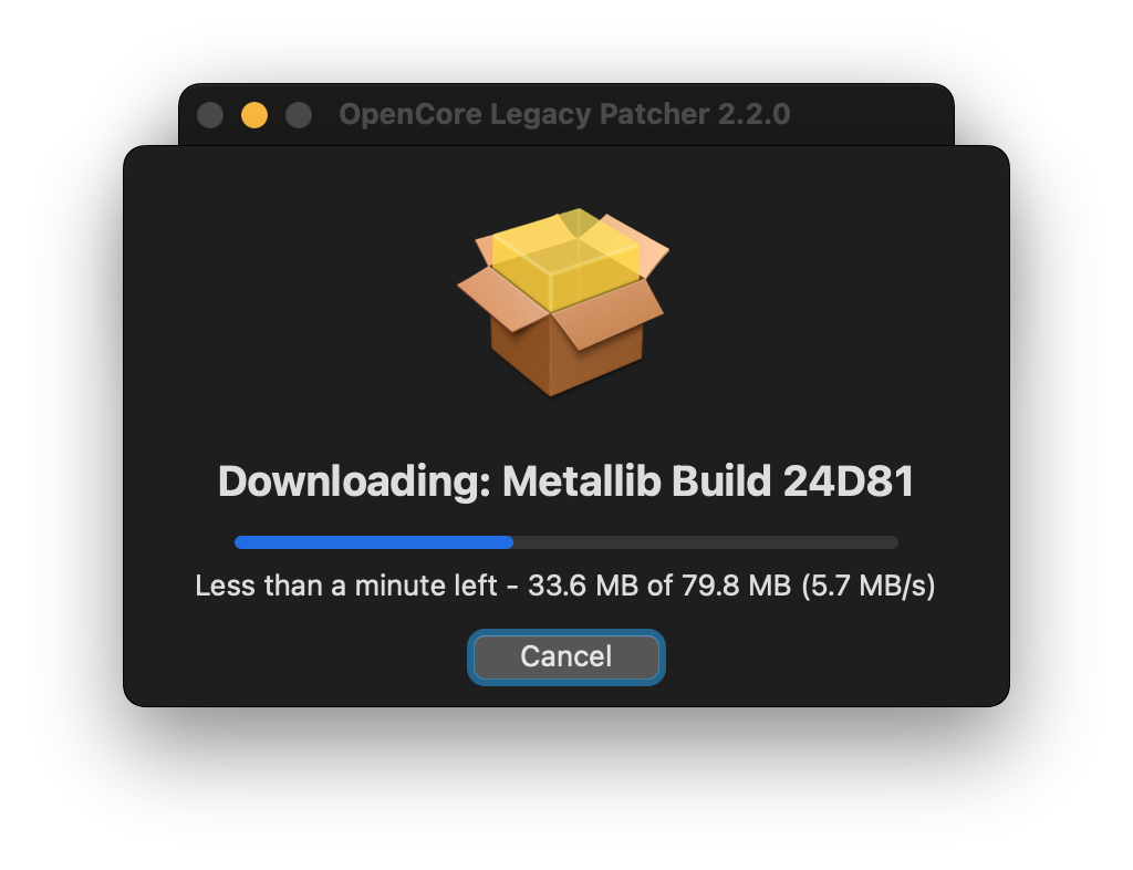

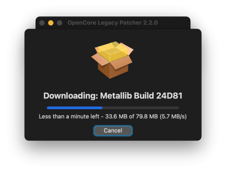

rMBP10,1 2012 updated from 15.3.1 to Sequoia 15.3.2 (24D81) + OCLP 2.2.0
OCLP auto-downloaded the Metallib new version when reapplying the post install root patches.
All is running well this morning for my current use cases.
MBP11,1: similarly positive experience.

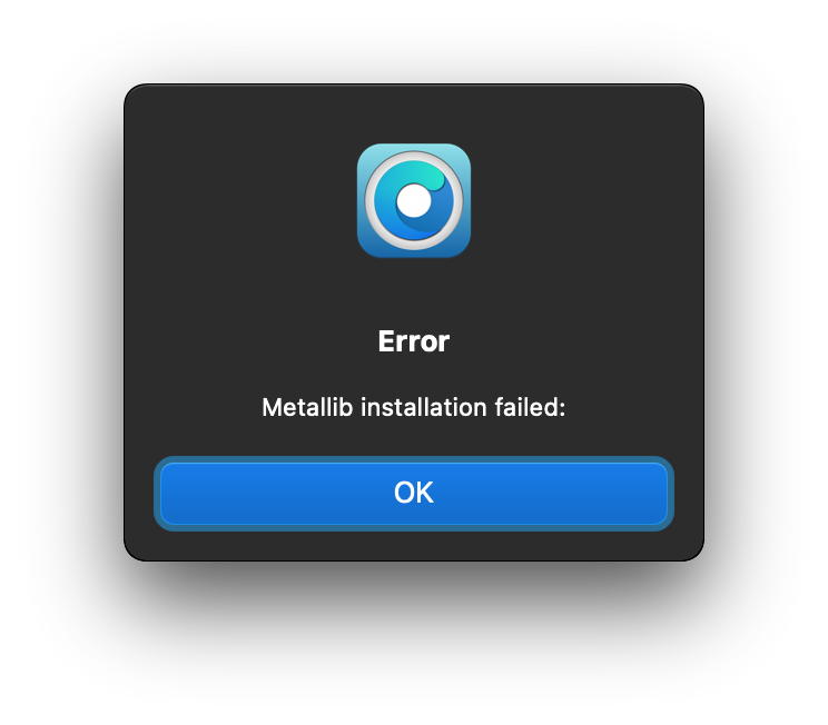

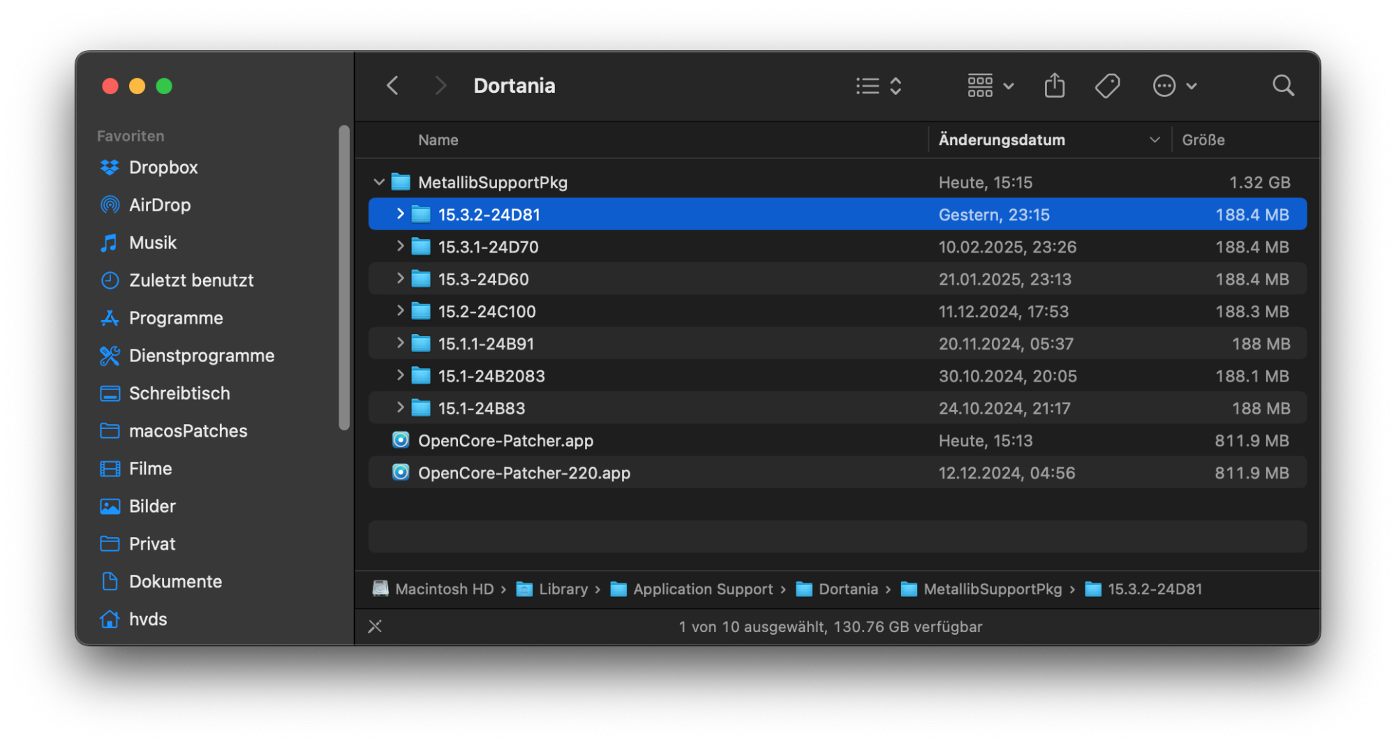

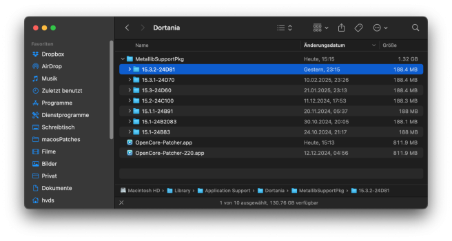

With OCLP 2.2.0, metallib installation first failed, while it worked well with 2.3.0n.
Then removed the latest metallib from /Library/Application Support/Dortania, and 2.2.0 loaded it again and its installation worked as well. Maybe a temporary glitch.
(Didn't look any deeper, just that the error message is produced in gui_sys_patch_start.py after the metallib installation thread finishes. For this see install_metallib at end of metallib_handler.py)
