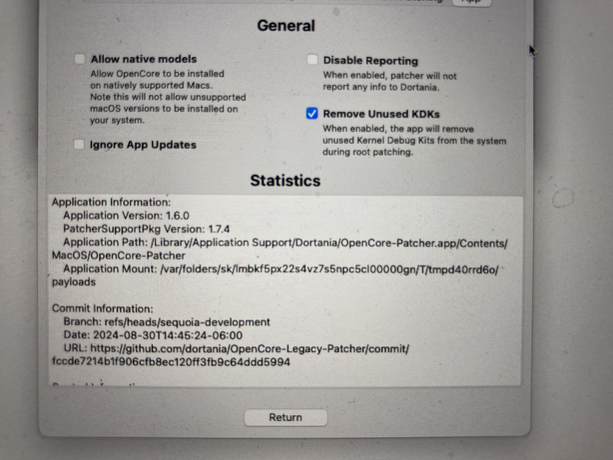

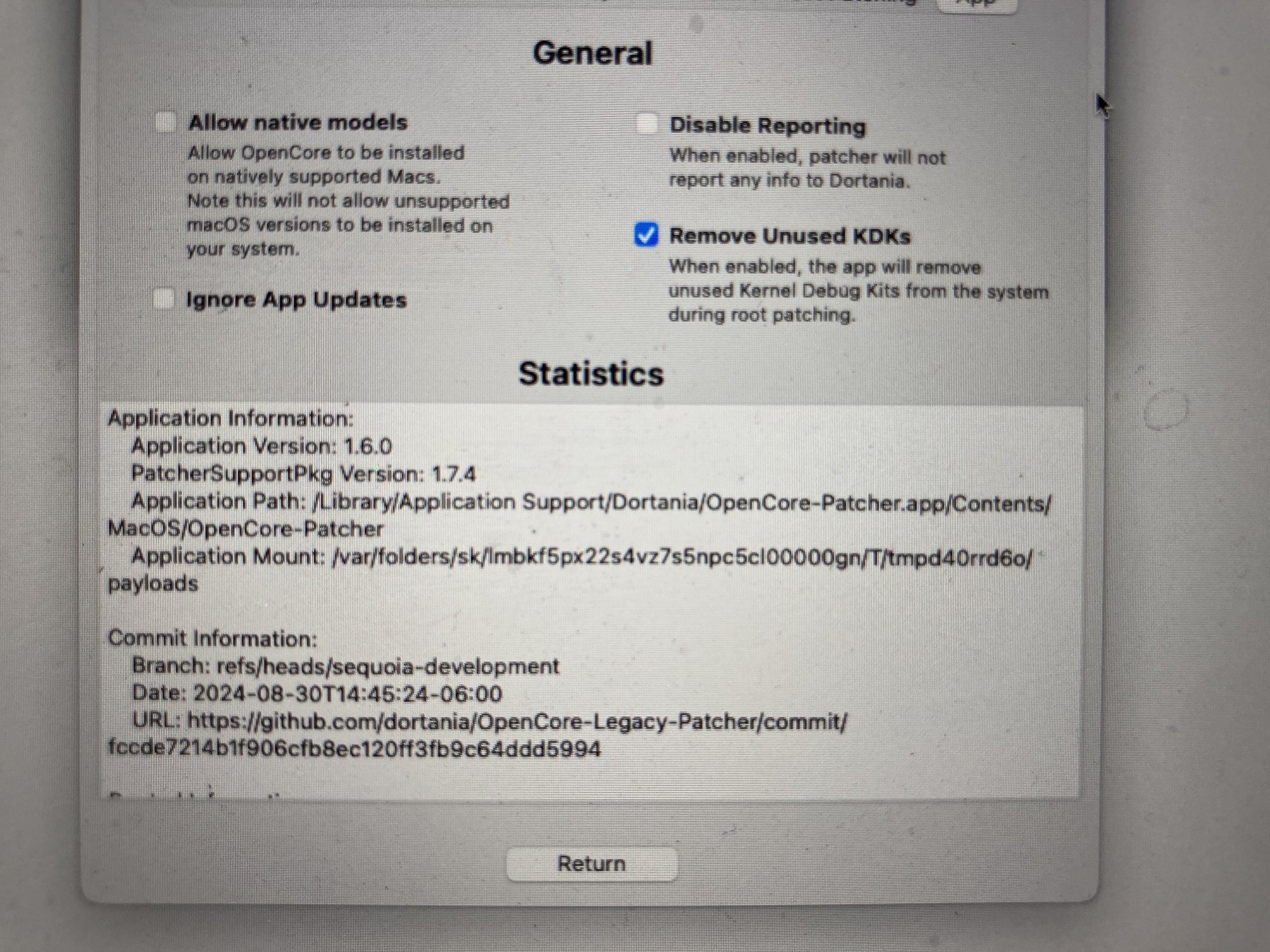

It seems that you use OCLP nightly from the main branch.
Sequoia so far has preliminary support only in the sequoia-development branch. Can use the branch selector in github, or just in the link to the nightly build you used change ../main/.. to ../sequoia-development/..
There may be more changes needed depending on your Mac model, see previous posts, esp. https://forums.macrumors.com/thread...unsupported-macs-thread.2428654/post-33352017

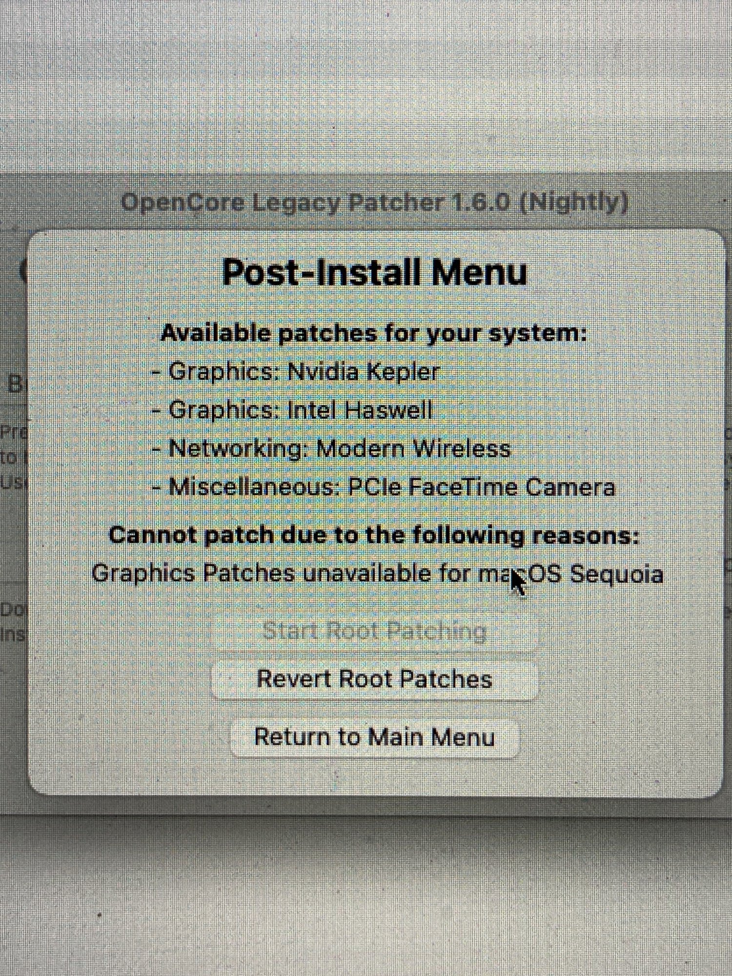

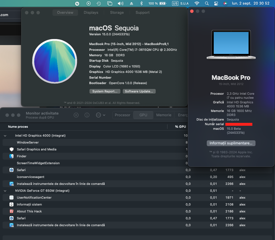

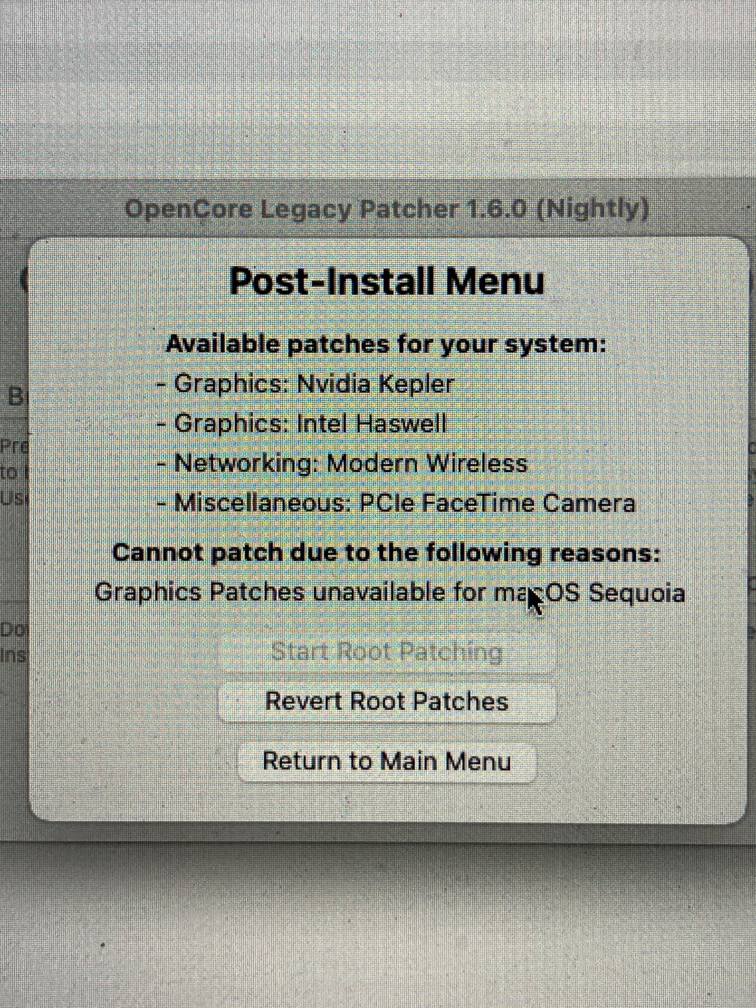

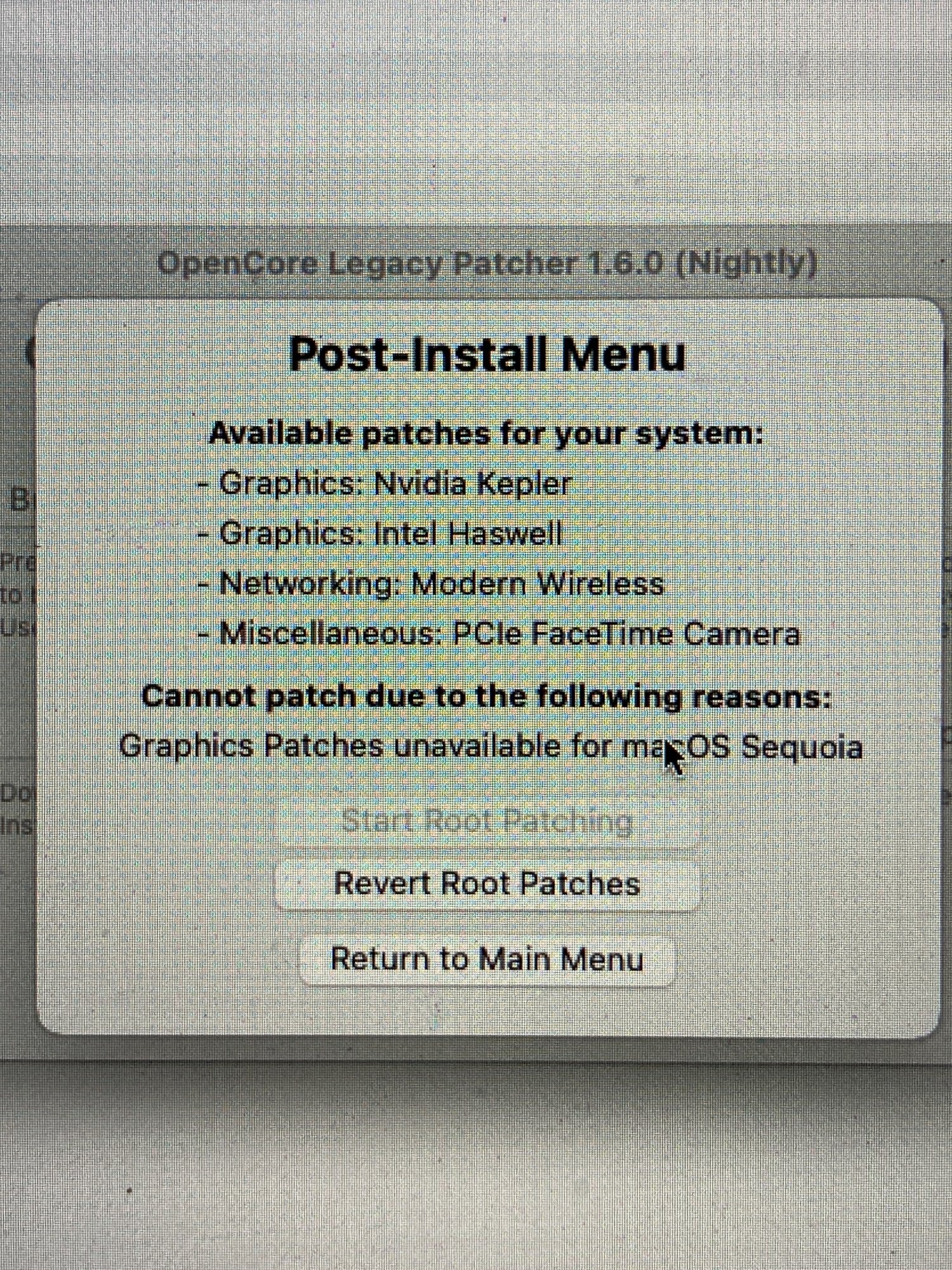

Nothing, I installed OCLP Sequoia development, but it gives me an error: graphic patches unavailable for Sequoia.

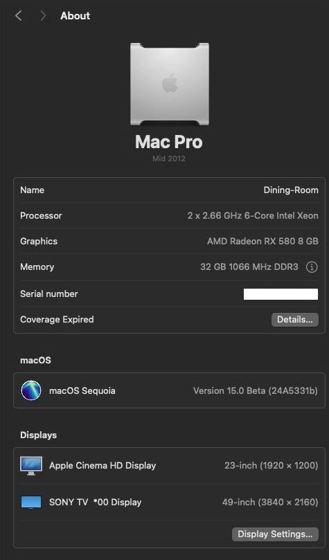

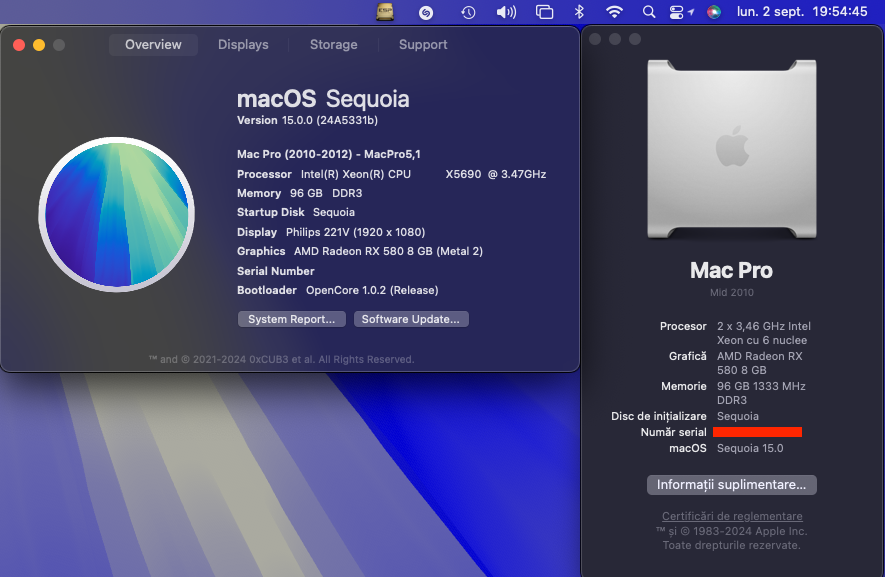

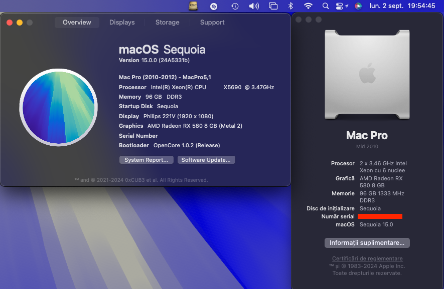

oh my oh my. 😁after sitting around, mocking about, fuzzing and swearing around all afternoon, i finally managed to run Sequoia Beta on one of my 10 cMP's with OCLP 1.6.0n from Mykola!!
It was really an gritty deduction method process. Had to do 2-3 install tries, off of different USB media, and I had to change SSD/NVMe between takes. I resorted to remove all my PCIe drives. and started all over a 3rd time. Actually an old Apple NVMe m2 taken from a thrashcan 2013 did the trick. 😅 NVMe sitting on a basic PCIe card in the other x16 slot.
BUT, the most odd thing occurred: I didn't have to root patch the system, at ALL!
Instantly all in, with full GPU acceleration. Never happened to me before...🤔
AGAIN: THANK you very much good sir Mykola and the contributors)!!
Spec: Mac Pro 5.1 2012, 48GB RAM, MSi Armor RX 580 8 GB, and full load on the PCIe lanes. USB 3.1 card etc
iMac 13,2 (late 2012) and Sequoia developer beta (up to Beta 8)
Out of curiosity: can you reproduce the same issue with the official app? I had exactly the same error in Ventura. That one was related to the installation/update process not being properly applied.

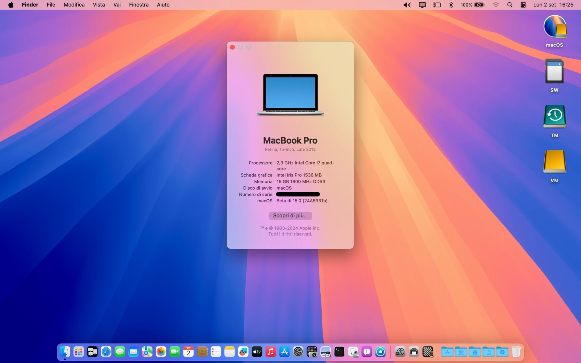

Mid MacBook Pro 2014 using latest nightly (that requires no modding or edits with Python) straight forward update to Sequoia and root patching amazing work by Devs on it issues me is green screen on videos e.g YouTube , Apple TV sound good no picture just green anyone else ? (Can watch YouTube in another browser ) still amazing work Apple Watch working fine with it too.

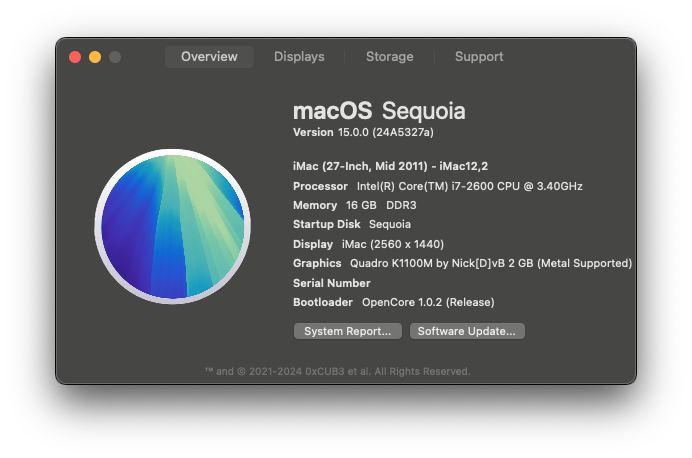

Extended support added for Metal 3802 based Graphics Cards!​
Urrà! Yahoo!!! Enjoy!

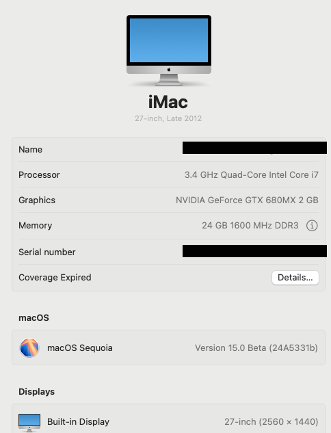

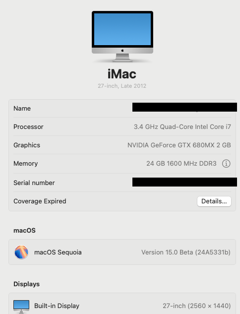

iMac 3,2 Sequoia beta8 and latest Sequoia development OCLP.
Achieved full graphic acceleration with latest(?) commit. Did have problems with Sequoia beta8 installation on an internal fusion HDD drive, where Catalina is also resident on separate volume (Catalina is the last native OS for the 13,2). However, conglomeration of data from posts by bosephus1, hvds, Sven G , jackobnicked2787 (last is reddit poster) among others, allowed full installation of OCLP (with all dependencies), and finally, a successful post-install OCLP patching routine. I removed DortaniaInternalResources.dmg from OCLP.app to allow error free installation on the internal Fusion HDD.
Just for the sake of comparison, I installed Sequoia beta 8 on an external SSD, which only hosted Sonoma.
The installation process of Sequoia and OCLP post-install patching did not require any corrective steps.
Incredible work by developers and testers.

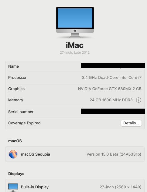

Imac 27 13.2/3802. After clicking one of the links referenced through #487 I believe it actually downloaded the latest 1.6n. After a couple of false starts when I went into recovery I was surprised to find that it offered to restore---Sequioa---. A big surprise. I clicked on that and when it finally finished OCLP asked to patch. I noticed a new very brief reference to ---downloading installing-metal lib- then the regular patching began. After reboot the background briefly reflected the forest I drove through once about 35 years ago the the previous background appeared. and every thing is working smoothly. I have noticed a new icon saying (iPhone Mirroring).
As I have said many times, thanks to the Devs for another pleasant experience.

Of course, with the latest OCLP for Sequoia developer nightly binary, it is not necessary anymore to create the ~/.dortania_developer file for 3802-based machines; if you have already created it, it can be deleted from the Terminal with: rm ~/.dortania_developer; and neither is it necessary anymore to delete the /Library/Application\ Support/Dortania/OpenCore-Patcher.app/Contents/Resources/DortaniaInternalResources.dmg file. Just the usual patching…
