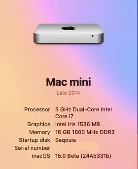

Ok. MBP11,2 and MM7,1 both working again with Sequoia RC and OCLP 2.0.0 (nightly). I can edit widgets, play video on Safari (Youtube). Netflix is very laggy on Safari, but works on Firefox.
Purchased movies on AppleTV work as well.
