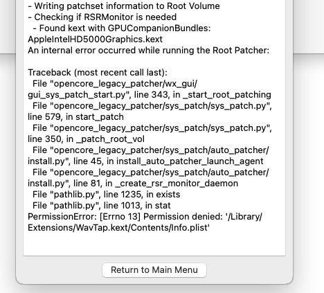

Good afternoon. Imac 14.2. OCLP 2.0.0.n Can't install root patches
Reactions: OKonnel
Do you get wifi already? I had exactly the same issue. I did reboot. Started in safe mode. First round running OCLP was installing WIFI. Then reboot again and run the patcher as expected.

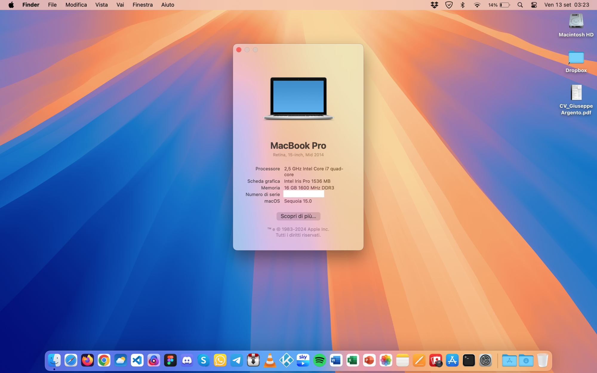

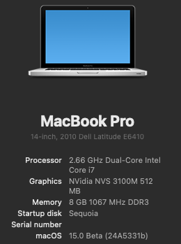

Mac Pro 5,1 (GT 640 GPU)
MacBook 8,1 (12" with HD5300 GPU)
Mac Pro 6,1 (2x D300 GPU)
...running fine with Sequoia beta and OCLP 2.0.0n patches.
THX devs!
(iMac 11,x without metal GPU does not hop over 21% prog bar completion in 3rd reboot phase when installing Sequoia. Will have to wait for further progress on the patcher side, I guess).

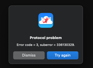

Good morning, everyone.
After updating to Mac Os Sequoia 15.0 I found an error code =3 suberror= 336130329 appeared. ( Protocol Problem ) with Jump Desktop for mac v. 8.10.08
Tried deleting and reinstalling Jump Desktop but problem persist. ( Also reported to JD directly, maybe no support for Sequoia yet )
I have an iMac 2013 14,2 running Sequoia 15.0 with latest OCLP 2.0.0
Everything else is running fine.
Regards

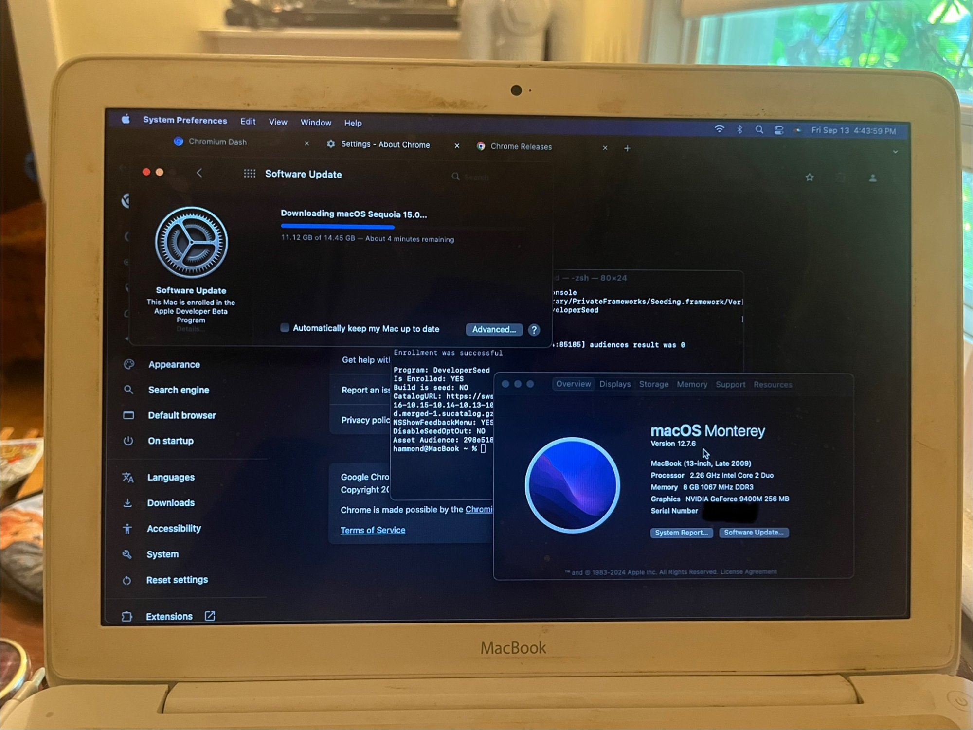

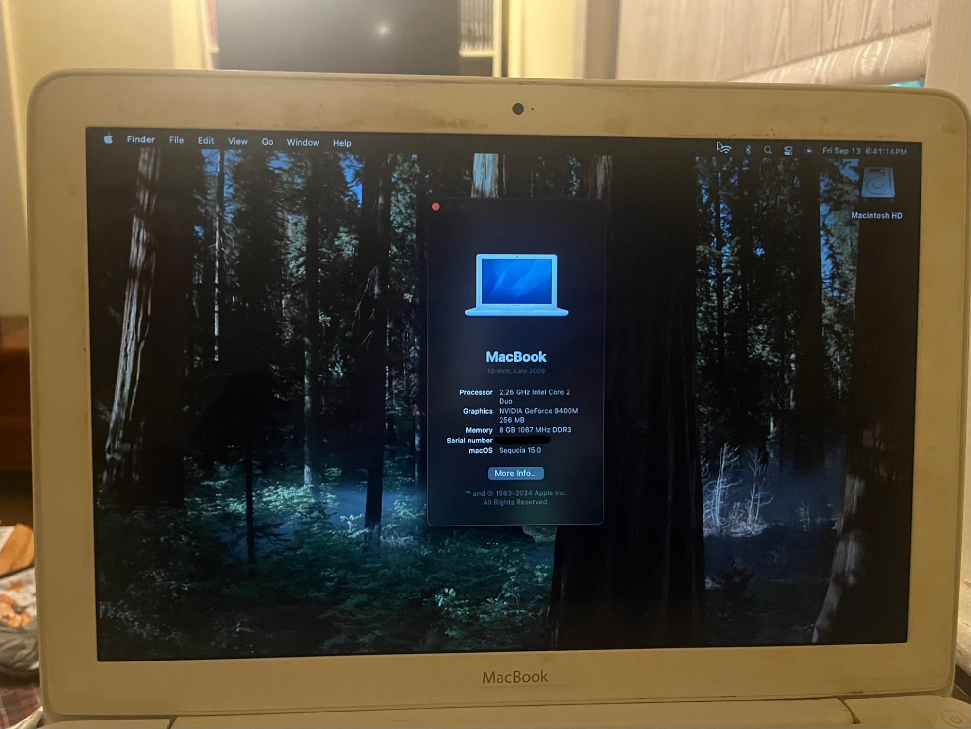

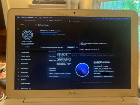

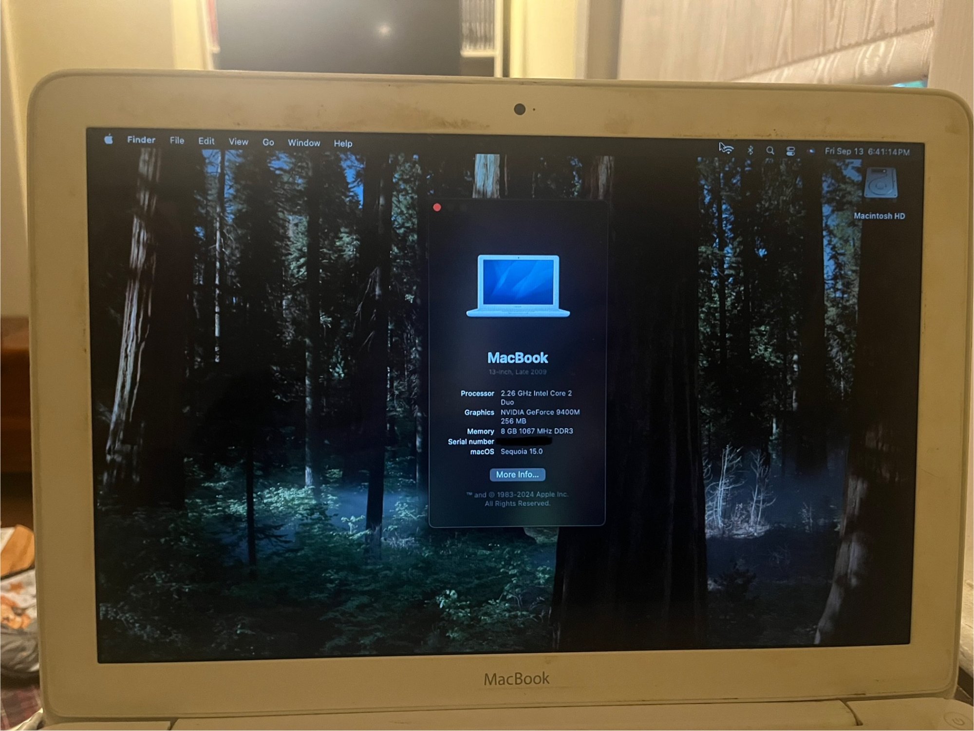

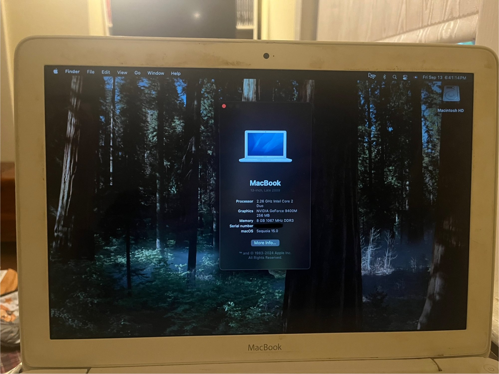

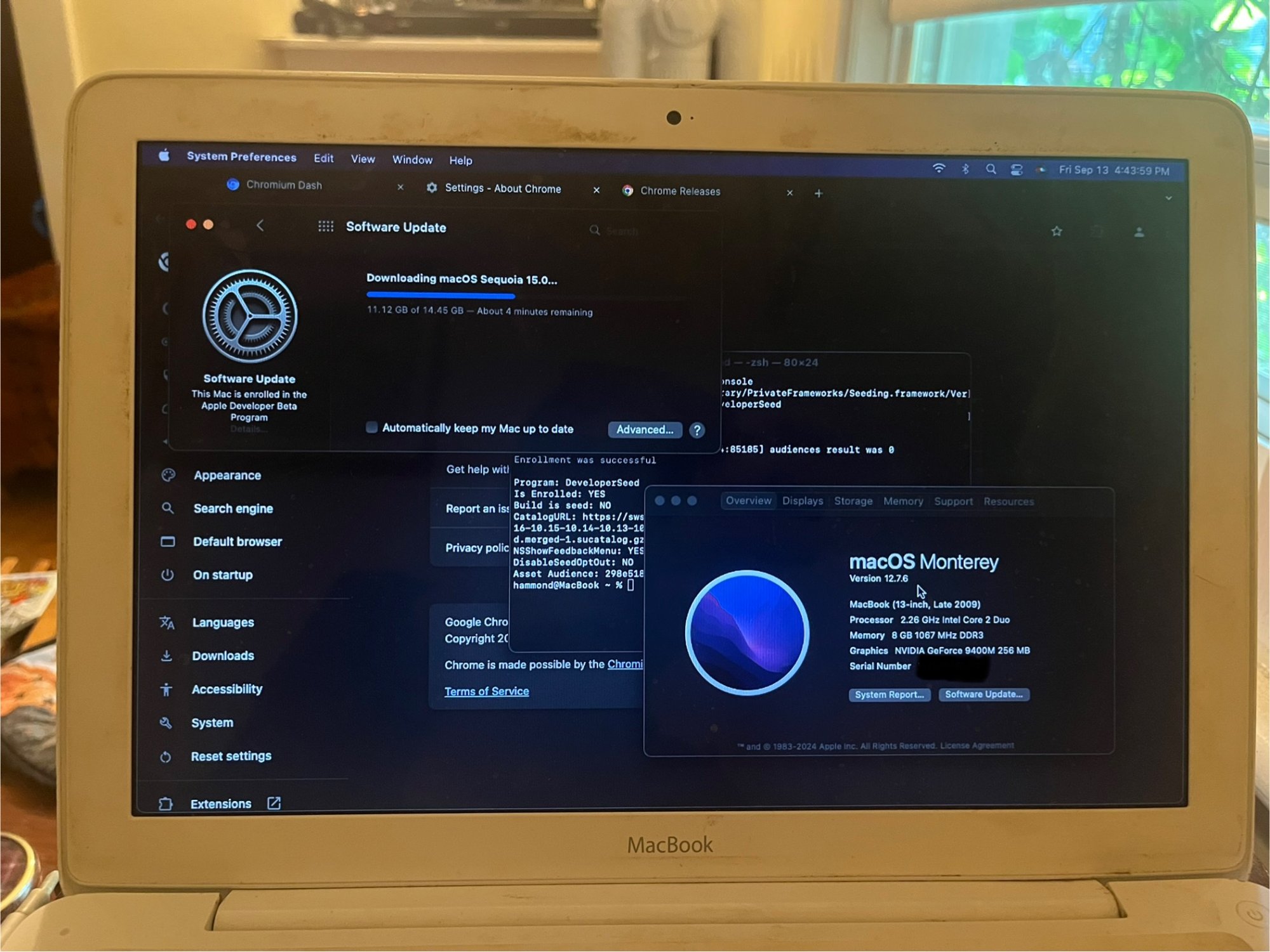

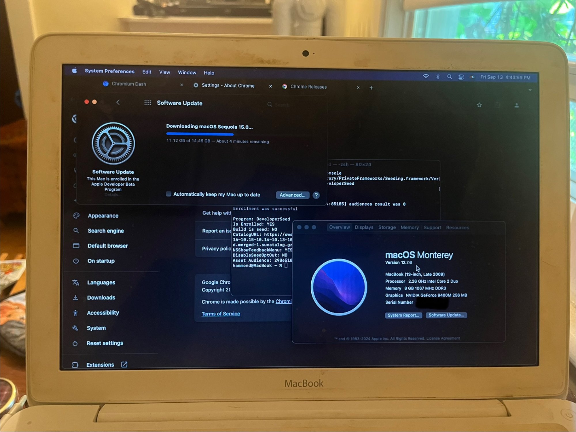

Just updated my old 2009 white MacBook to Sequoia after 3 years of running Monterey (Since August 2021, when it was in beta) now that it's (pretty much) officially unsupported with security updates. It has had some major hardware upgrades along the way, including swapping the old mechanical hard drive with an SSD in March 2022 and upgrading the RAM from 4 to the max 8 GB in January 2023.
