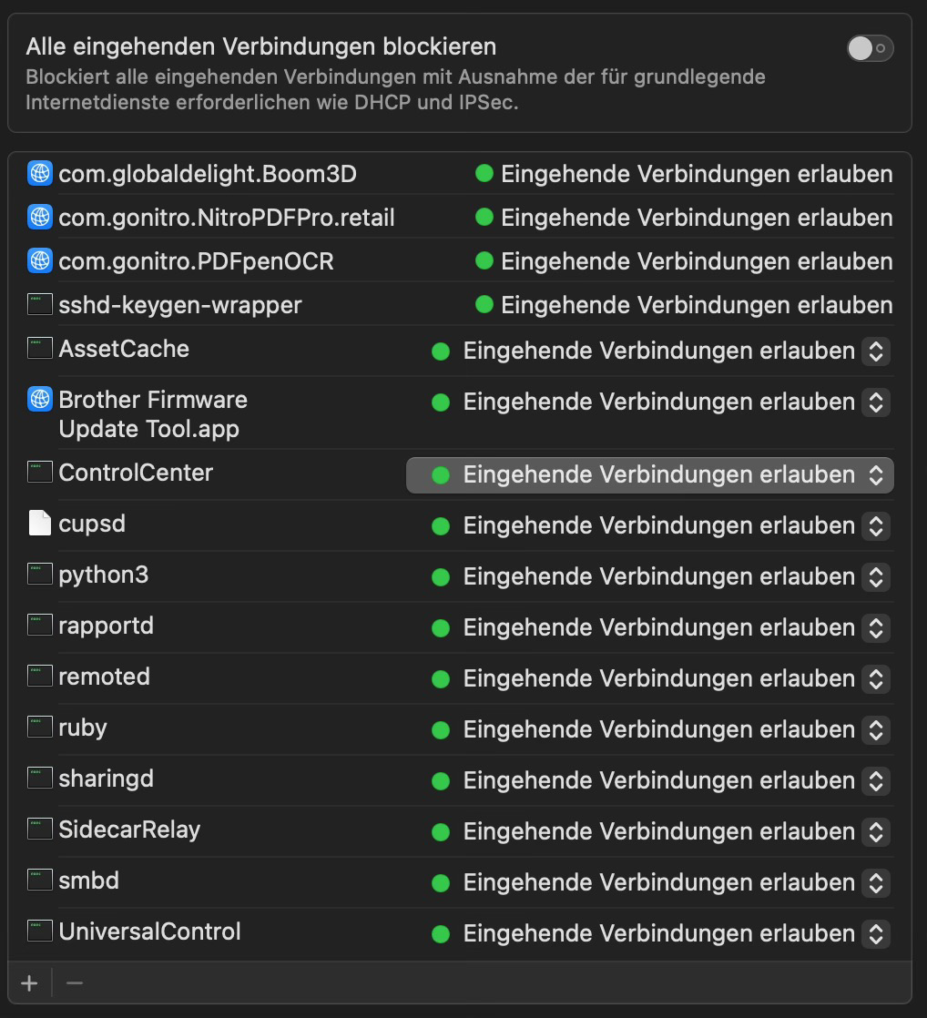

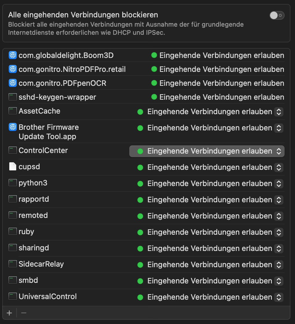

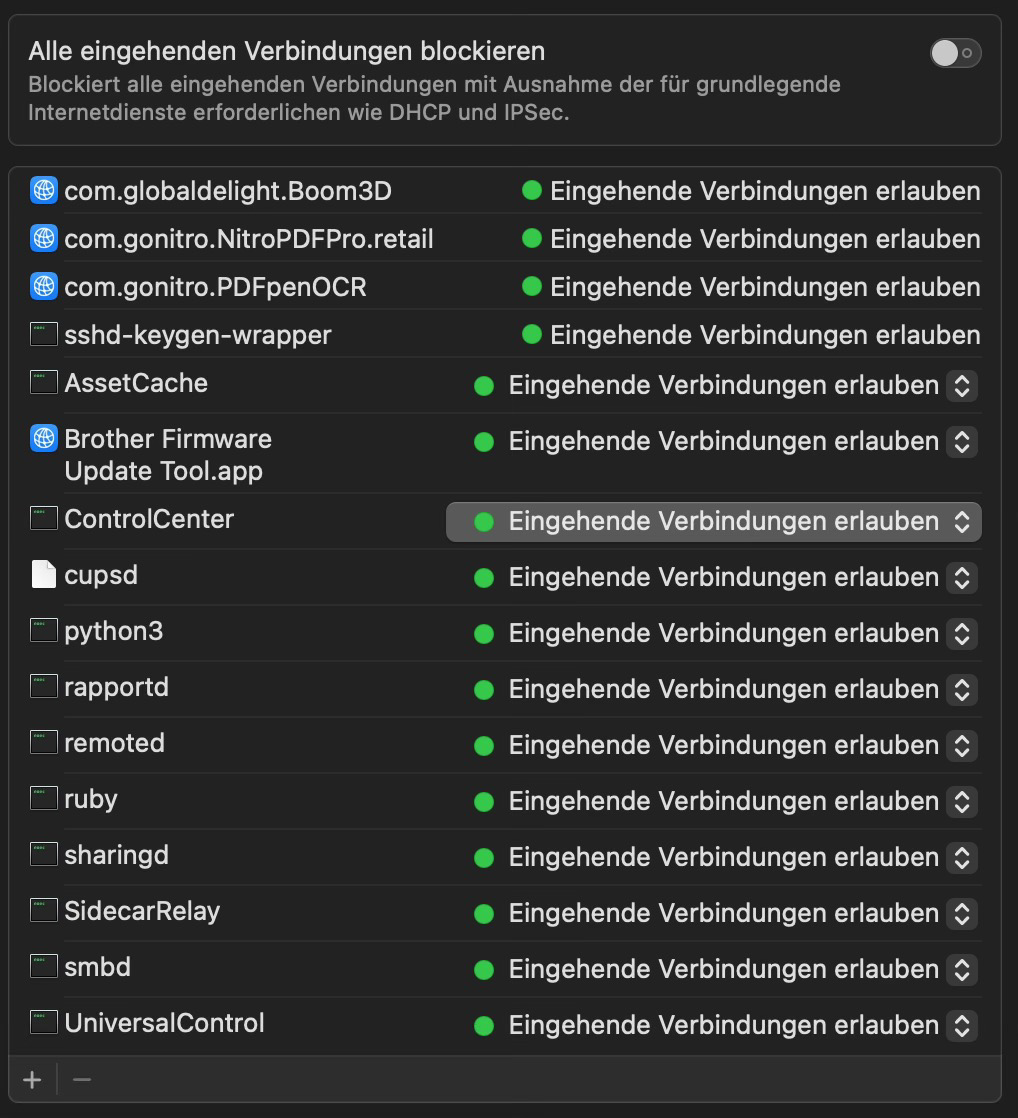

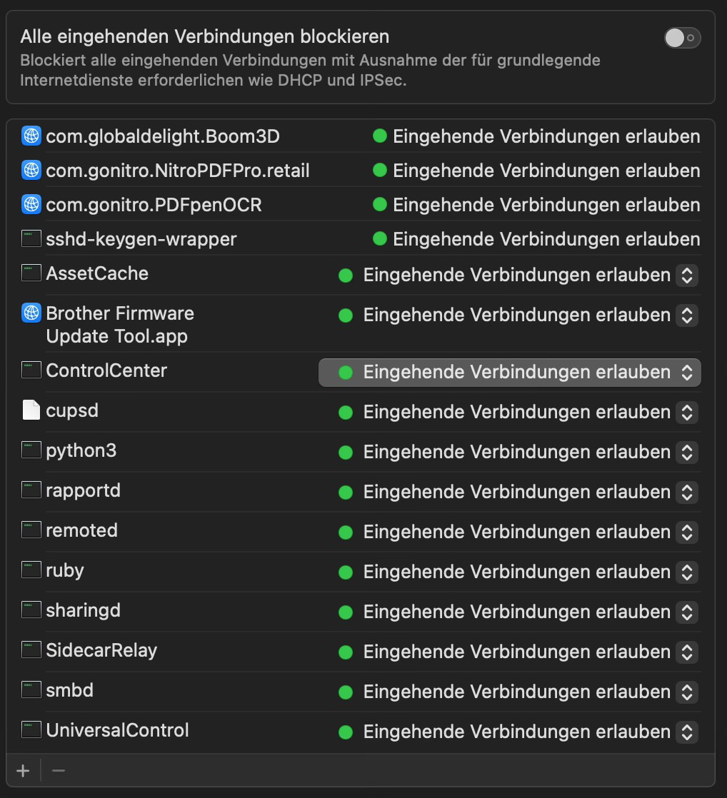

sshd-keygen-wrapper is macOS own process if sharing is activated - BUT there's NO sharing activated!?!
Any ideas ?
Reactions: coklicot01

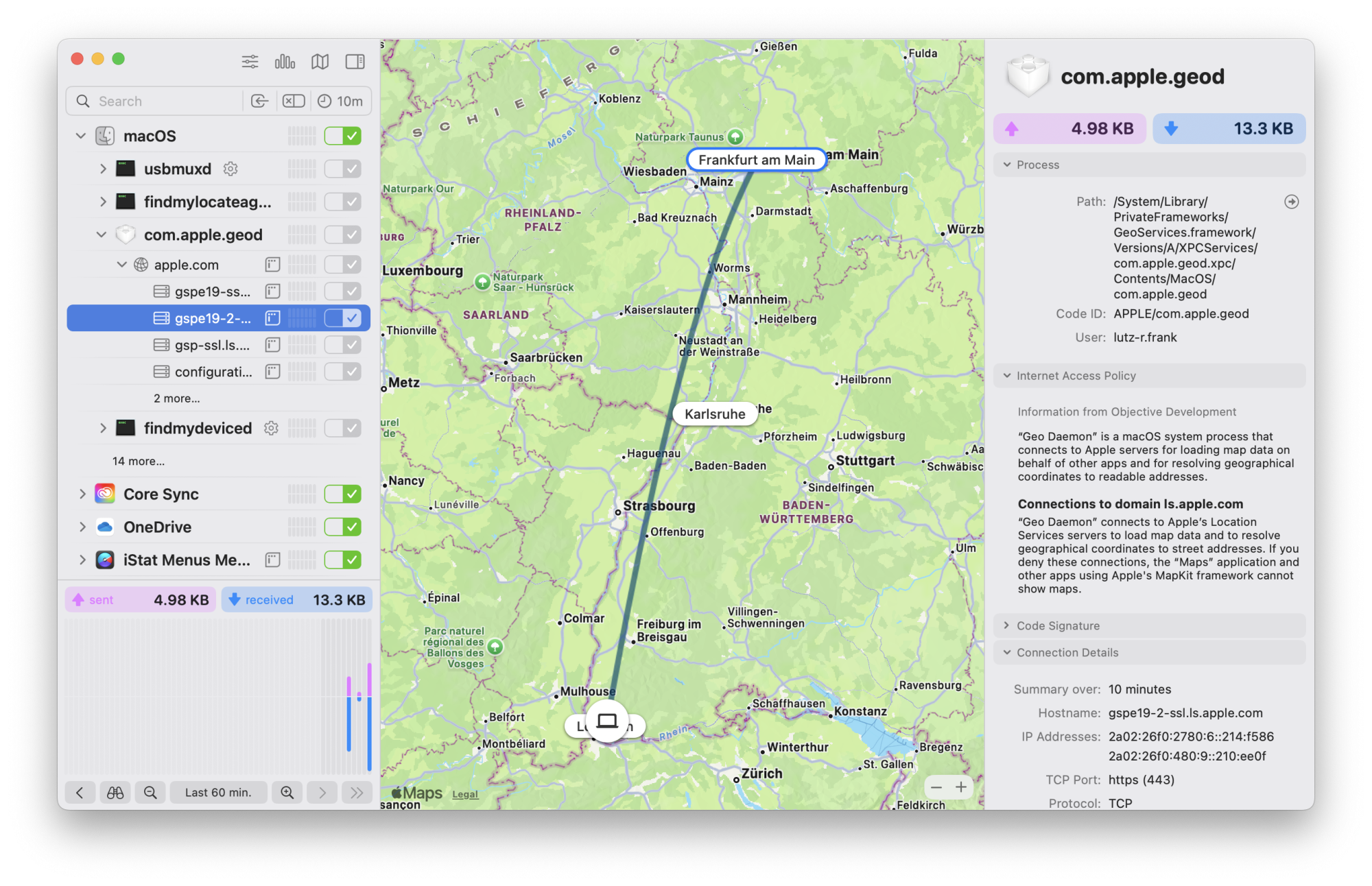

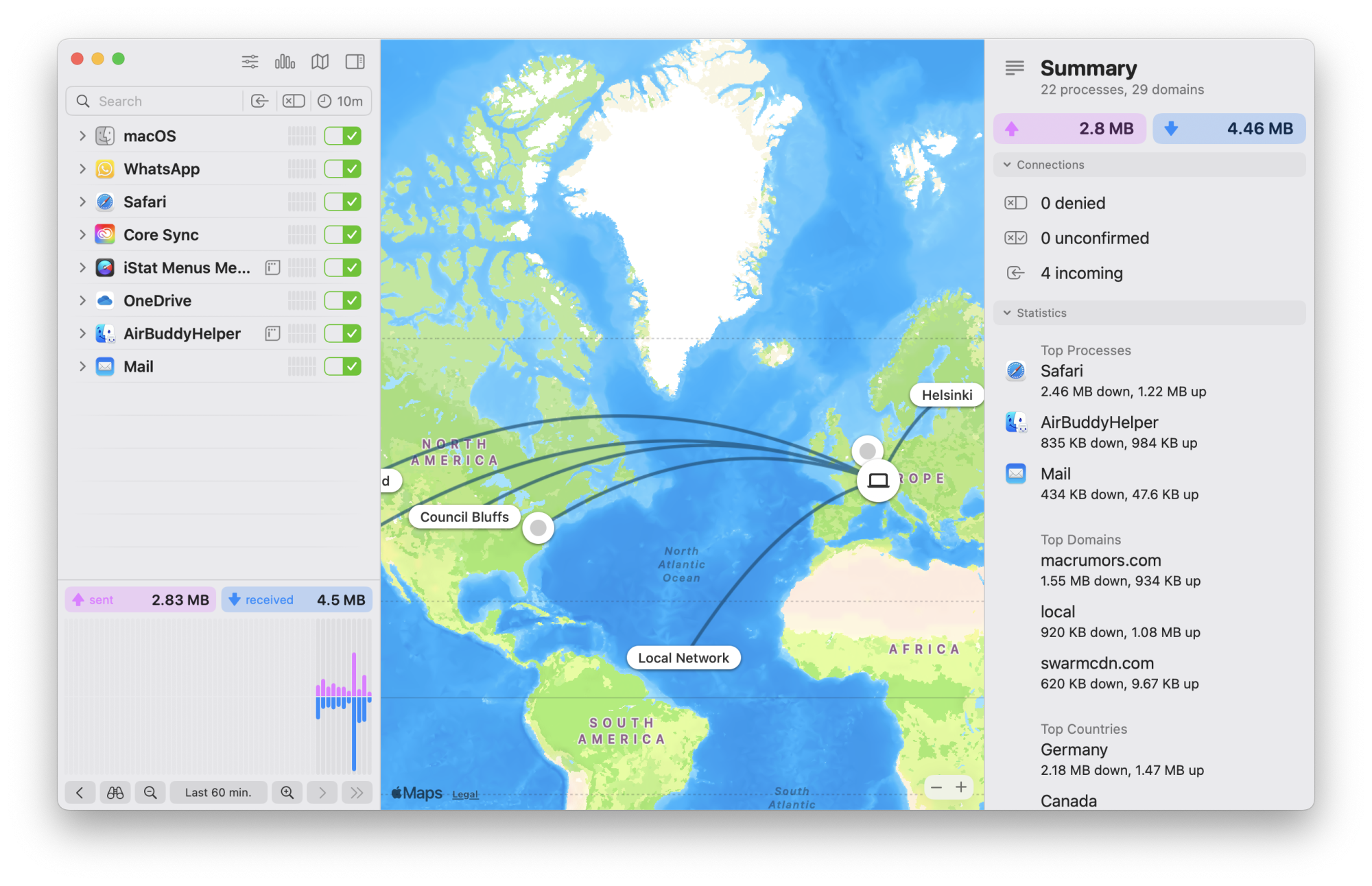

I use "little Snitch" as more flexible firewall - have it now for ages (starting version 1 - now it is in the 6th ...), can only recommend (not affiliated at all) to try out - you can dig down to the IP calling and the processes invloved

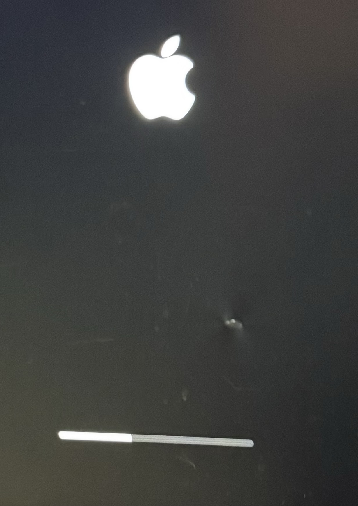

Can someone please help me
I can’t boot into safe mode but not normally
Mac Pro 5.1
In verbose it get to the end and then gets stuck at
I have updated from sonoma

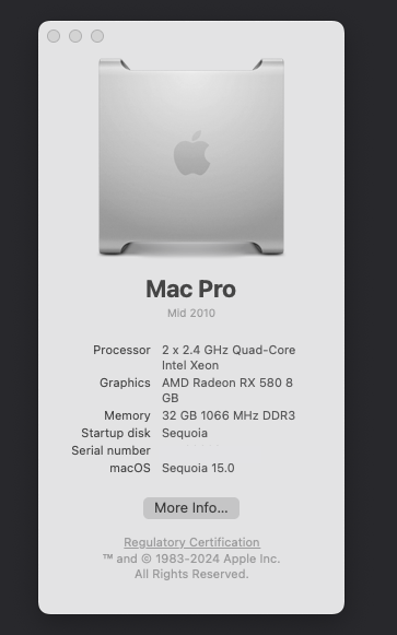

I have successfully installed Sequoia on my macPro 5,1 as in the specification below using OCLP 2.0.1
