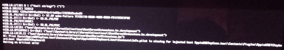

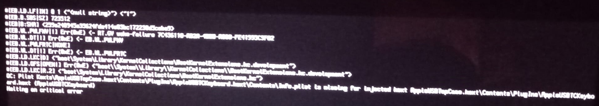

I have Sequoia running using OCLP on a 2011 MacBook Pro 8.2.
It won't boot and shows these messages in verbose mode.
I get the same messages if I try to boot from a USB stick moade with OCLP.
Apologies for the poor quality, I used my phone to photo the screen.
Any tips for fixing this?

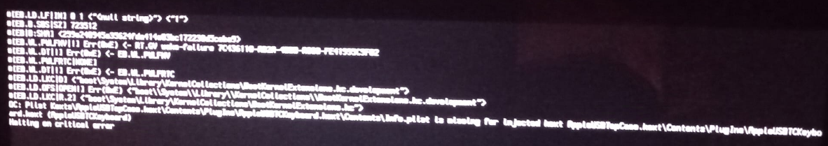

If I'm reading that right it looks like it's complaining about a damaged kext. I would think if your USB installer is good you shouldn't have that error booting from it. If it were me and I was sure I was getting that error from the USB install stick I would build a new one on a different USB stick and try again. Installing over the top of the existing install should work unless there is a problem with the drive in the MBP or some other hardware issue going on.
The weird thing was that I built the USB installer on a different Mac but got the exact same error. I will try again and see if I get the same error... The Ubuntu partition still boots and runs fine.

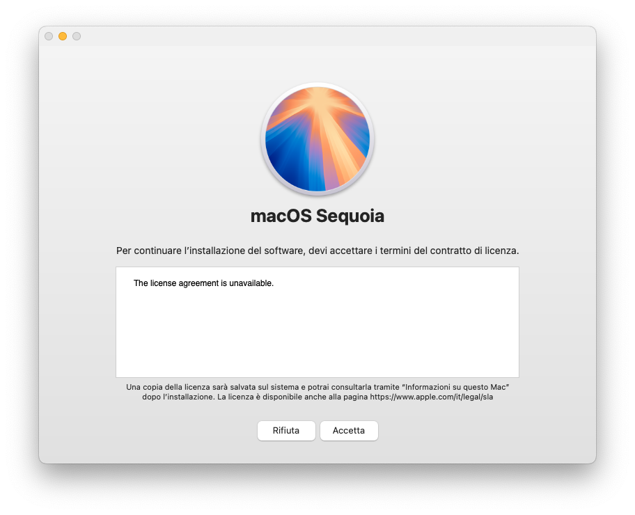

On my MBP11,3, license agreements are not displayed, whether from full installers or software updates; while on my MBP11,1 (without discrete graphics), they are displayed: anyone else has this problem…? Here’s a screenshot of the full macOS 15.0.1 installer: as can be seen, no license agreement is displayed. Maybe something to do with the Nvidia Kepler card (even if the same happens also forcing Intel Haswell)…?
Kepler
… The same also for paravirtualization (i.e., accelerated graphics in macOS 11+ virtual machines) in Sonoma and Sequoia: it would be great if it could eventually work; but of course we don’t know if this is even possible, currently.

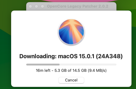

A simple update to macOS 15.0.1 is enough or I have to use OCLP 2.0.2 to create again a USB Drive with macOS 15.0.1 ? What is the process ? Kernel Debug Kit 15.0.1 build 24A348 is necessary ? Th@nks.

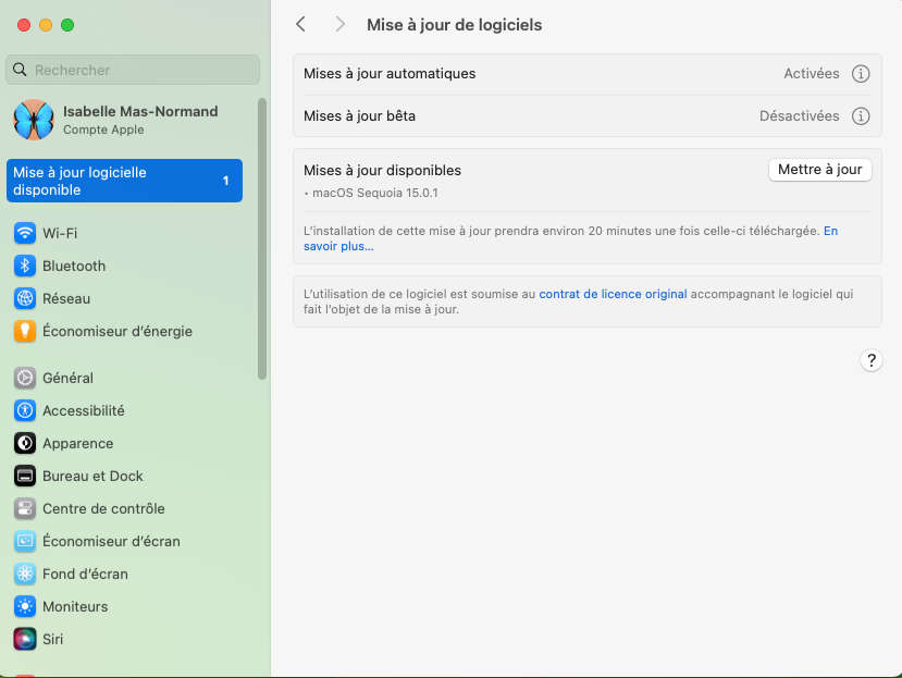

MBP 2012 10.1. Latest 2.02 patch, Trying to update to 15.01 OTA. Software update finds the update, after a few minutes "checking for updates?. The settings on the toolbar has the red (1) indicating there is an update. It takes a while but gets me to the Available updates where I click on "Update Now". - I am able to click on the "Update Now" and see the button respond to the click. But nothing happens, It does not continue.
The internet (wiFi) is fine - I can browse and speed test exceeds 500 mbps. I did try safe mode, but no update is found on safe mode,
What could be preventing the "Update Now" from continuing. (I have patiently allowed 30 minutes to start). After reboots, same behavior.
Exactly the same problem with the same MBP.
In fact it was the same when I had Sonoma and Sequoia would not show up OTA update.
Eventually, resorted to Terminal and used the softwareupdate command to instal Sequoia 15.0.
Looks like need to do the same with all future updates :rolleyes:
Something clearly not quite right with the MBP10,1.
Hard to diagnose with that minimal screenshot / data. If I had to guess, I'd say you need to use a different USB thumb drive (e.g., if you are using a USB 3.0 thumb drive, switch to USB 2.0).
