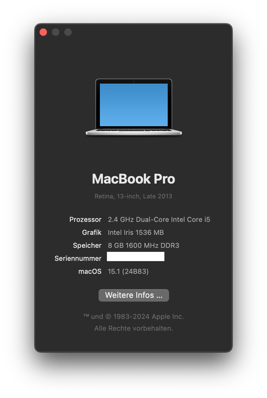

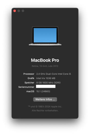

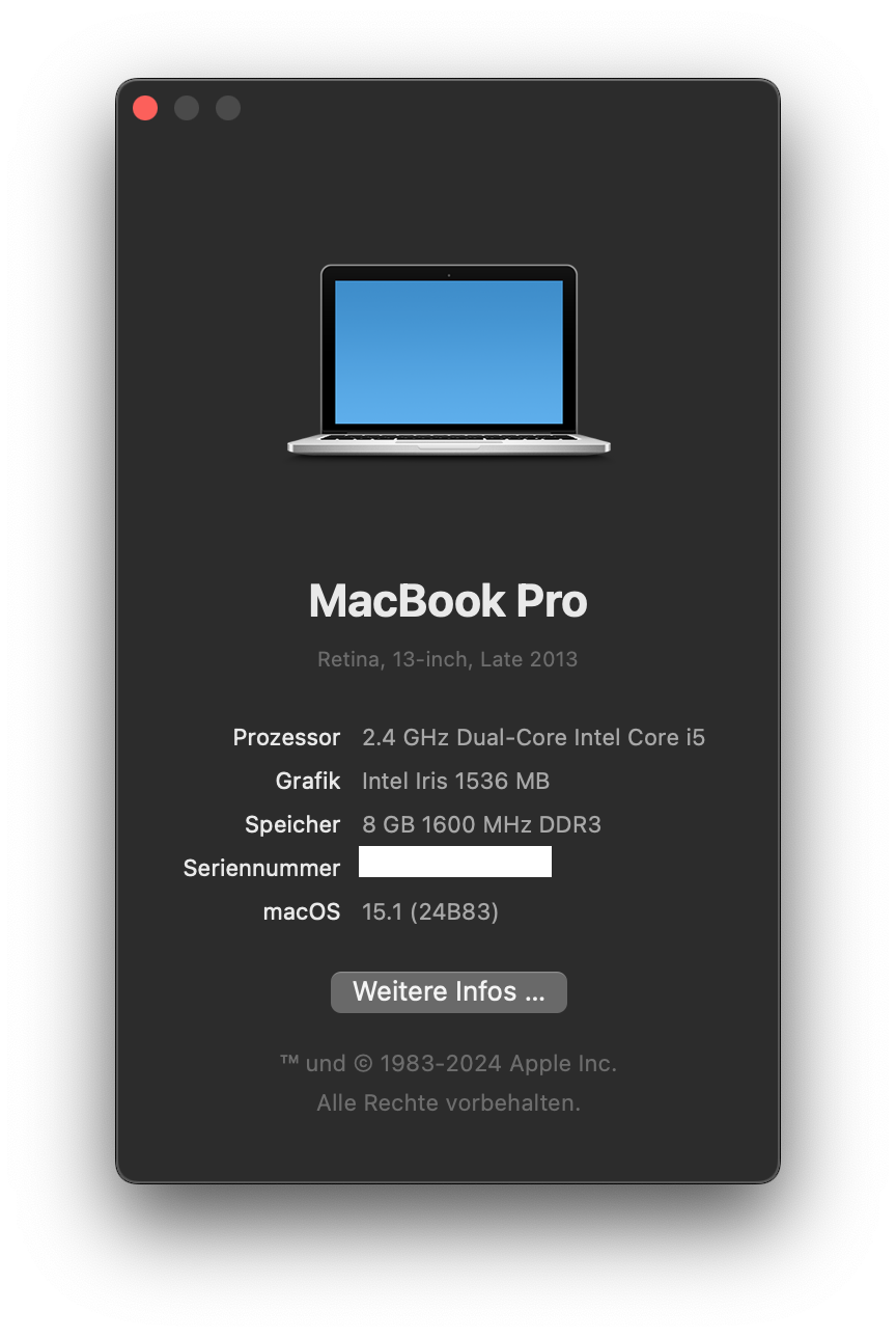

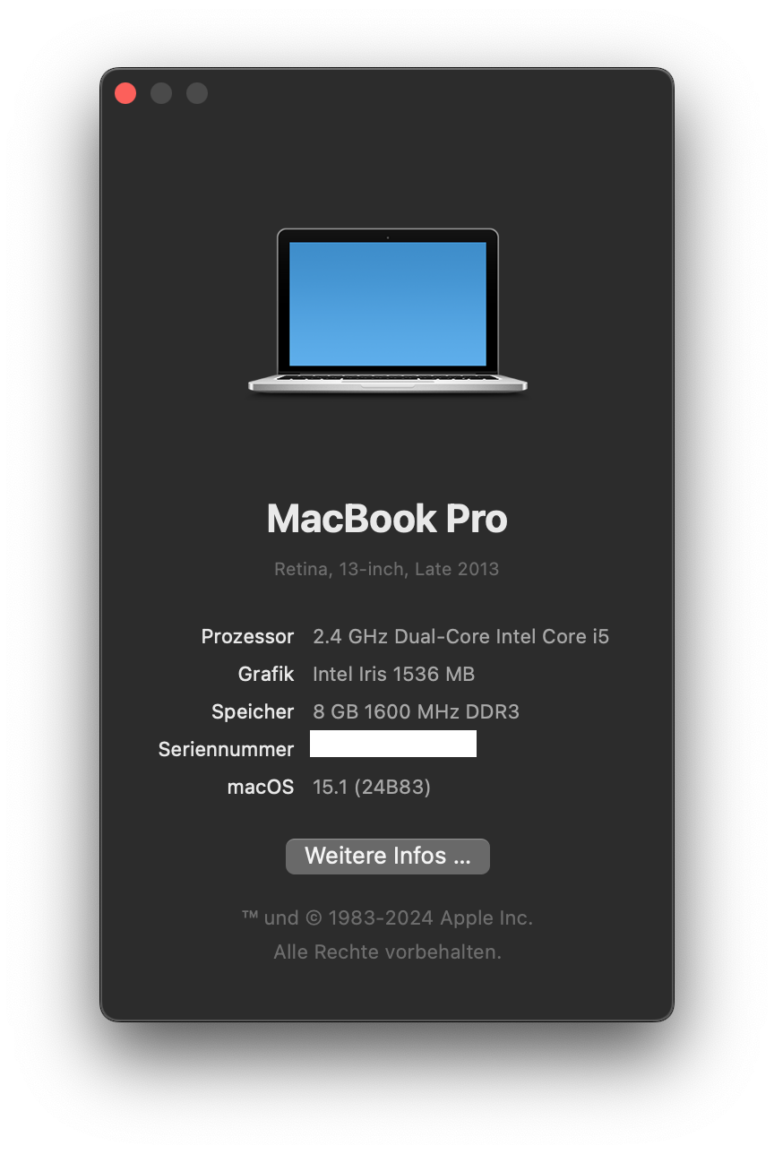

Finally installed Sequoia 15.1 / OCLP 2.1.2 on the internal SSD of my MBP11,1. After much testing on external SSD.
It will be my work and travel companion for at least another year.
Thank you OCLP developers for the professional work.
