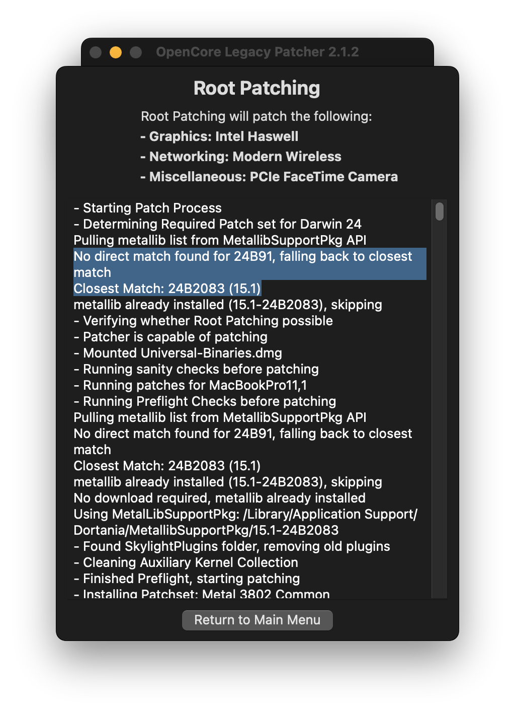

MBP11,1: fine with 15.1.1 / OCLP 2.1.2. Installed from USB installer to internal SSD.
(For metallib, the post-install patching picked 24B2083 which belongs to 15.1 for the M4. Seems OK.)

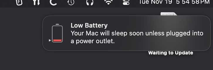

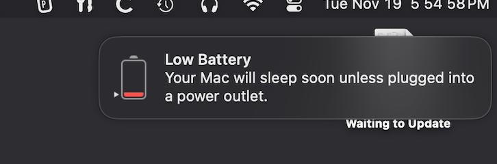

Ok, I tested on my MBP11,2.
It does not power down, it goes to sleep because of the low battery (bad battery I assume). I also have a bad battery, but it can keep my Mac awake for around 5 minutes after a reboot.

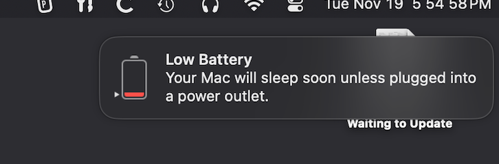

I haven't noticed this behavior with my mid-2014; When I unplug it, It does not power down. Same as macpro_mid2014, when the battery is low, it goes to sleep (with notification).
However, I did have the battery replaced about 3 years ago at Apple Store.

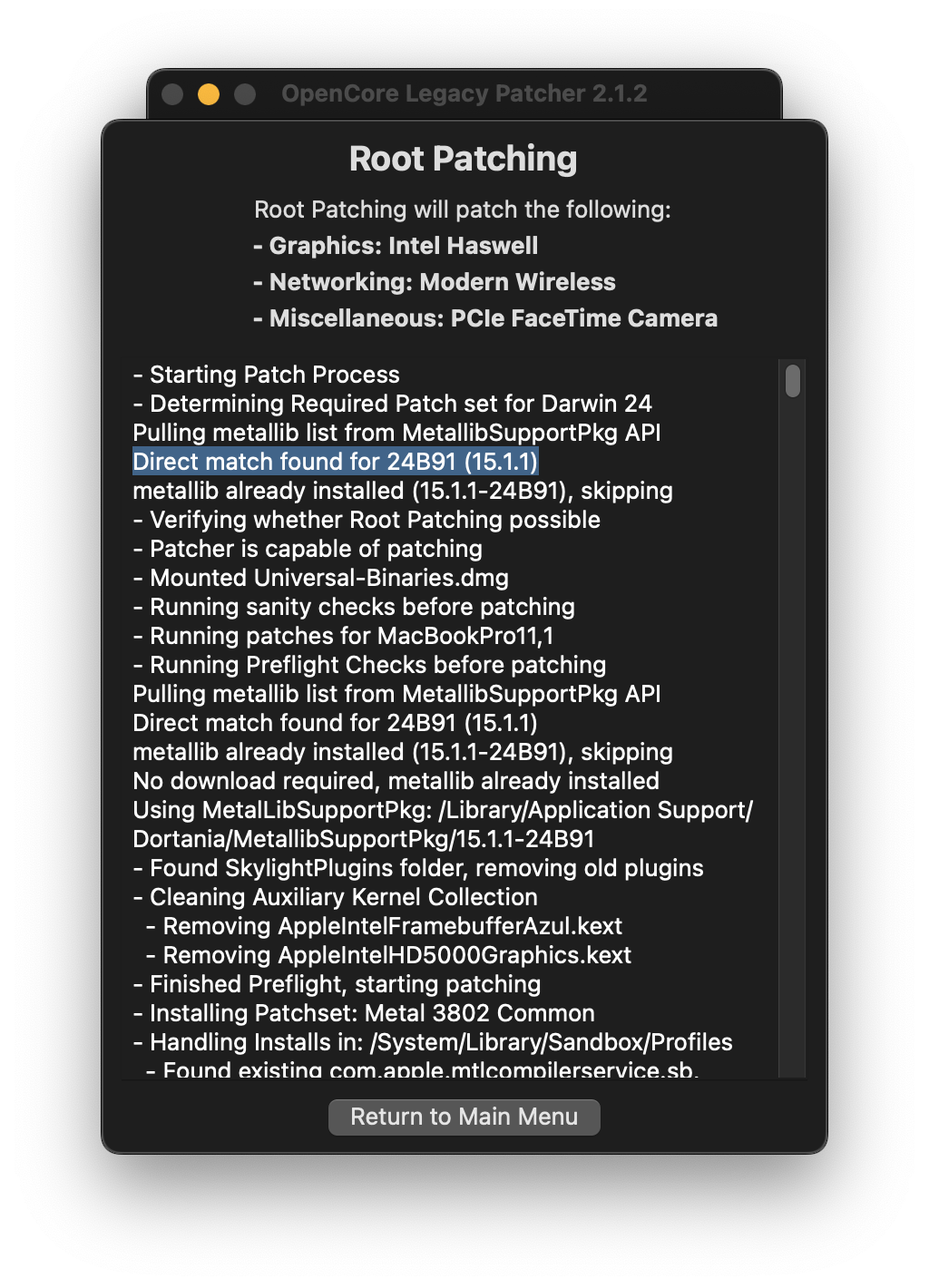

Repeated the post-install patching. The directly matching metallib support package (24B91) is now present and used.
No difference noticed to 24B2083.
