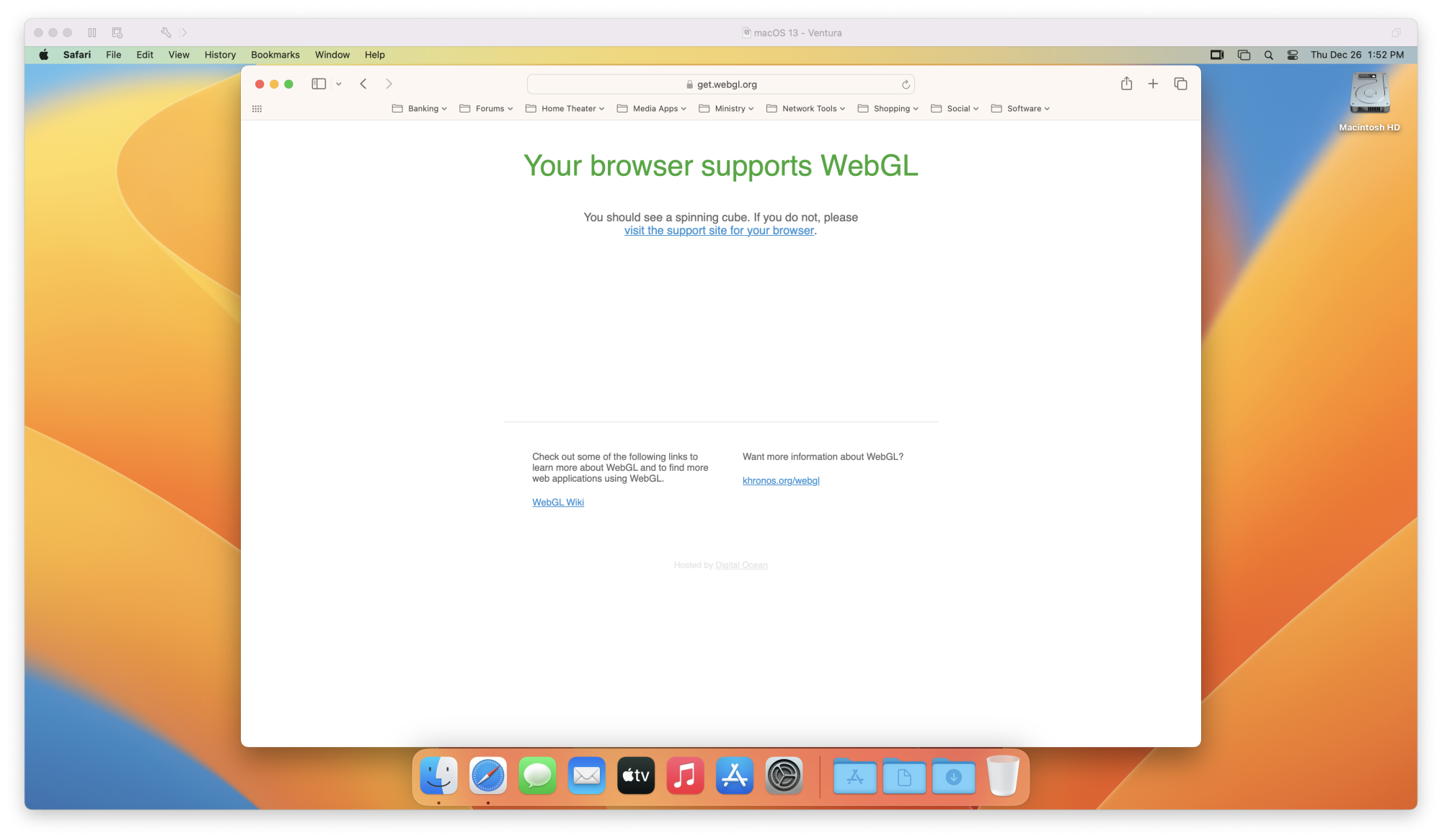

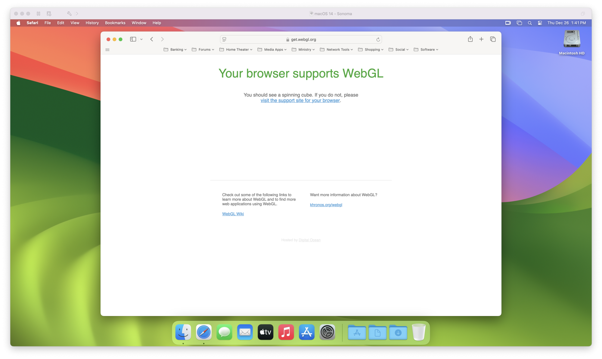

EDIT: Looks to be an Apple issue, not OCLP. Based on the results of going to get.webgl.org in my Sonoma VM. It worked with the spinning cube under safari 17.6 and Firefox 133.03 under Monterey, and it even says Safari 18.2 supported it, but no spinning cube. Same Results with Ventura + Safari 18.2

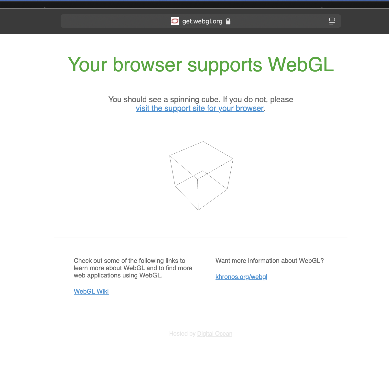

For what it's worth, this is what I see on Safari 18.2 on my 6,1 Mac Pro, Sequoia 15.2 and OCLP 2.2:

If the cube was rotating, then it means WebGL is working for you.
Indeed it was rotating. Having read the posts above, I thought I would just try it, and although I can't say why it doesn't work on supposedly supported browsers as you pointed out before, but it seems just fine here with Safari 18.2.

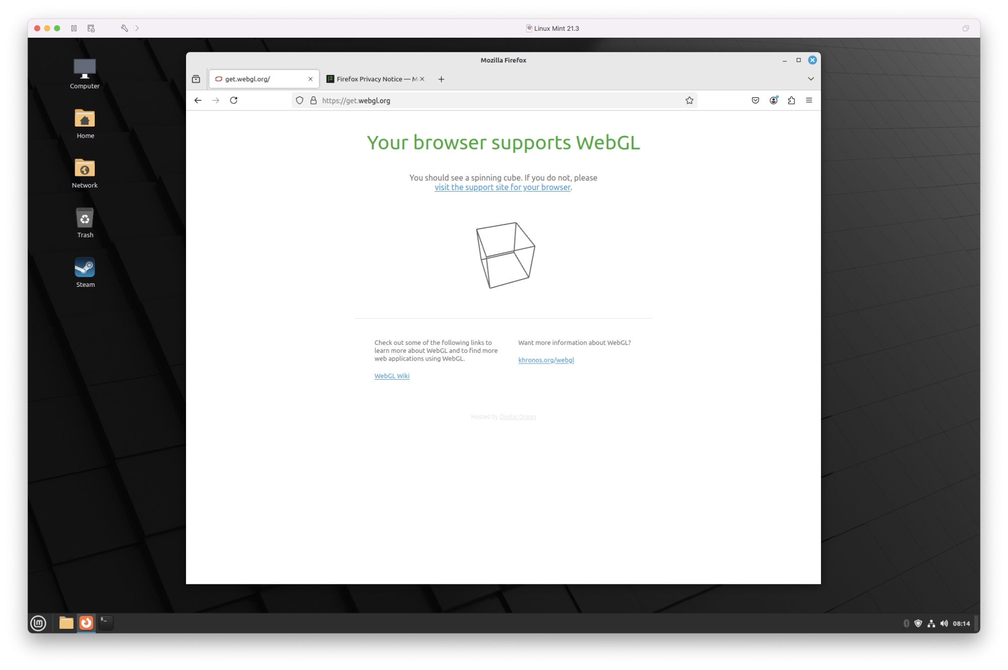

I'm double checking stuff here. I installed the latest Firefox into my Sonoma VM, and the WebGL site wasn't working in that either. So wondering if macOS VMs are limited, or have to change settings in the browser. Everything works in the host. Will check a Linux VM. Like I said, a macOS VM should be considered a supported config over OCLPP, but I've never looked at this particular problem before. I do know some software is limited in a macOS virtual machine, but I've only found that to be the pro apps from apple at this time.
EDIT: tried Firefox under Linux Mint in a VM just for a FYI: and it worked. So, either I encountered a limitation of macOS VMs (even with paravirtualization enabled) that I wasn't aware of, or there are bugs / configuration issues.

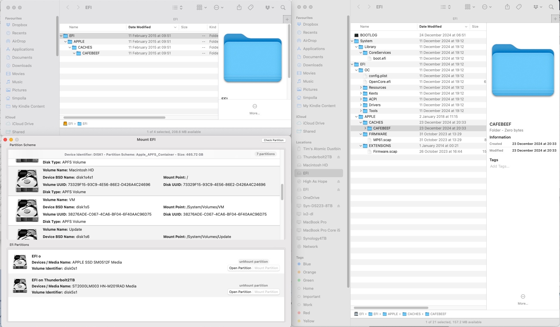

Following another thread I have used Opencore Configurator to Mount EFI and I can see that the two partitions (on my internal SSD and the external drive) are as expected - see screen shot.
When I look inside the two partitions I see the internal SSD having a file structure containing various files, whereas the external disk EFI partition just contains four folders nested inside each other with no content. So whilst I could delete this, it is hard to see how this is causing my problem - so I am a bit stumped. There doesn't seem to be the option in the configurator to delete the EFI partition.
Can anyone tell me how to get rid of this unwanted partition please?

BTW I have tried backing up the external HDD then erasing it in disk utility, but the unwanted partition is still there.

So I have tried various things to fix this annoying boot problem. I eventually reformatted the external drive as MacOS Journaled using MBR instead of GPT, which eliminated the EFI partition. I have checked and the EFI partition is definitely gone. So now I have an external drive with just the one normal data partition. But OCLP still won't boot if the drive is attached. I can plug it in as soon as the progress bar shows normal boot, and the system then behaves fine. I have tried rebuilding Opencore and applying patches with the newly formatted drive attached but it will still only boot if I remove the drive. I guess that something in my Opencore configuration still refers to the EFI partition of the external drive, which causes the hang even though it is no longer there.
Is there any way of editing the OCLP configuration to find and remove this, please? I have hunted around in settings but can't find anything that looks as if it does this.
