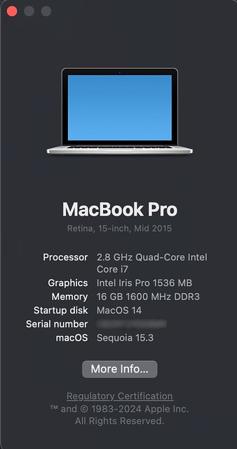

No issue on my MacBookPro11,2 with Sequoia 15.2 + OCLP 2.2.0.Anyone else have this predicament?

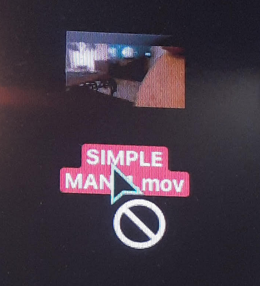

That's weird. I just bounced a file in Pro Tools (.wav with 2024.10.1 on Sequoia 15.2), I can drag and copy with no issue to any usb drive or stick. I've never seen something like that... Maybe some permissions problem? Have you tried bouncing it to a different destination?I've recently noticed on Sonoma, if I bounce a file in Pro Tools, whether Mov. MP3 or Wav. File.
It does let me drag the file to the USB media. It doesn't happen on Monterey. Files are not large, usually 5megs.
