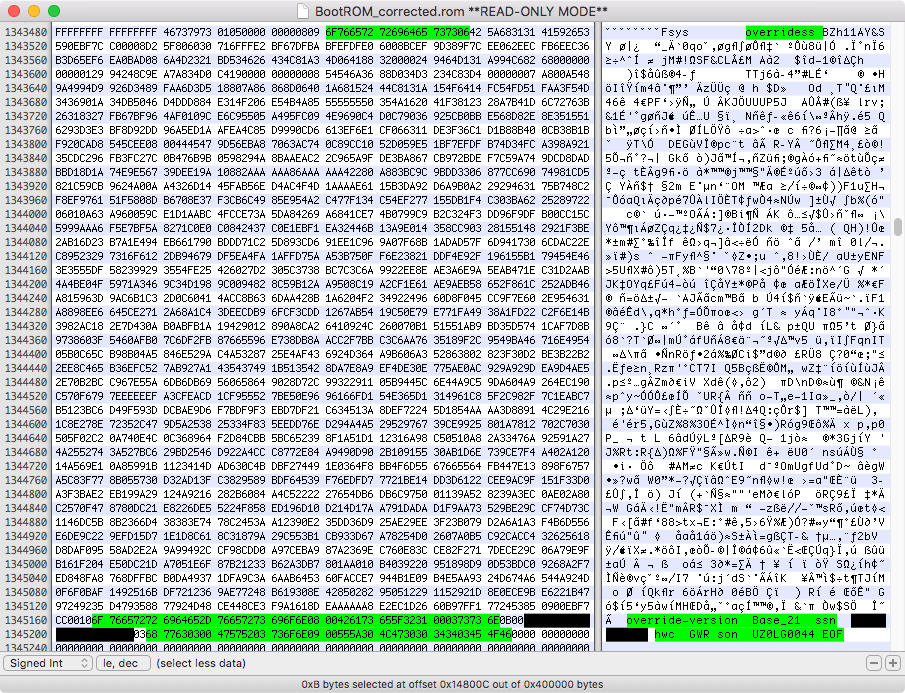

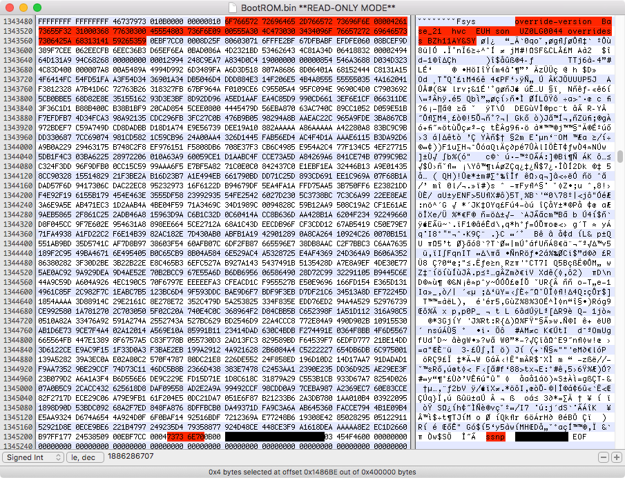

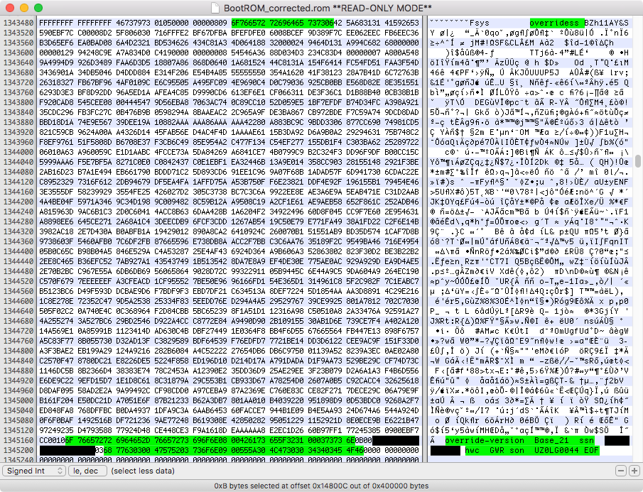

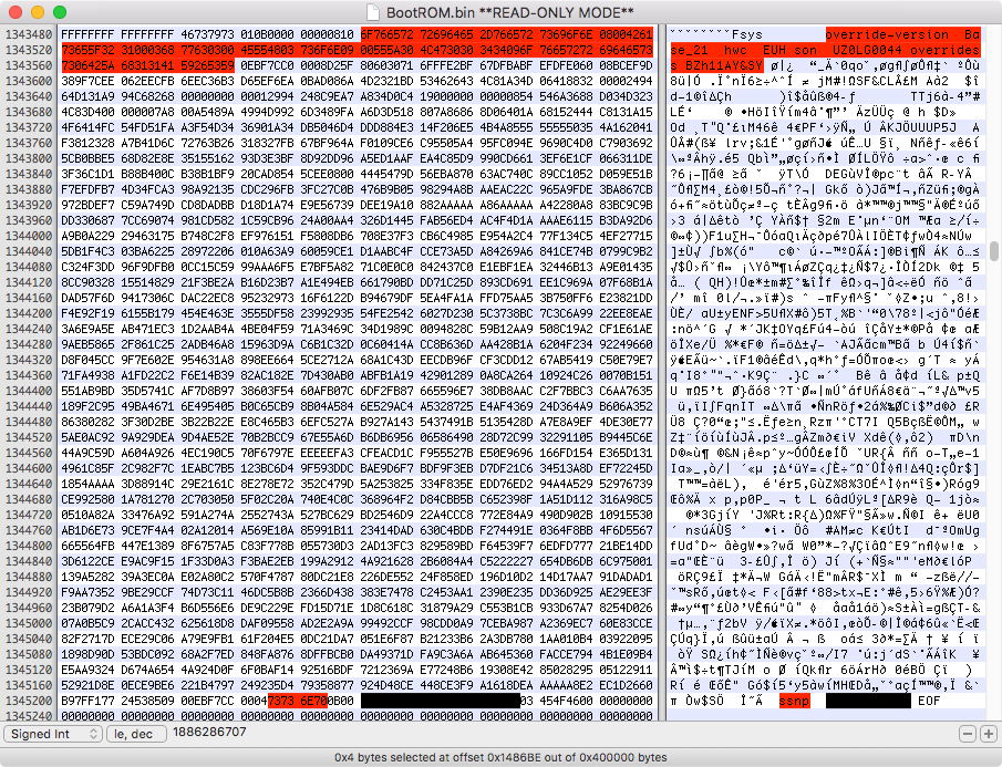

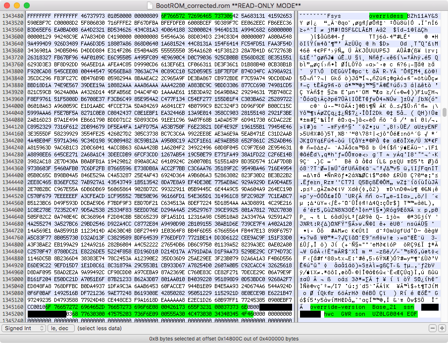

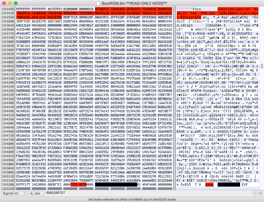

Take a look at this BootROM, look how messy the hardware IDs and descriptor are:
SSN as ssnp was the cherry.
After correction:
Correct order:
  1. overridess,
  2. compressed descriptor blob,
  3. override-version Base_XX,
  4. SSN,
  5. HWC,
  6. SON,
  7. EOF.
Note:
HWC changed between screen shots because the backplane was replaced with a used one. I changed the SSN, hidden on the screenshots, for the one from the case. Since HWC is the 3 or 4 last digits from the SSN, I changed the HWC too. Sometimes you have to change SON too, like when using a 2010 board with a 2012 SSN, or the reverse.
