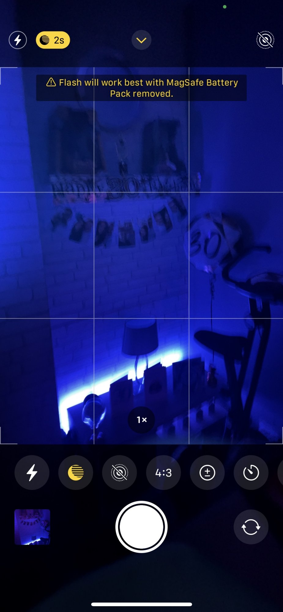

Anyone else noticed this message in the Camera app when the MagSafe Battery Pack is attached?
It’s probably because the flash will reflect off the pack, try it.
