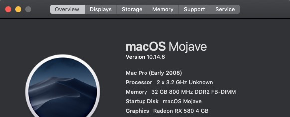

Update on the MP3,1 ...
Got it to boot from OC all the way to the desktop.
It just took a long time to do it (based on log about 110 seconds before it started loading OS)
Once it did boot, I did get my verbose boot as desired, just -zero- display from OC itself.
So that would mean that GOP works to some degree at least.
However I suppose it *may* be possible that it somehow chain-loaded into refind and booted my default OS in refind, rather than a direct boot via OC and that is why i was able to see verbose boot but nothing from OC's interface.
The reason I say it was a success booting is that it saw my dual X5482 as "Unknown" processors which normally is not what they say. Also, OpenCore only sees a single processor based on debug logs.
