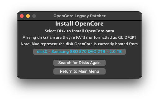

I'm trying to Install Windows 11 UEFI with OpenCore - and therefore trying to install Opencore on a separate 250mb partition as recommended here, but I don't get the option to install to an individual partition, only to the disk itself. Partition map is GUID and the Opencore partition I've created is FAT16, any ideas?
I would ask the opencore legacy patcher discord. This thread is for the diy opencore solution. You will get more help in the discord
Edit : I also agree with @hwojtek that OCLP may not see a FAT16 drive since FAT16 is not common on macOS and was probably not kept in mind when the OCLP devs were making their app
