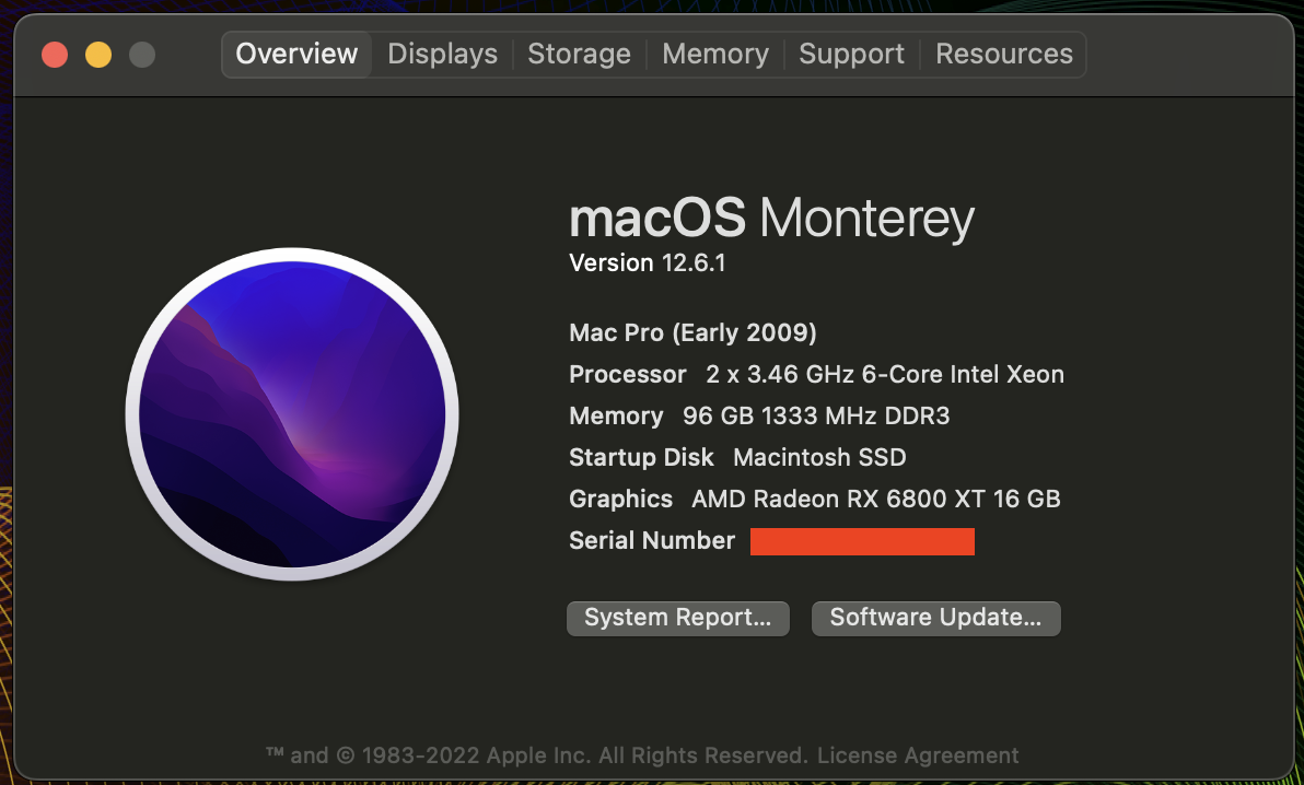

Voila!
I figured it out, but had to reinstall Monterey via recovery.
I had NOT "enabled" ASPP Override!
So the lesson learned here is -- ALWAYS make sure to thoroughly read through your config, especially when you are updating through OpenCore versions!
I didn't have time to keep up with the incremental updates since 0.8.0, so I had to jump from 0.8.0 up to 0.8.5, and while doing that, I missed that I had to enable ASPP Override (I had already added ASPP into my config when I upgraded to 0.8.0 from 0.7.9, but because it wasn't needed in Big Sur, I just kept it disabled, in anticipation for when I would eventually get to Monterey) I forgot about that, but as soon as I enabled it, everything was fine.
I did have to reinstall Monterey via booting into Recovery from within the OC boot menu, but now all is well!
Cheers!
...now to update my sig!
