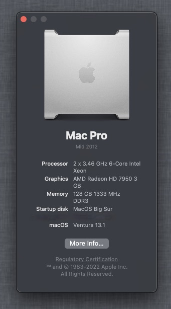

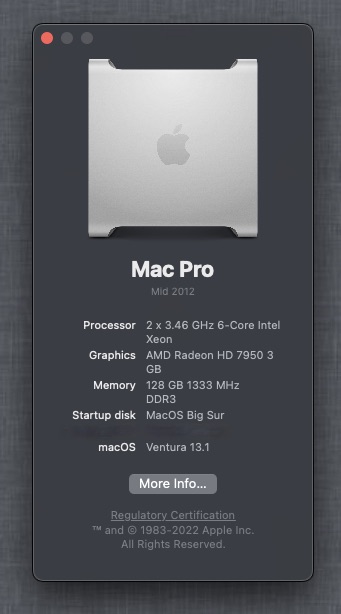

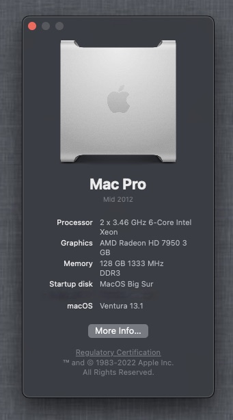

You might be surprised. Yesterday I saw this (not my computer):This is valid only for NVIDIA Kepler GPUs, where there is no requirement of AVX2.0, since it's Big Sur drivers hacked to work with Ventura. No DRM working and a long list of small issues:
Legacy Metal Graphics Support and macOS Ventura - Sequoia · Issue #1008 · dortania/OpenCore-Legacy-Patcher
With the forth coming release of OpenCore Legacy Patcher v0.5.0, systems with legacy Metal GPUs will finally be able to achieve graphics acceleration in macOS Ventura! Reminder: These patches are s...github.com
AMD HD 7950 is a legacy GCN1-3 card with Monterey drivers hacked to work with Ventura, that also doesn't require AVX2.0. Like NVIDIA Kepler, no DRM support and no H.264 acceleration, see the list of issues.
