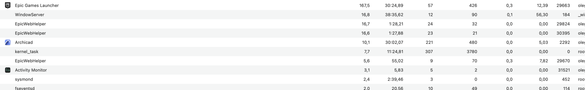

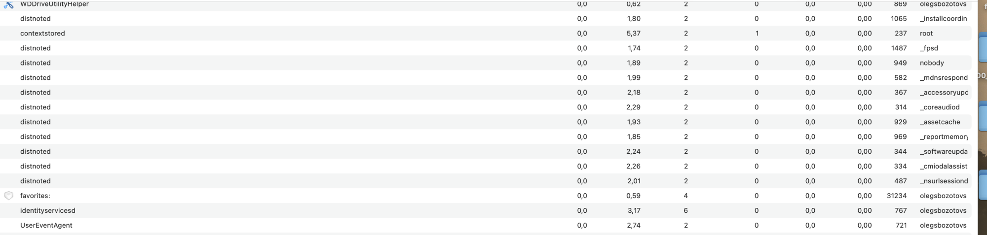

Can anyone tell me why there are duplicate processes?
this is normal?
I understand that shaders in UE5 are compiled by each processor, since I have 12, then 12 processes
but I only observed standard root processes when opencore was configured incorrectly (for example, an outdated 0.8.0 martin could produce artifacts)
but now I'm using the new 0.8.6 according to cdf instructions
I’m asking this because I tested a new oclp a week ago, I didn’t notice a difference in performance, but when I returned to opencore, after turning off the computer for the night, in the morning I had a 40% kernel task
which was deleted only by reset smc and reset nvram
but every morning the process arose again
I deleted it this weekend by reinstalling macos

I don't like how my wireless magic mouse has been working for the last week (since 0.8.6)

I asked a question:
1. Is it correct that processes are cloned?
2. and for the first time in 2 years of using a wireless mouse, I am experiencing a problem
