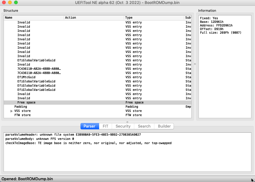

So, all you did is just install that OC beta package (completely replace both BOOT and EFI folder). Then got into a boot loop when you try to boot Big Sur (but you can boot to recovery)?
Yes. I think I might have found the issue. I'm not entirely sure what to do to fix this safely so maybe @tsialex could jump in?

tsialex
Contributor
Jun 13, 2016
13,455
13,601
Did you tried a multiple/continuous NVRAM VSS store reset? Dump the BootROM image after you do it and check again.
Connect a wired keyboard that works for NVRAM resets and press/keep pressed CMD-Option-P-R until you hear the fifth chime (you just need three sequential resets to trigger the deep reset, but it's not easy to do it for the first time).
If you have a cross-flashed early-2009, won't solve the real underlying problems with the NVRAM volume, the MP4,1 NVRAM volume is slightly different from the MP5,1 one and you'll need a BootROM reconstruction service.

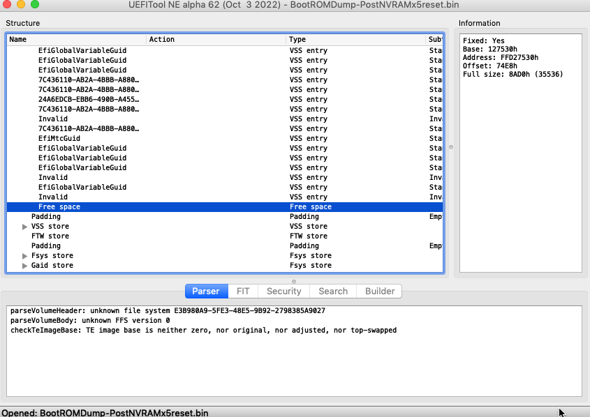

macoda
macrumors newbie
Jan 11, 2020
15
6
Yep, did that almost immediately after my last post as I've zero patience 😆
Looks a lot healthier now...
