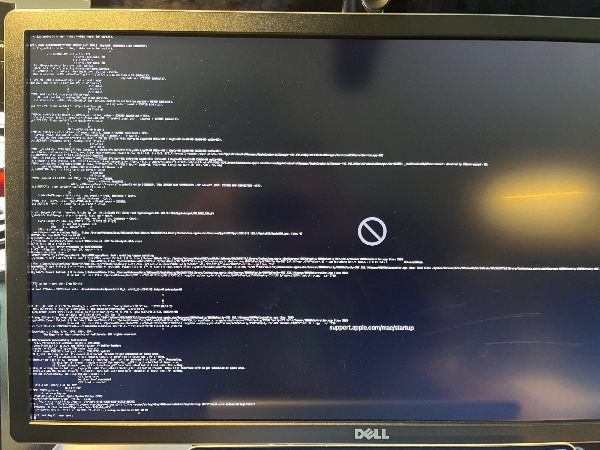

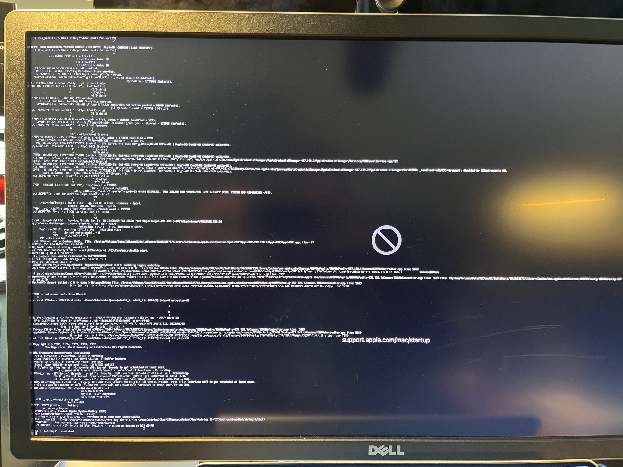

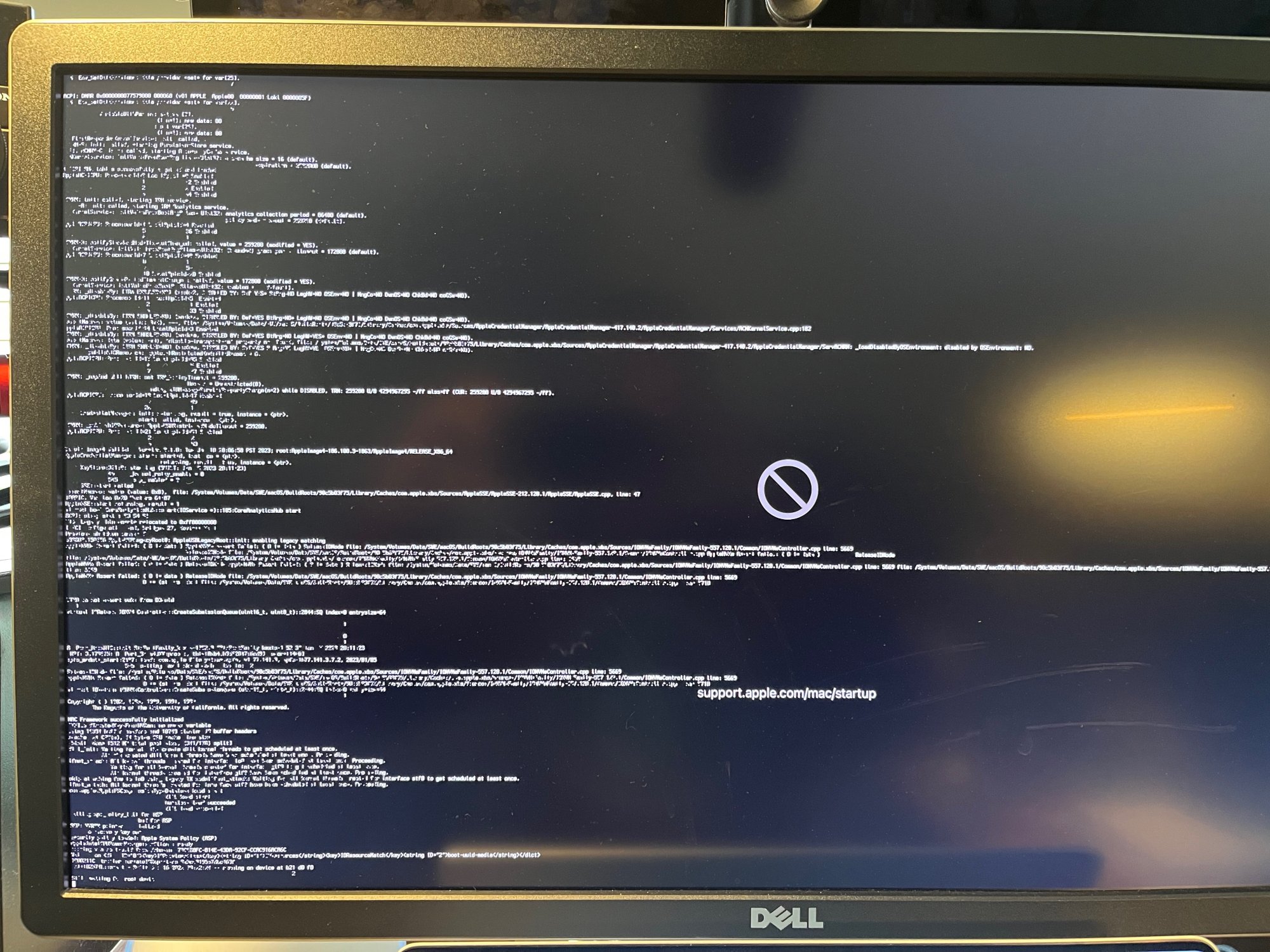

Interesting... I have 2 Mac OS versions currently installed in my cMP. Mojave is on an SSD using one of the PCI slots with an OWC card. I bought another SSD and adapter and installed it in the first SATA spot and installed Monterey. I was booting opencore off a USB but migrated it on to the SATA SSD with Monterey installed as everything appeared to be working. Currently using Martin Lo's package of OC 0.8.8 as I couldn't figure out which parts to take out/leave in the config to boot both Mojave and Monterey. When I cold boot everything works, but I tried a couple other situations:
Cold Boot Mojave -> Restart into Mojave = Monterey SSD missing from desktop (no incompatible disk alerts)
Cold Boot Mojave -> Restart into Monterey = prohibitory sign (as has been happening in all previous warm boots)
Cold Boot Mojave -> Restart into Mojave = again Monterey SSD not showing (no incompatible disk alerts)
The warm boot seems to make the internal SATA SSD disappear, however OC is present and using the version command in terminal from your first post it shows 88 installed. disk utility does not see the drive or terminal using the list command.
That sounds more like a hardware issue to me :(

Mean anything to you all? :)
Did you make sure to add AppleMCEReporterDisabler?
Yup, that's there and seems to be in the config just fine.
Weirdly, I can install Monterey with no issues, but trying to install Big Sur 11.7.3 gets me all sorts of nonsense. I made a new installer USB and it gets a good chunk of the way through the process, then after a reboot back into the installer it gives me this:
Same OC 0.8.8 and config allows installation of Monterey 12.6.3 to the same drive with no trouble.
I know I'm chasing two problems here - the black screen and reboot thing in Monterey is the one that's actually important. If that worked I'd not be bothered about Big Sur, it's just a test to see if it bombs in the same way at any point.
Hmm. I haven't touched Big Sur in a while. If SurPlus is still needed, then the kernel version settings might need an adjustment. As for the Monterey issue: would you mind posting your config just in case?
Ahh, SurPlus! I'll bet that's missing from my config - yes, it is. I'll add it and give Big Sur another test.
Don't mind at all, appreciate the help. Attached is my config as-is and working for Monterey, but with the weird black screen-reboot issue happening. It's basically vanilla except for the PowerPlay table for the Radeon VII and the catch-all internal drives patch. I've removed both of those with no change in behaviour.
EDIT: So strange, Big Sur installer now won't boot with those "AppleNVMe Assert failed" errors again. Typo in the config file. Always use plutil, kids! :D
  • config.plist.zip
Not really seeing anything obvious here. Perhaps try disabling FeatureUnlock and AVXpel...
Thanks, I'll give that a go later on, see how Monterey behaves.
Big Sur installed fine in the end with the addition of SurPlus... but the completed installation will not boot. In verbose mode I can see it loads fine up to a point, then the text output becomes scrambled, then it begins boot-looping.
