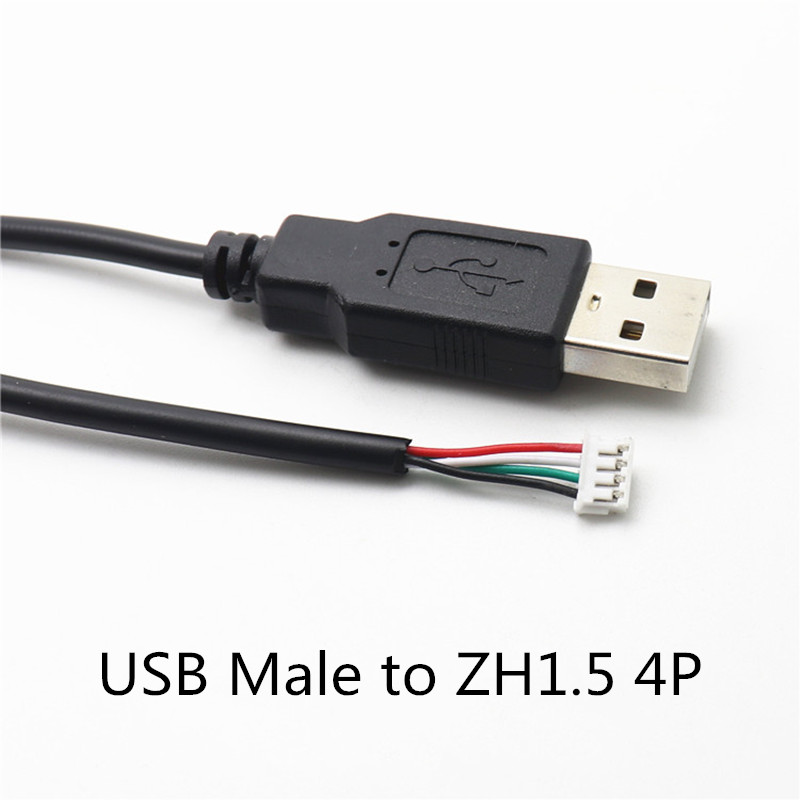

Works fine, I did it for two Macs at work, you just have to buy a USB-A male to Dupont-9 male cable. Something like this one below, but measure the length correctly and buy the correct length for the way you configured your Mac Pro.
Connect the Fenvi T919 original USB cable to the Dupont-9 male connector, connect the USB-A to the USB v2.0/3.0 hub, the USB hub to the Mac Pro native USB ports. Seems complicated at first, but it's very simple/cheap and solves the OHCI issue definitively.
Btw, I've bought this cable below to direct connect the Fenvi T919 to the USB hub, I'm waiting it to arrive to confirm that is the cable with the right connector/pinout for the Fenvi card:

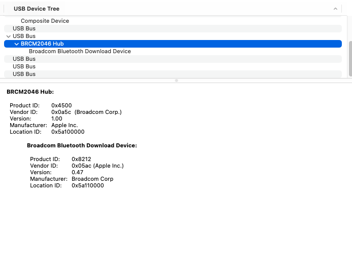

Another issue: I’ve got Bluetooth working but it requires me to plug the Fenvi into the USB hub every time I restart the mac pro.

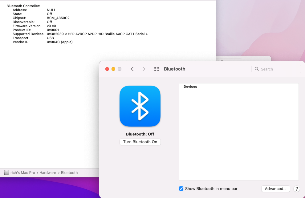

have just tested my d-link dbt-120 which was flashed for powermac which tested earlier, did function on Monterey, albeit only usb1.1.
some time since then, now would not be able to activate the USB dongle any longer on Monterey, but it seems to be "connected" on the front-bus of the macpro4.1/5.1 and also somehow recognized.
according to Bluetooth Explorer, there are no Bluetooth Devices, so something is wrong here.
(have two devices connected, one internal Bluetooth Broadcom card by apple, and the USB 1.1 DBT-120 , which also seems no longer recognized).
Bluetooth Explorer doesn't work anymore in Monterey. It was removed from the newer Xcode additional tool package.
