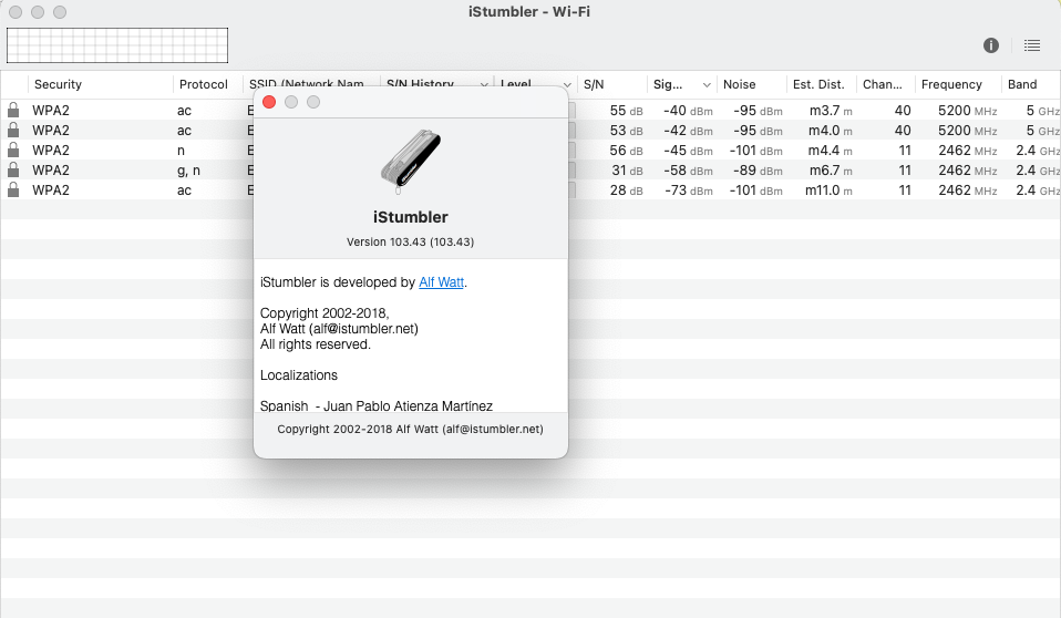

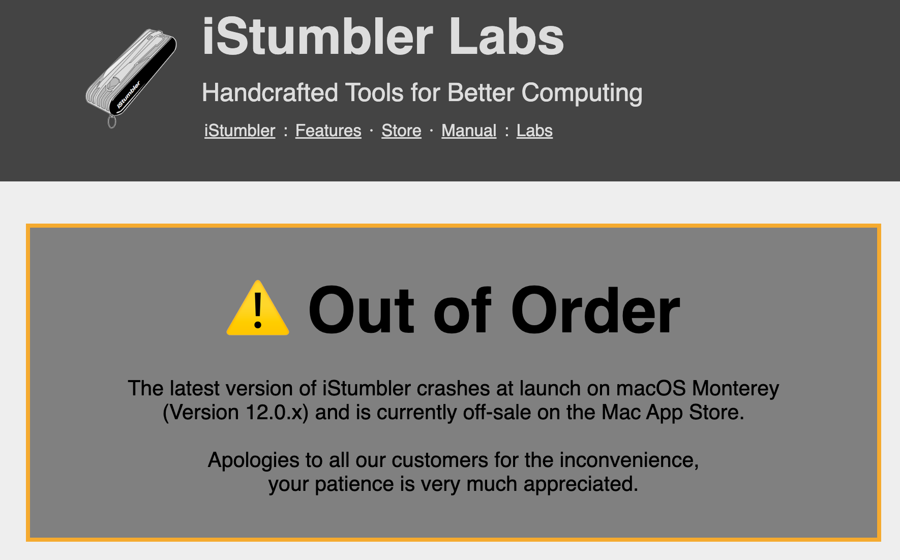

Hi, I am brand new to Mac Pro's, bought a 4,1 flashed it to 5,1 upgraded the CPU to x5680, initially had problem with SSD due to el cheapo amazon special would not initialise, switched to Samsung and all good, but I wasted two days trying to install 13.2.1, it would go through installation process and then go to some error mode, change the installation target disk name to orinalname-Data and would add another -Data after each manual reboot... I decided to try with 13.1 and it went through the first time, is it a known problem with 13.2.1 or is it me doing something wrong?
There are several working alternatives, such as iStumbler.
thanks, will look for those if needed again.

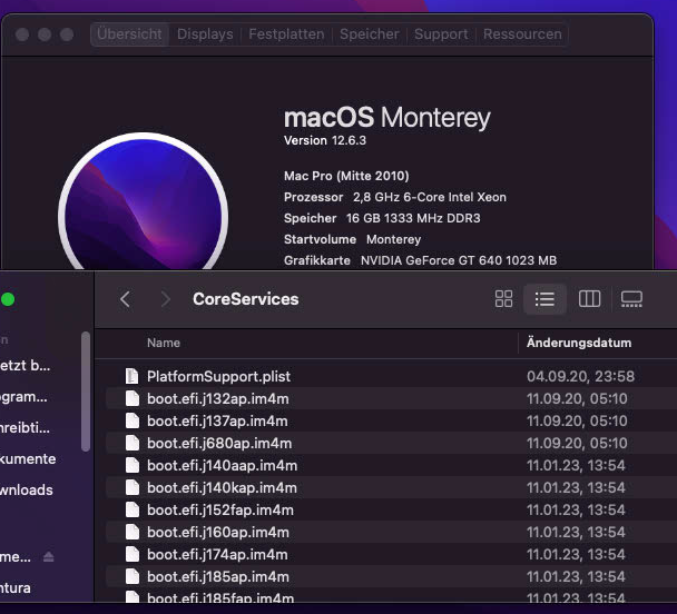

observed a mad behaviour of High Sierra:
it has overwritten SystemVersion.plist and PlatformSupport.plist in both my /Preboot volumes in Ventura and Monterey (being in the same container of another drive)
(Noticed it by icons of Ventura and Monterey changed to High Sierra icons in OpenCore BootPicker)
Due to replacing PlatformSupport.plist odd things can happen.
the cure is easy:
Code:
sudo cp -p /System/Library/CoreServices/PlatformSupport.plist /System/Volumes/Preboot/_the_id_here_/System/Library/CoreServices
sudo cp -p /System/Library/CoreServices/SystemVersion.plist  /System/Volumes/Preboot/_the_id_here_/System/Library/CoreServices
see both of my SystemVersion.plist of Ventura and Monterey changed magically to High Sierra:
Code:
cat /Volumes/Ventura/System/Volumes/Preboot/*/System/Library/CoreServices/SystemVersion.plist
<?xml version="1.0" encoding="UTF-8"?>
<!DOCTYPE plist PUBLIC "-//Apple//DTD PLIST 1.0//EN" "http://www.apple.com/DTDs/PropertyList-1.0.dtd">
<plist version="1.0">
<dict>
    <key>ProductBuildVersion</key>
    <string>17G14033</string>
    <key>ProductCopyright</key>
    <string>1983-2020 Apple Inc.</string>
    <key>ProductName</key>
    <string>Mac OS X</string>
    <key>ProductUserVisibleVersion</key>
    <string>10.13.6</string>
    <key>ProductVersion</key>
</dict>
</plist>
<dict>
</dict>
</plist>
High Sierra PlatformSupport.plist in Monterey /Preboot - see the old date.
Edit: Did reverse test to double check. After booting High Sierra once natively it wrote its PlatformSupport.plist and SystemVersion.plist into Monterey /Preboot, also it changed .contentDetails back to "Monterey - Data".
Edit2: There is a dedicated thread about the issue and the tool:
Thread 'High Sierra booting possibly corrupts newer Systems. Fix, description and a boot picker renamer'
