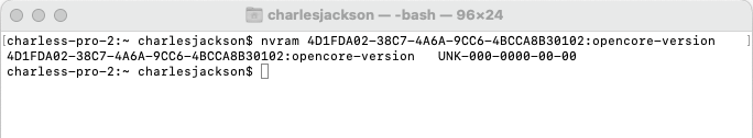

Sweating bullets there for a few minutes. Had a non-bootable Monterey. I worked through it, and it's back AFAIK.
I'll double check a few things tomorrow (or later tonight if the caffein catches up). I guess I needed to go through this to learn how it works.
Any idea why the version number isn't known?
