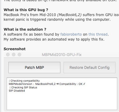

MBPMid2010_GPUFix is an utility program that allows to fix MacBook Pro (15-inch, Mid 2010) intermittent black screen or loss of video. The algorithm is based on a solution provided by user fabioroberto on MacRumors forums.
The utility is based on Qt Framework and only available on OSX.

Screenshot

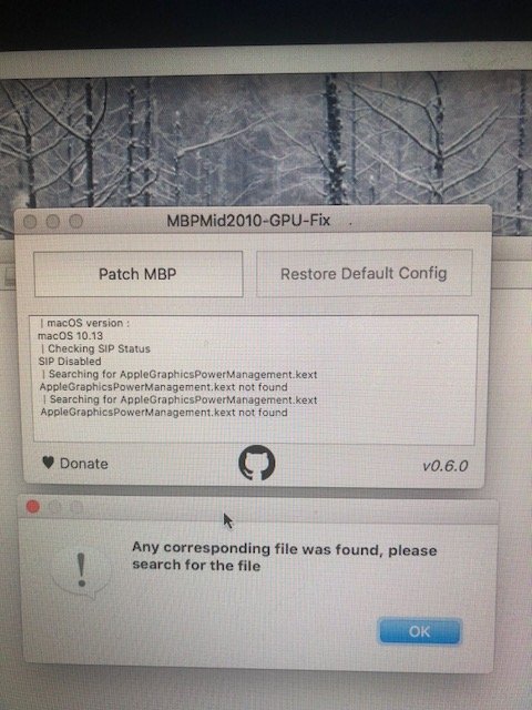

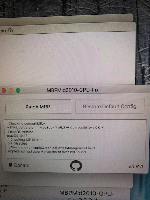

I've downloaded the GPU fix in the past and it worked very well until recently after the most recent OSX update. I downloaded the latest patch (Version 6.0) but received the following message:
"AppleGraphicsPowerManagement.kext not found" As a result, the GPU kernel panic persist on my MBP. Can you suggest a solution, please?
Thank you!
[doublepost=1527004071][/doublepost]Hi Julian,
Thank you!View attachment 762547 View attachment 762548
