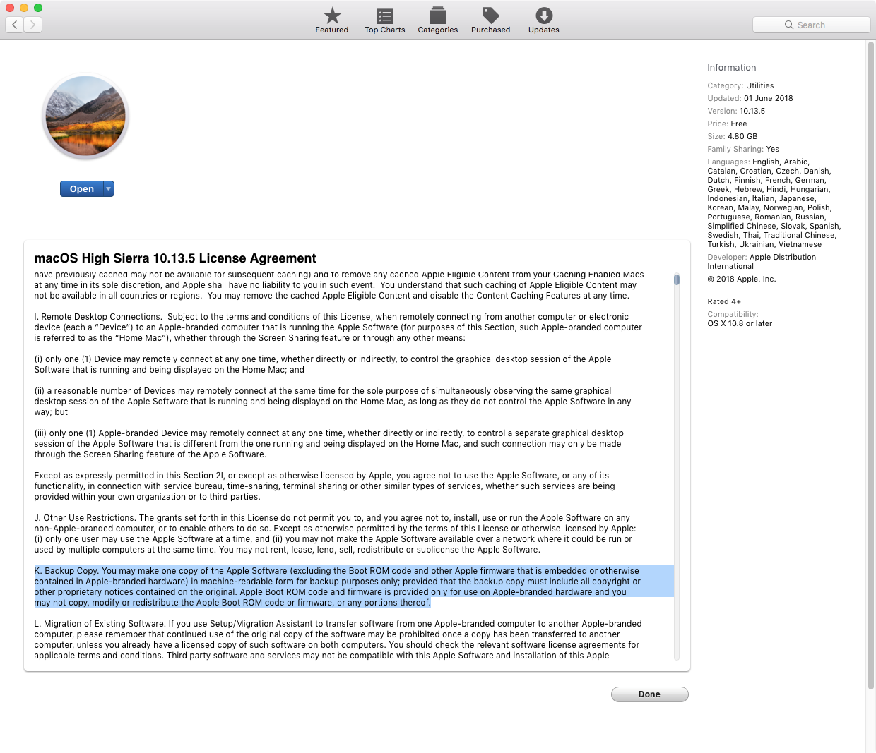

actually i had a quick look they actually do say in the EULA that you cant do anything with the machines BootROM. not even back it up...
thats pretty mean... also wouldn't a Firmware update (even an apple one) count as modifying the BootROM code? (or pretty much everyone on this forum who has flashed 4,1s to 5,1s and 1,1s to 2,1s...)
I wonder how this would hold up in court, but I doubt apple is going to come bust ass over some people modifying their own personal machines, im pretty sure the Apple Dev Betas tell you that your not even allowed to talk about them and yet we have an entire Mojave sub forum on MR...
I dont think any personal Hackintoshers have been busted for hackintoshing and thats a massive violation of the EULA LOL
ugh... im not a lawyer LOL
edit: TL;DR: Yes doing ANYTHING with the BootROM technically violates the OS X EULA but I would not worry about it...

Interesting that they only allow you to make 1 backup. Experts have always suggested you have more than 1 backup of your data.
the biggest lie on the internet:
"Yes I have read the terms and conditions" :D
