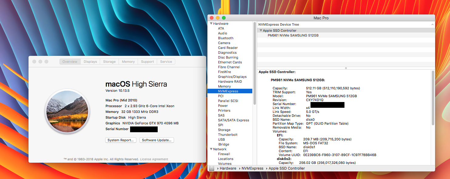

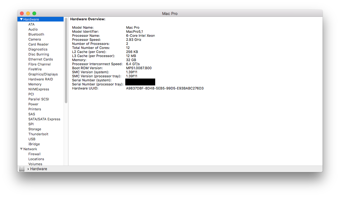

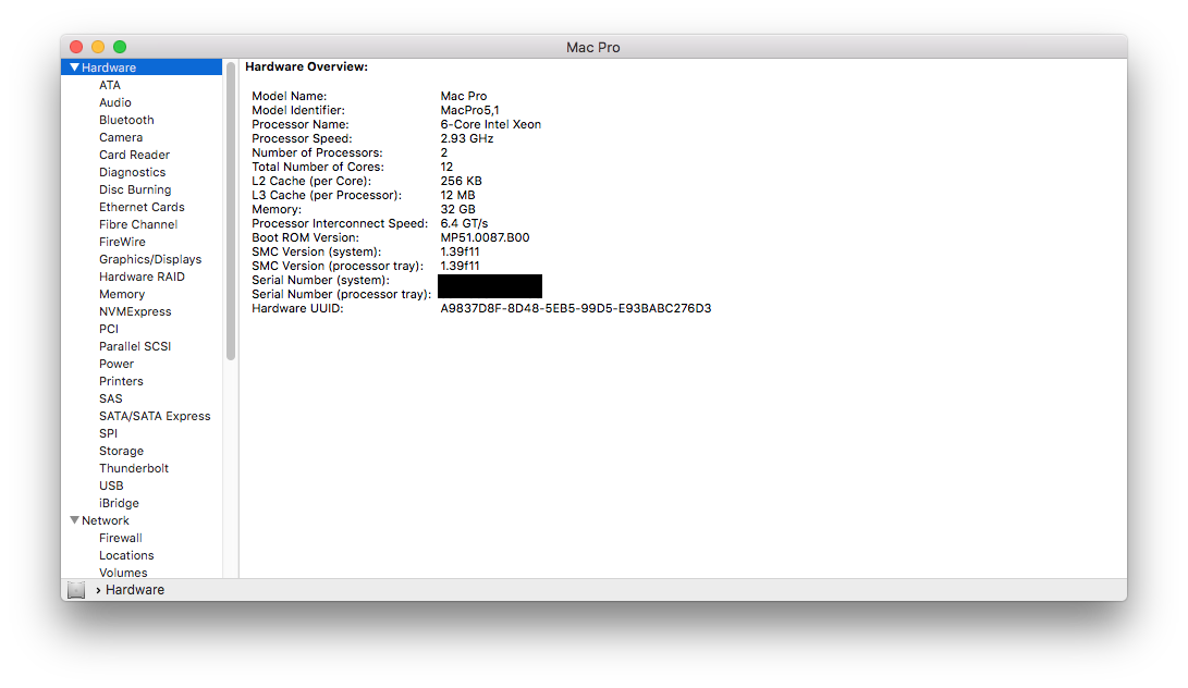

I completed the NVMe firmware mod guide from the Google doc on page 14 with success. I was able to boot my Samsung PM961 SSD from my Dell XPS with High Sierra installed on it. I'm using firmware MP51.0087.B00 which has the 0 microcode issue on it.

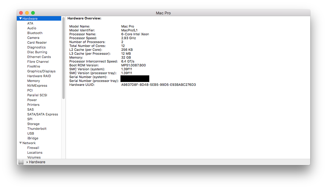

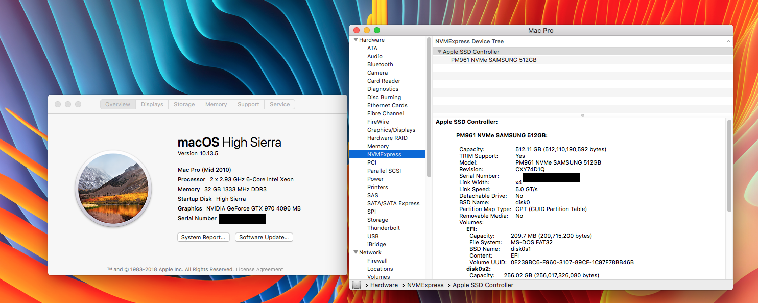

View attachment 765524View attachment 765525

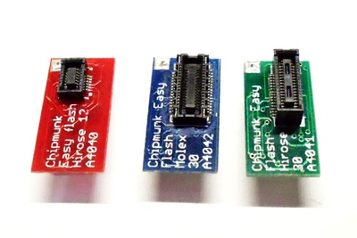

The cMP logic board has an undocumented 30-pin Molex connector, by the LITTLE FRANK label, that allows a user to plug in an EFI firmware replacement that is active until removed.
An example product is the $90ish Chipmunk Easy Flash, model A4042, that's equipped with a flash ram chip that's easily be flashed with a mac pro efi rom.
A working rom can be flashed to one of these, and plugged into your cMP.
