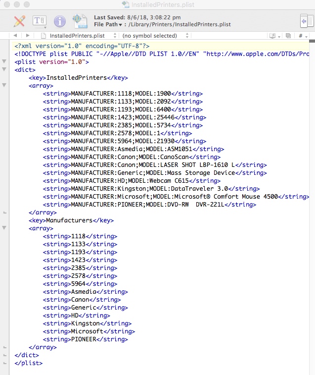

I have an English school here in Japan and 100% depend on my Canon LBP-1610 A3 format B/W laser printer ( A3 laser printers are still very expensive ! ).
I bought this laser printer in 2002 ( Yes ! it's now 16 years old ! ).
I've kept all the OS X Canon drivers since OS 9 and just one of them allows installation right up to High Sierra 10.13.5 ..
this also involved hacking the "Sandbox" though Terminal.
I've had it working flawlessly right up to 10.13.4 on a 2.5" SSD but. . after going up to 10.13.5 it would not print.
This virtually ruled out doing the NVMe EFI boot upgrade for me but today I had an inspiration .. .
I noticed that in comparing Library/Printer/InstalledPrinters.plist .. that the Canon LBP-1610 IS LISTED in my Siierra 10.12.6 installation on another SSD BUT NOT in the 10.13.5 "Library/Printer/InstalledPrinters.plist".
So. . I copied the plist entry in Sierra to the plist in 10.13.5 .. .
It worked ! .. and should be good for 10.13.6
I'm over the moon about this, it gives me confidence to go ahead with the NVMe BOOTING HACK.
If, after testing that all of my essential daily use apps work in 10.13.5 I'll go ahead with the NVME EFI boot upgrade.
You can see that the entry " <string>MANUFACTURER:Canon;MODEL:LASER SHOT LBP-1610 L</string>" is the one I copied from Sierra 10.12.6
